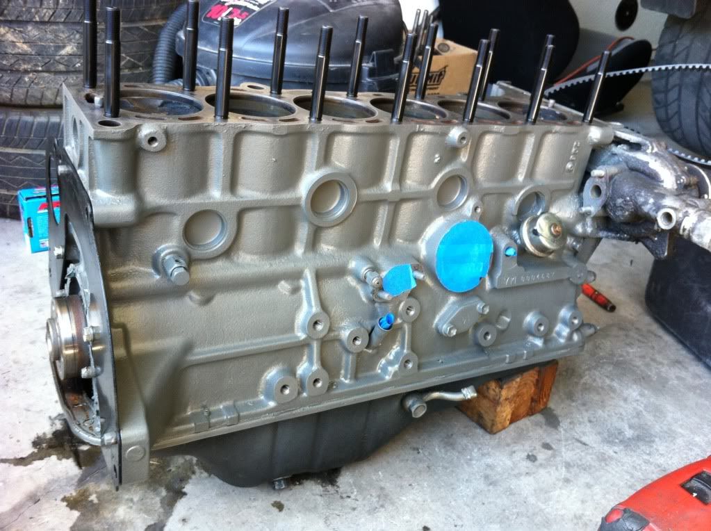

Stock block all cleaned up, painted, arp installed, lower gasket set ordered.

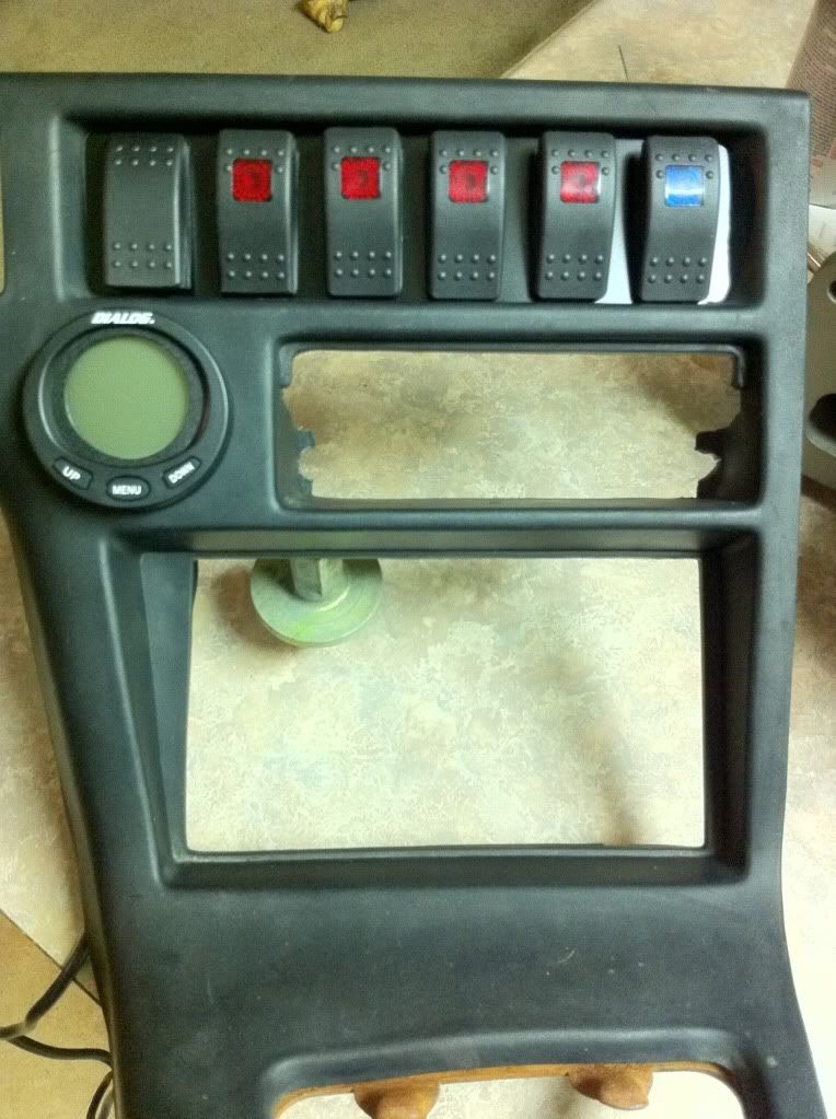

Switch plate mounted and made out of lexan

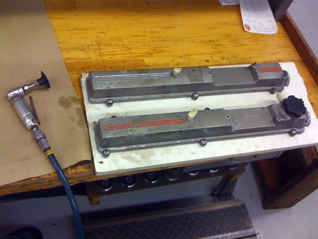

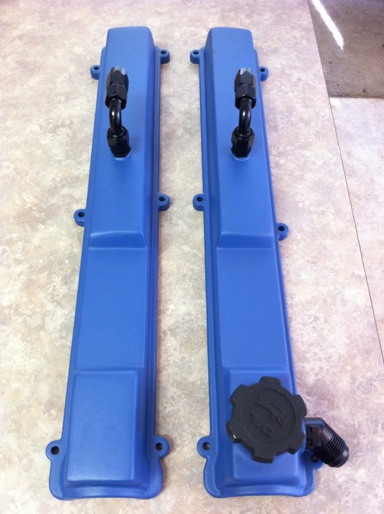

Lots of time, welding and blending put into these. All screw holes filled, blended flush, 3000 pipe mounting welded up, tapped for AN fittings
Straigh from powder
Before
