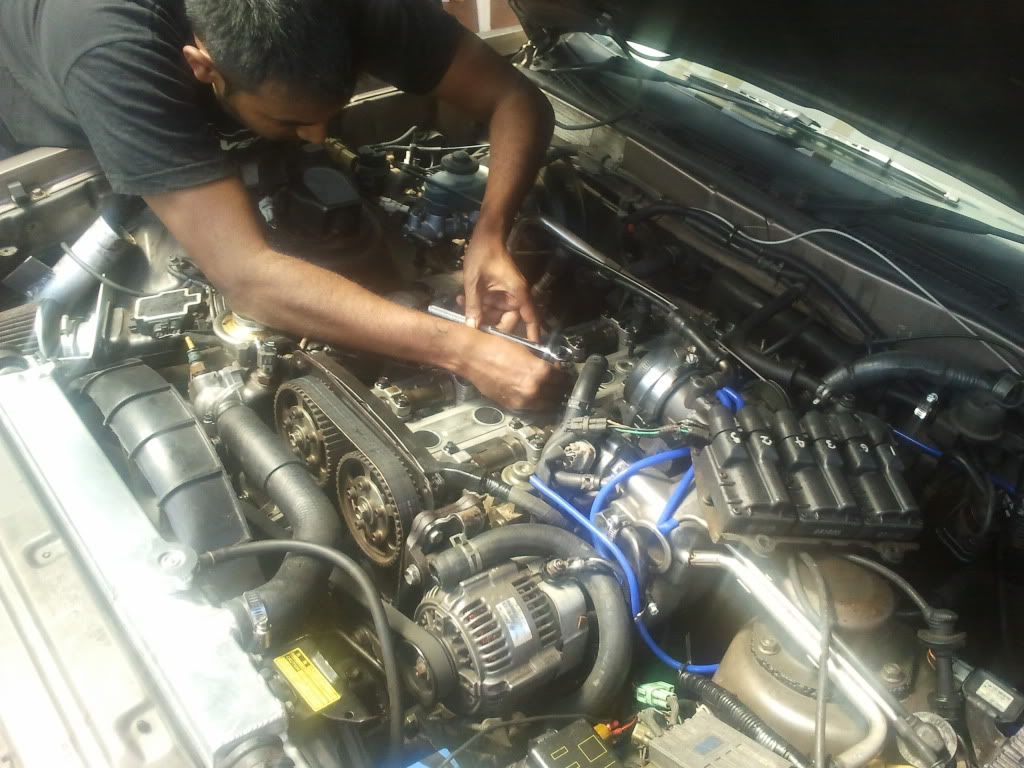

And on your extensive list of mods and upgrades, I didn't see anything about your cooling system.
I have to ask- What type of radiator and cap are you using? Seeing as you have thousands of dollars in engine management, and upgraded internal parts, I assume you're on an upgraded rad?
Yes I have an upgraded radiator , not sure of brand and type , but it definetly does the job. I have upgraded internal parts but certainly dont have thousands of dollars in engine management ( one day... :) . Radiator cap is the one that came with the radiator. I can check the brand for you today and get back to you but its not a crappy chinese ebay one , I paid good money for it and the guy who bought and installed it for me only buys the best of the best and never settles for anything less.

A few things...
That looks like a PWR radiator, and yes, they are quite good. Best on the market, IMHO. Even so, as JJ pointed out, there are several other factors that can cause overheating.
I've seen quite a few electric setups by now, and I've never seen one that moves as much air as the stock clutch fan without making at least as much noise. I've also never seen one that moves as much air without taking up at least as much room. I've heard LOTS of guys claim they have the electric fan that bends the rules, probably using pixie dust or unicorn hide, however, it seems all these guys live in areas with colder ambient temps, or don't drive in traffic, or have the fan installed on their storage shelf because their car doesn't run, and hasn't for years.
You want to buy a LOWER temperature thermostat, not higher.
Leaves collect *behind* the AC condenser, blocking airflow to the radiator, not in front of it. To check, pull the radiator back and look down to see if there is gunk in front of it.
The stock secondary e-fan in front of the radiator was only fitted to early model Mk3s.
The 10 blade fan isn't limited to GTE engines, it was also fitted to all cars in 'hot climates'. It was years before I saw one of the 'cool climate' fans.
