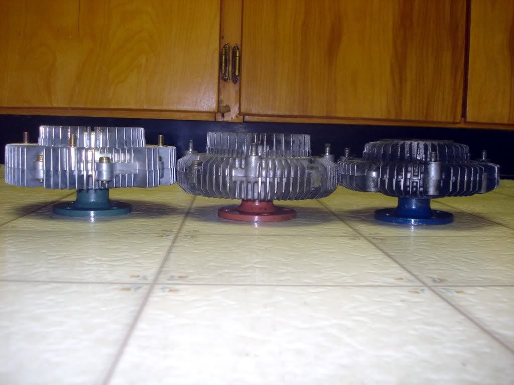

deabionni;1660245 said:Green IS the Tundra clutch. I have one sitting on a shelf in my garage. With the Tundra clutch, the fan sits just a hair closer to the radiator; but there's no clearance issues when using one on the Supra.
Here's a pic of the Tundra, GTE, and GE fan clutches sitting side by side.
You can see just how much closer each clutch puts the fan to the radiator.
IJ.;1660181 said:NA Clutch is Blue NOT Green
That's very odd, this is the clutch off of my 86.5 NA, which appeared to be original when removed. Appears to have a green hub.deabionni;1660245 said:Green IS the Tundra clutch. I have one sitting on a shelf in my garage. With the Tundra clutch, the fan sits just a hair closer to the radiator; but there's no clearance issues when using one on the Supra.
CyFi6;1660323 said:That's very odd, this is the clutch off of my 86.5 NA, which appeared to be original when removed. Appears to have a green hub.
IJ.;1660324 said:These cars are so old that unless you've had it from new it could have been changed anytime....
Every single NA I've ever seen had the Blue Clutch.
