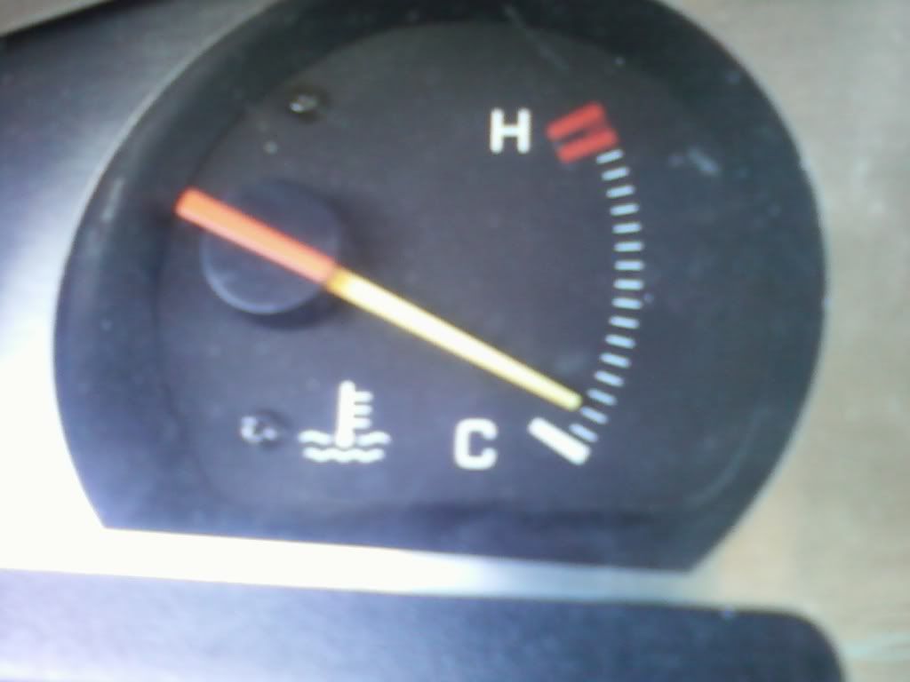

Ok heres a pic of the temperature gauge. It doesn't ever go past that. Unless like i said i lose coolant.
