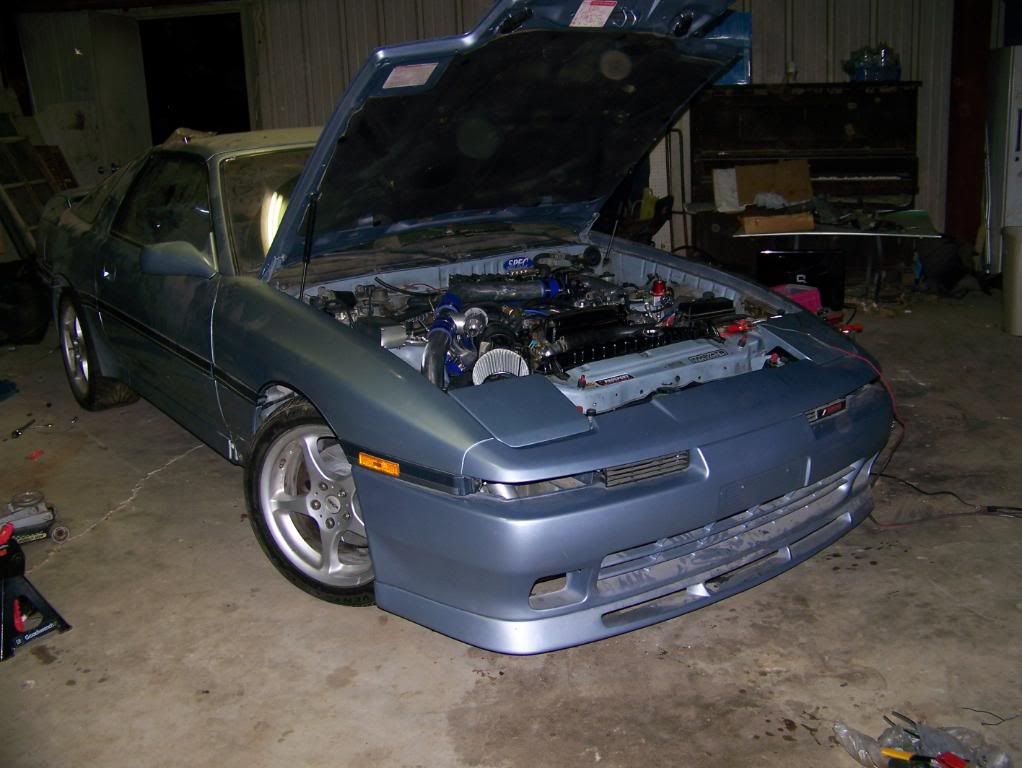

thanks man, hopefully not too long after x-mas she'll be running! Everything is fine man, the dp is a bit ugly lol, but i had it welded and my wideband bung and vband put on it and its all good i'm gonna header wrap it, the intake manifold was ugly as sin too lol, but i put some vht quick strip on it and its gettin powdercoated super chrome after christmas, thanks for everthing, keep the replys coming guys! Positive or negative, just lmk u are showing my car some attention, she needs it, poor girl. :nono:

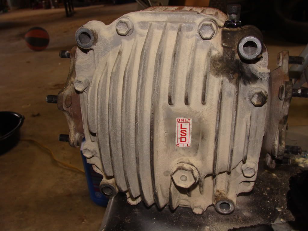

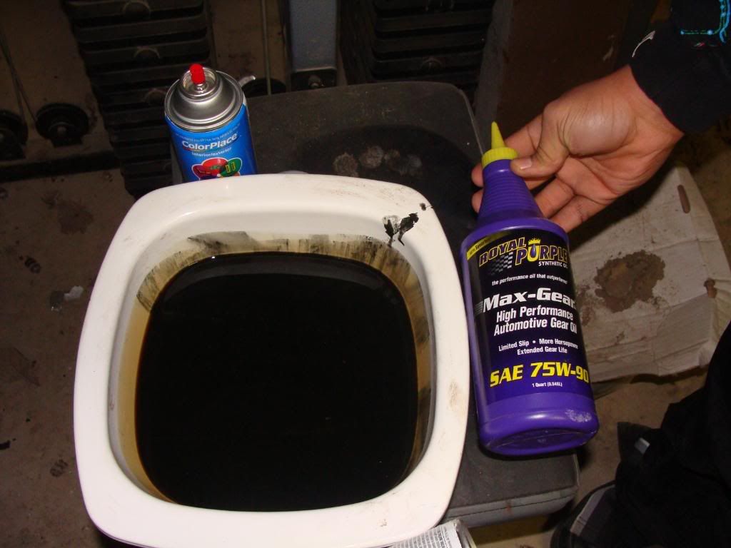

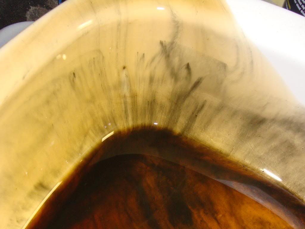

got her on the ground this weekend, changed the lsd fluid too....i don't think it was ever changed in her lifetime, when i had the wheels in the air, i spun one, and the other followed suit instead of spinning the opposite way, so i think it might be shot
here are the leftovers in the drain pan

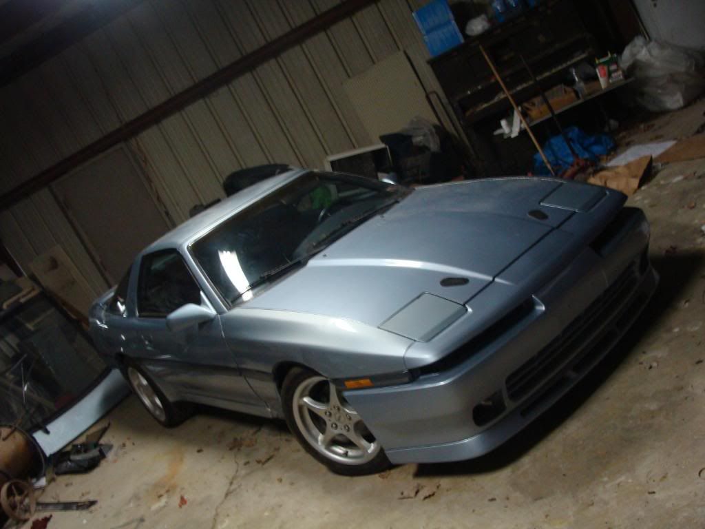

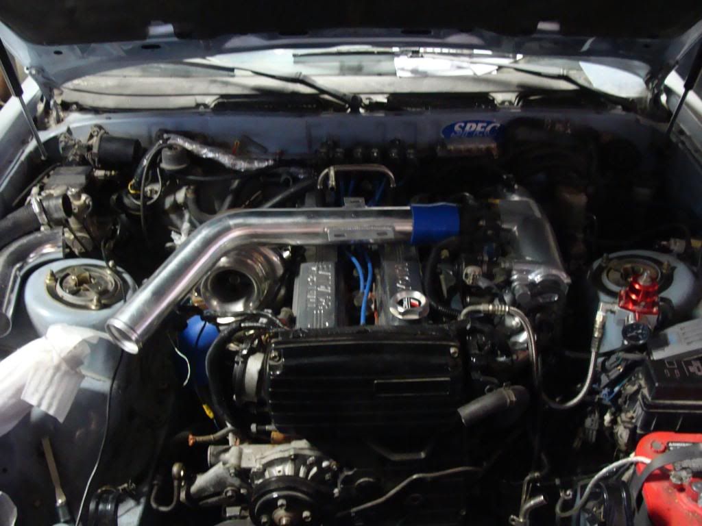

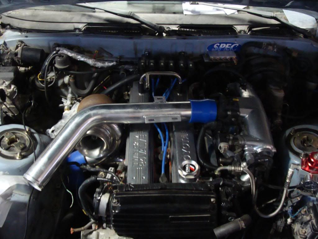

gettin closer guys........ :evil2:
my ic pipe hits my compressor housing though.....:3d_frown::3d_frown:
put in a 4.30 lsd rear yesterday too, :icon_bigg

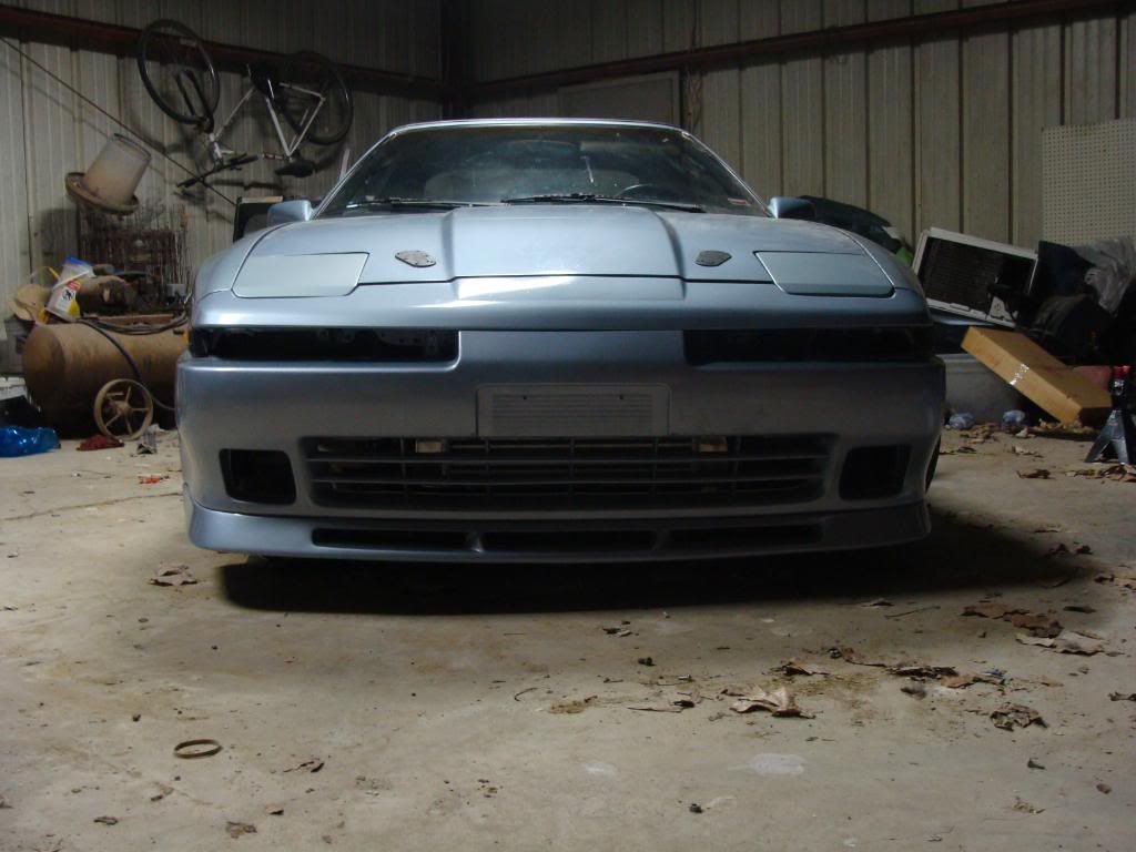

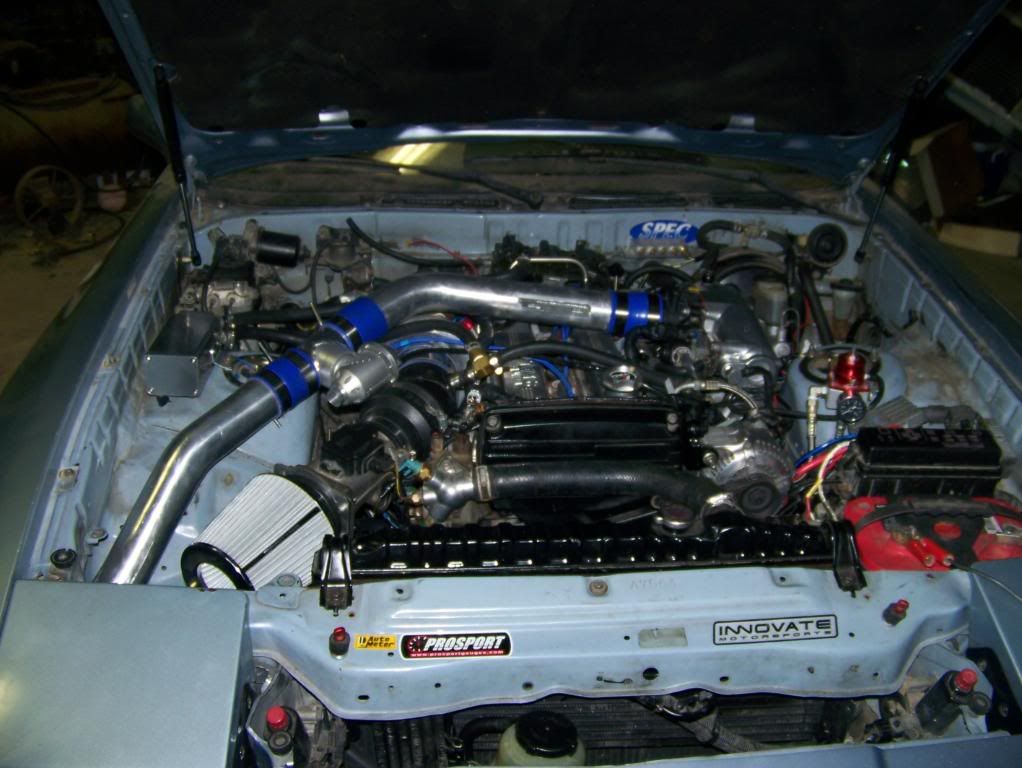

updated pics to come soon! IC pipes are all the way on, catch can is mounted, relocated N/A ps reservoir to in front of the core support, need to figure out why my fuel pump isn't kicking on with the key (i did the 12 volt mod), get a coil pack harness, prime, fill with gas and drive :)

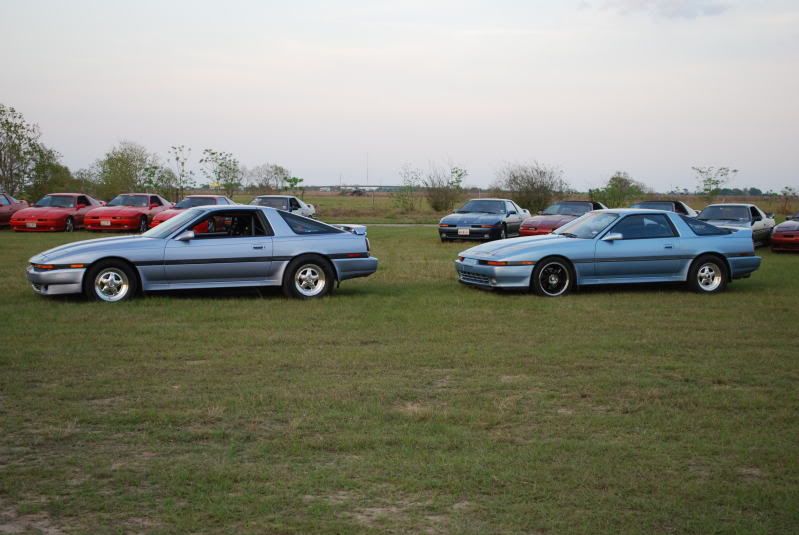

Nice build! Nice color, kinda partial to it myself! You're gunning for 11's with your car, me too(best so far is 12.6 with a BHG). I'll have a rebuild thread next week.
Shawn's car is very nice! I've seen it in Person!
Here's a pic of my car and Shawn's at TX2K9

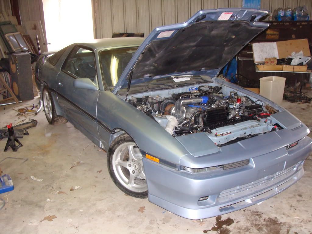

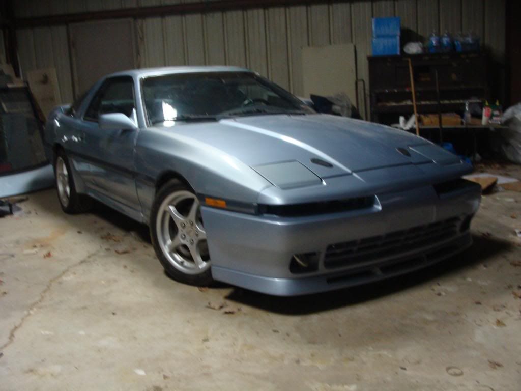

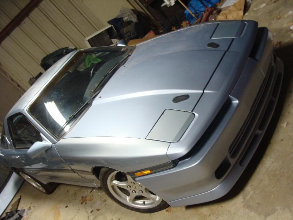

well guys...tomorrow is the big day, fill up with gas, let the battery finish charging, prime, and start :) we'll see how it goes... i got one snag, but i'll post pics first :) I'll put on the finishing shine when its all running and dialed in, but the pics don't do her justice guys...i'm sooooo stoked :D:aigo:

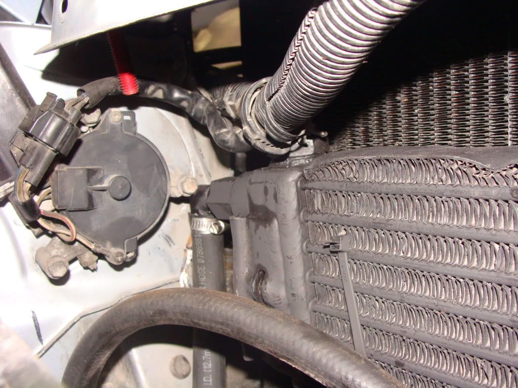

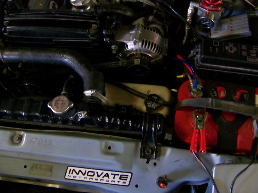

and where is the coolant reservoir you ask?
:evil2::evil2:
still gotta get my damned turn signals back.... ugh.

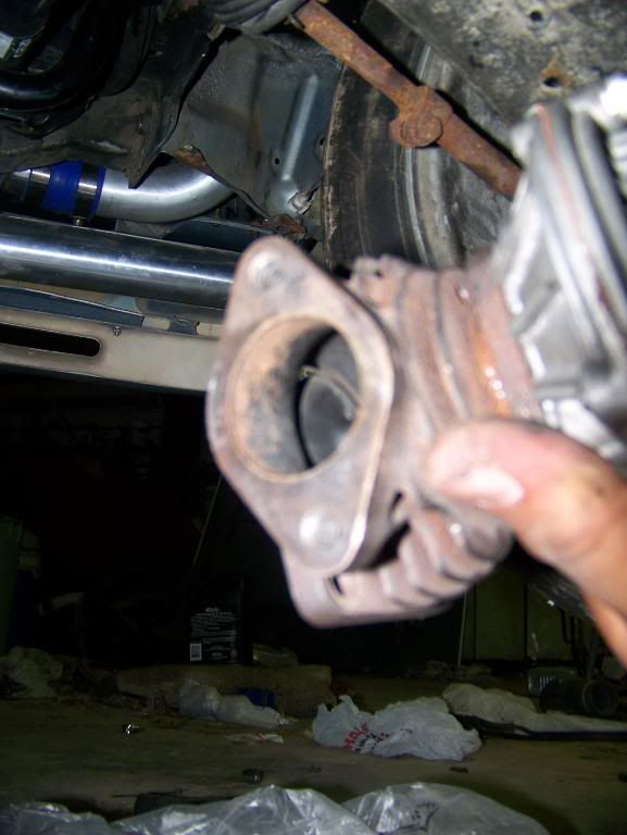

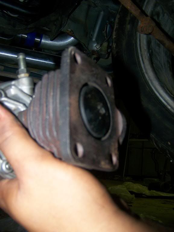

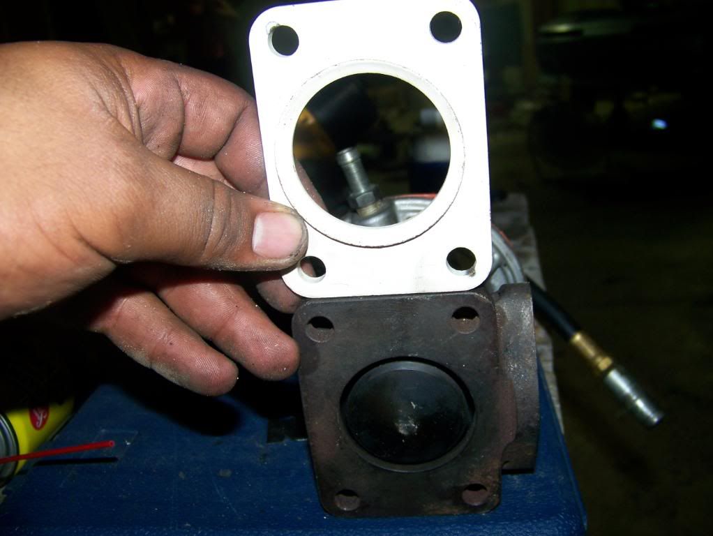

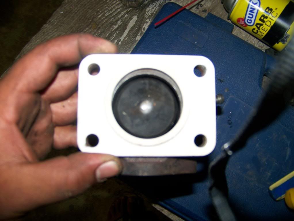

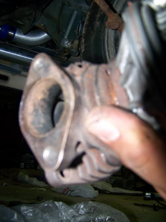

now for the problem....i got an authentic hks wastegate 40mm i believe
It came with no seal plate...hardy har har ebay asshole. SO a member on here gets me one, i went to install it today and unless this thing is meant to ruin people's lives its, its the wrong size. I've looked on hks' website and i can't find one. Any input on where to get one? PLEASE HELP!!!!
