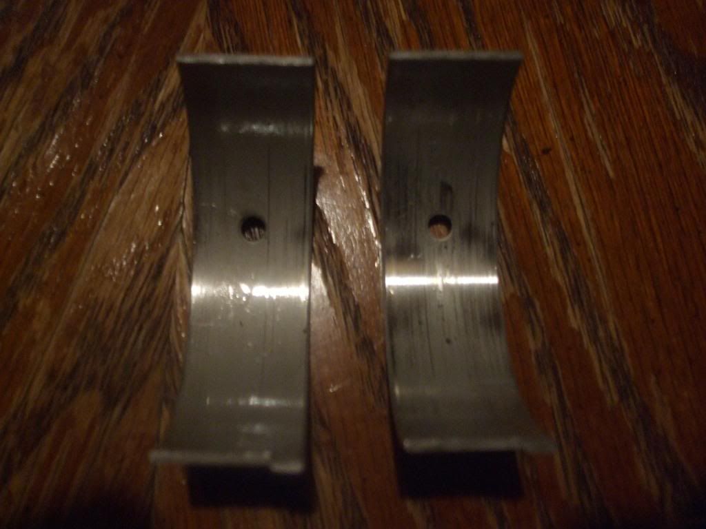

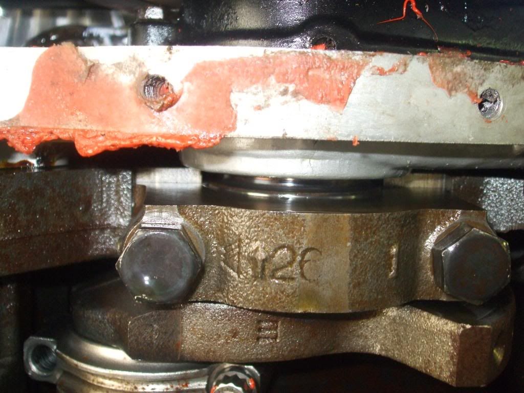

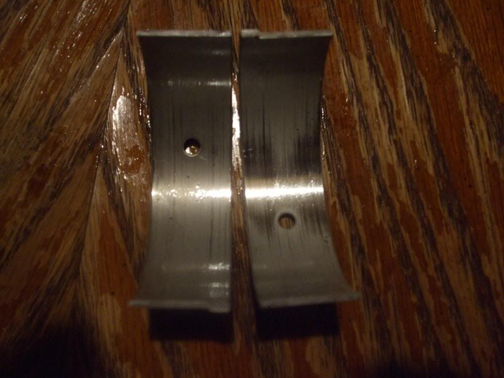

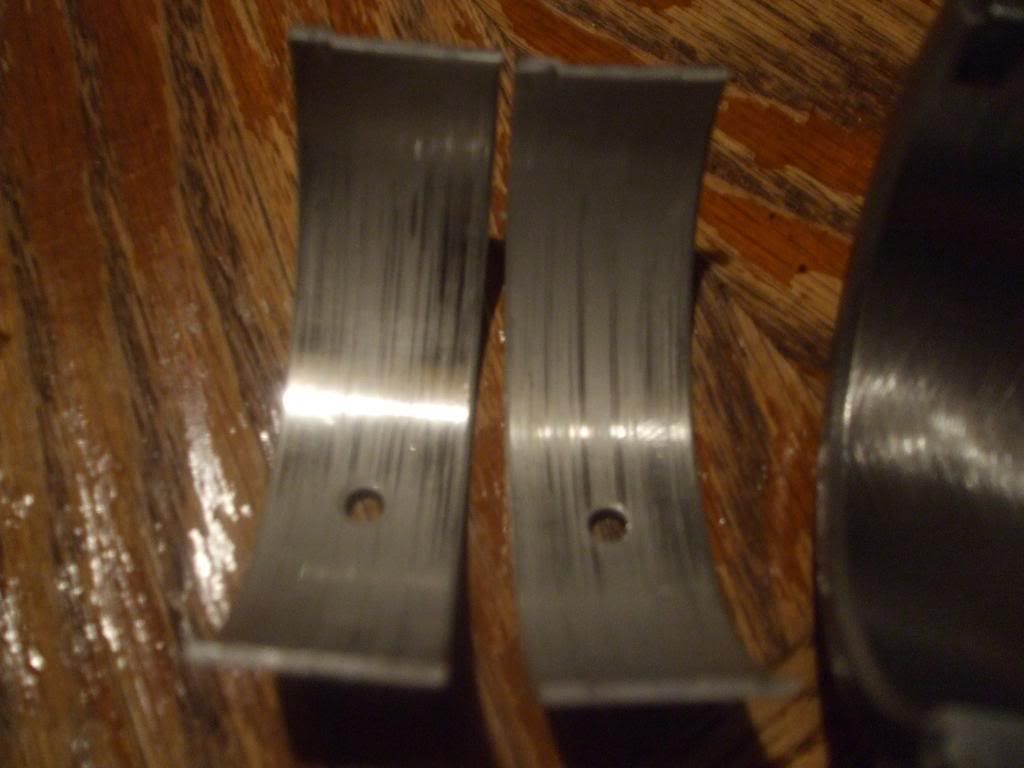

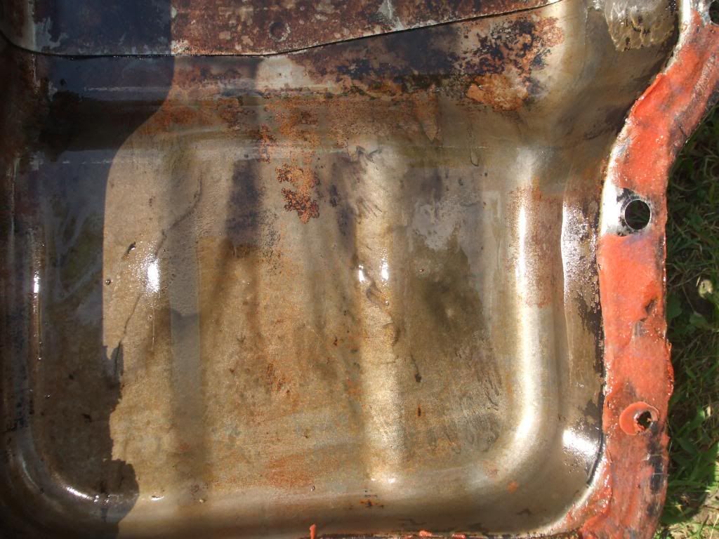

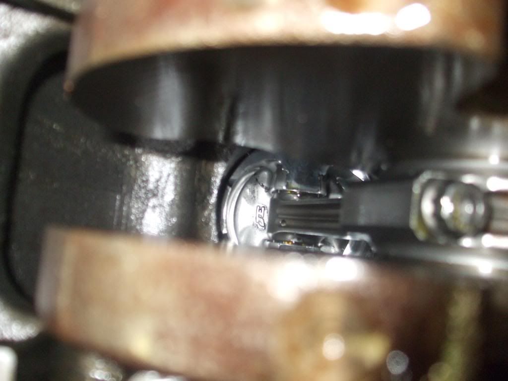

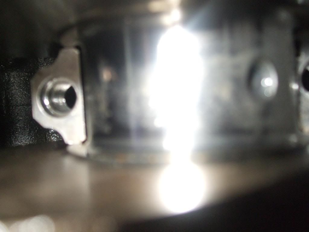

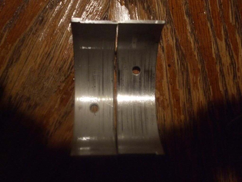

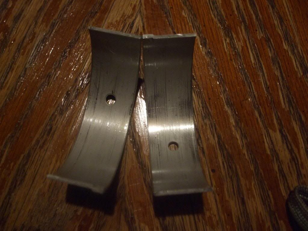

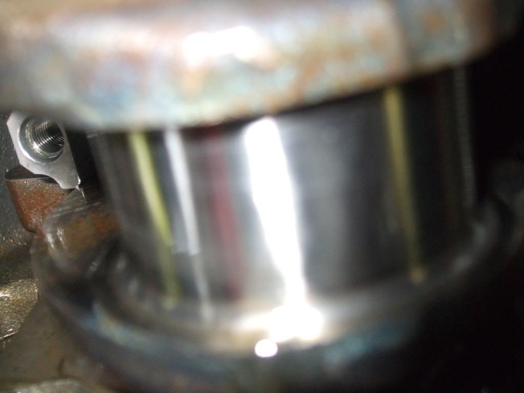

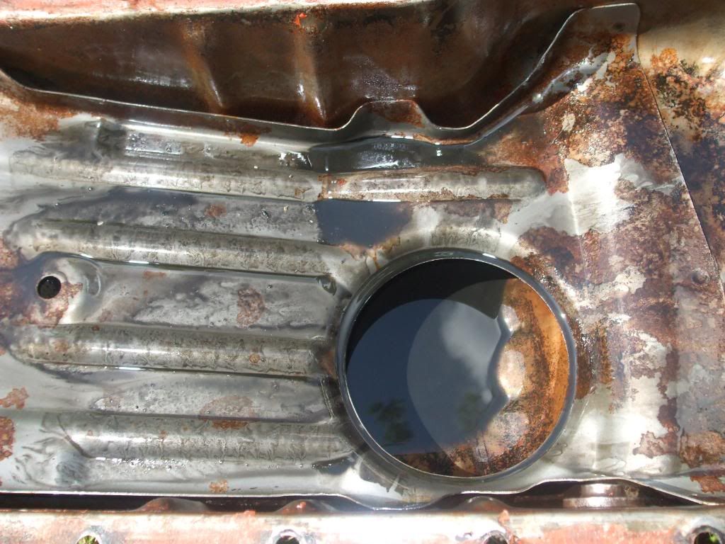

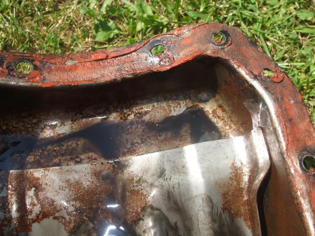

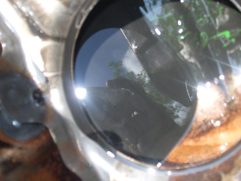

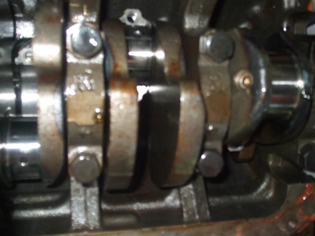

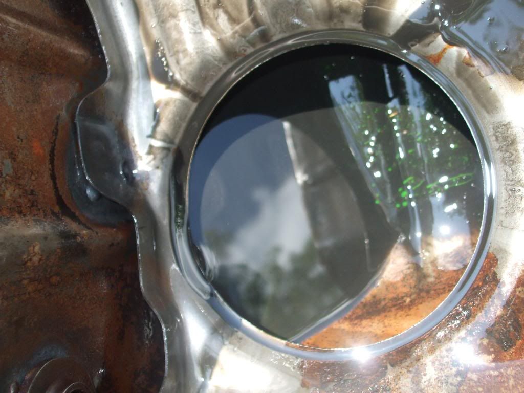

I got it all torn apart to find some really nasty oil and some ugly bearings. The oil flickered in the sun like wet metallic paint. The crank weights had some heat marks on them you can see that in the pics. The rods and rod journals looked fine with no deep appearing scratches or none that i could feel with my fingernail. The filter i removed was only ran for 2 or so minutes with it knocking and thank god there were no solids hanging out in there unlike the old one. Although i did dump out the filter and after it spilled all the oil inside of itself it was still pretty heavy not sure if thats normal on a wix. I didn't take the main caps off because i was losing daylight and i was curious if there was a way to get to the motor(top) side of the main bearings without removing the flywheel and stuff. Can i get away with not replacing the mains? I'm not sure i figured i would ask the community for there input because i always get some good ideas from you guys. Do you guys think a set of std clevites would suffice as long as i do this by the tsrm with a quality snap on torqe wrench and some plastigauge i have access to a mic also.
And is there any way to get all the old oil out without pulling the motor?

well you obliviously have metal in the oil :p and some decent in size. #1 is the only one with a different wear pattern then all of them seems to be more spread out and equal on both bottom and top unlike 23456 where the one side of the bearings are getting wear in. not sure what to tell you, i just thought i would point that out. anywho where did you get the hood locks?

had to drop the subframe and pull the pan. But i put in all new acl bearings and plastigaged them all and they were all consistent and within spec. I mic'd the crank and rod journals just to be sure and they all checked out fine also. No visible or feelable crank or rod damage so its all good now
