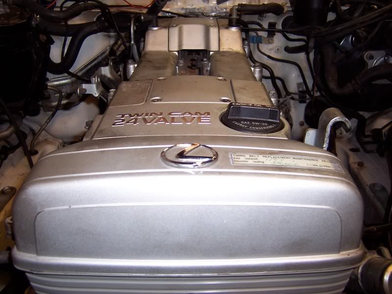

Looks awesome, are you going to run the 7M coils? I'd recommed the IS300 coils. For the money they're worth not having to find a place to put the 7M coils.

hmm..I'll have to look into that, planned on 7m coils for now, Time is really my limiting factor right now with school starting wednesday and working on the weekends and after school, But I don't want to rush the project and screw something up. I plan to have it running in a month or so.

I think the 7M coils would just barely fit at the back of the motor by the firewall, and you probably need two sets of 7M wires to get enough long ones to reach, but I'll probably end up going with the IS300 (is it all VVTi 2JZ's?) setup too.

I have a set of the 2jzgte non-vvti coils - the back cover wont go on without modification because it hits the #5 coil.
I will probably end up getting one of those center coil covers off of ebay. Im not quite sure how it will look with the NA cam covers though.

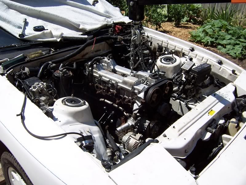

time for some questions,
I extended the alternator wires
swaped over the requried sensors
my question what did you run behind the cam gears to the other side of the engine, cps, o2 sensor,alternator extension is what i have now
I'm trying to figure out what I need to keep under the intake manifold; 2 pin coolant sensor, the 1pin coolant sensor, both knock sensors, the oil pressure sensor.
the sensor i don't know about is the black 5pin I'm sure its the tps.
do you have a picture of the intake side of the enige without the manifolds installed that would help me greatly.
I understand what is going on, but i just want a referance to look back on and to make sure i'm correct.
edit:I'm trying to find a sc300 service manual pdf version

I couldn't find the SC300 service manual, but the MKIV is about the same.
88supratt, sounds like you're all set. you're correct on the sensors that need to be run to the opposite side of the engine.. the black plug is the TPS, and don't forget about the ISC.
