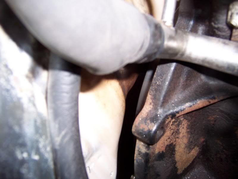

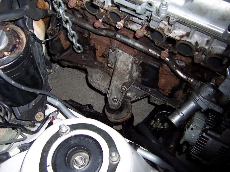

i ran into a little issue today when mounting the engine.
well i have 89+ crossmember with a 2jzge i bought from rj now when i go to put the engine in,it is to far back and to high.i thought that i wouldn't have to using anything but the 2jz mounts on the newer cross member.what parts/what do i have to do to put the engine in.i hate not be able to search suprafourms.so now i have to post.

i have the r-154 but i the engine won't fit.i will take a pic and post it in a bit,the engine is way to far back in the engine compartment. and the tranny won't even fit.
88supraTT
Oct 2, 2005
292
around the bend
pic
another pic
the engine looks a litte more forward becouse i still have the engine housit chain on it.

OK, let me break it down, there are two things on the side of the engine there, the engine mounts themselves, the round rubbery things and the engine mount brakcets, the aluminum part that bolts to the block. You can't use the 2JZ engine mount brackets. If you have a pre 89 like I do you can use the BIC brackets, they allow you to put a JZ engine in the old stlye subframe. If you have a 89+ then you need JZA70 (not all 1JZ mount brackets are the same) mount brackets, or I think BIC also make a steel version of these, or at least he had talked about it in the past. I think you should be able to re-use the mounts you have, but you will need different brackets.

so is their a year difference in 1jz mounts or how do i know which one to get i have the 89+ sub frame..(i thought the 89+ would be easier.i think i was wrong)

89+ is easier if you get a 1JZ engine from a supra (JZA70). That is the only plug-and-play option, and before the BIC mounts came along it was pretty much the only option. I don't know much about the 1JZ swap, but I do know that some of the other cars that the 1JZ came in use different mount brackets that don't work in a supra chassis. I'm pretty sure that Randy was goign to start making the mount brackets for the 89+ subframe since the JZA70 ones are getting harder to find.

I got the motor in, I ended up just ordering the custom brackets from bic. just need the stuff for the turbo and I will be very close to being done.
