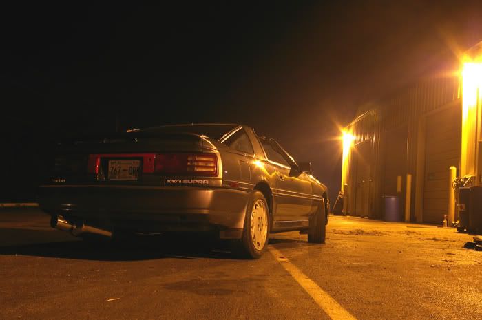

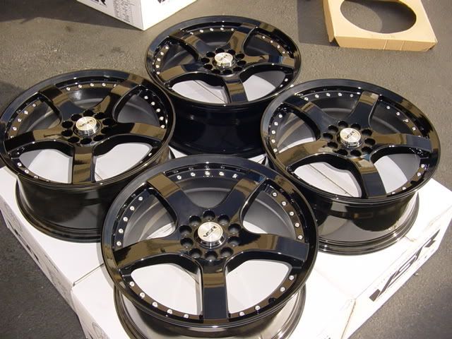

So I got the wheels and tires (245 40 18's) on, and I'm still kinda up in the air about them...
Granted, they look better than stock, but they just don't seem right...opinions?
