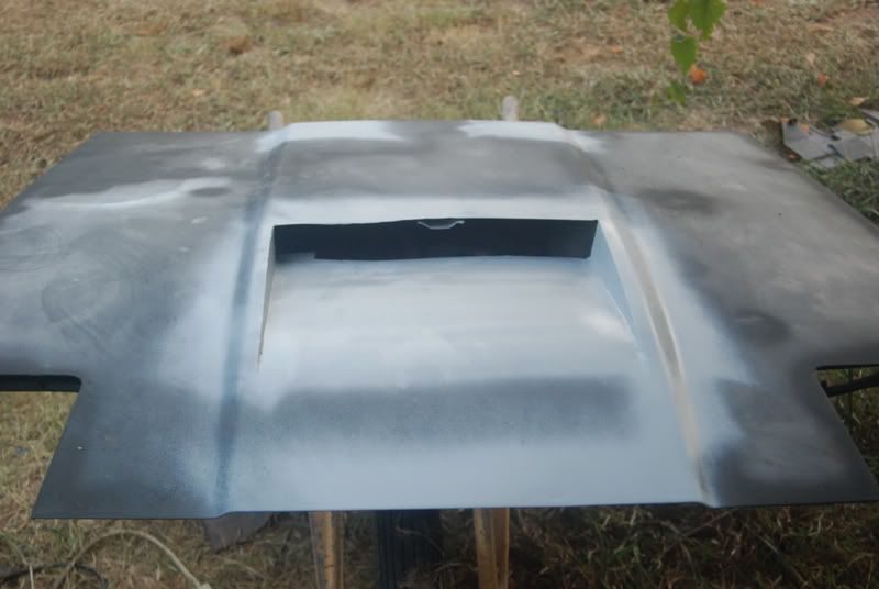

UPDATE!!!!
I revised some of the information on the main post to reflect recent progress...

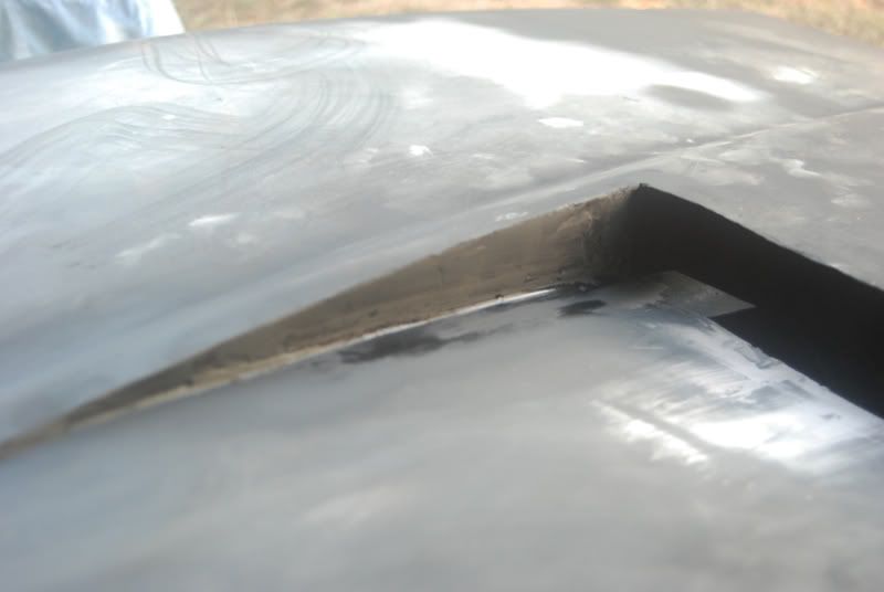

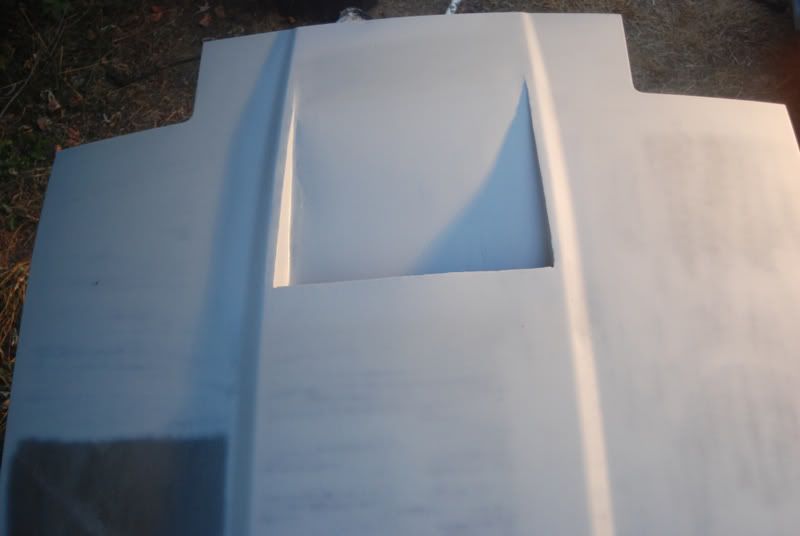

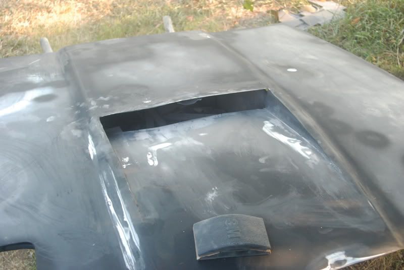

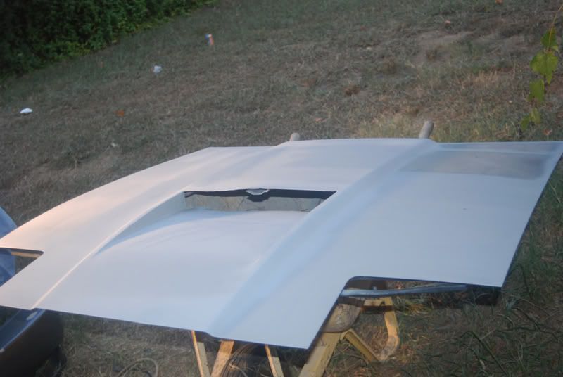

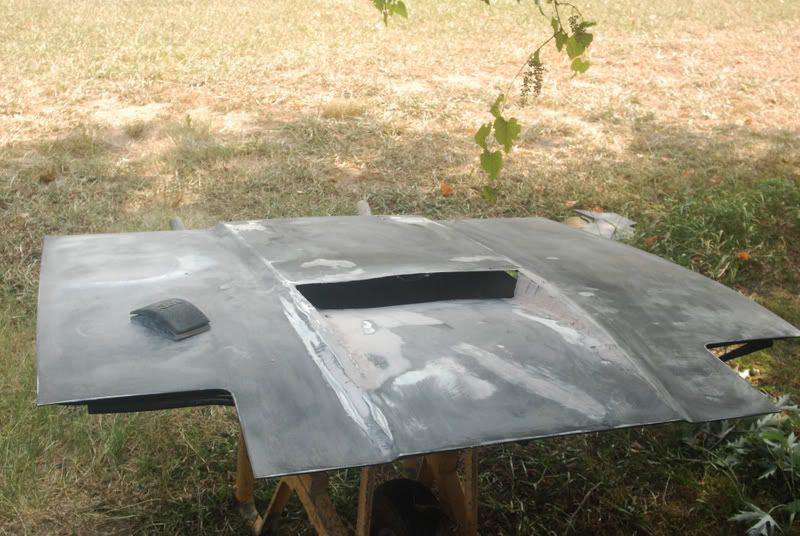

...also, I pulled a failed hood scoop attempt out of the woods and began working on it again. Keep in mind, this was my first EVER attempt at any kind of serious body work, so don't bash it TOO hard.
I tried to show a bit of the progress of it. It still needs work, but you get the idea.

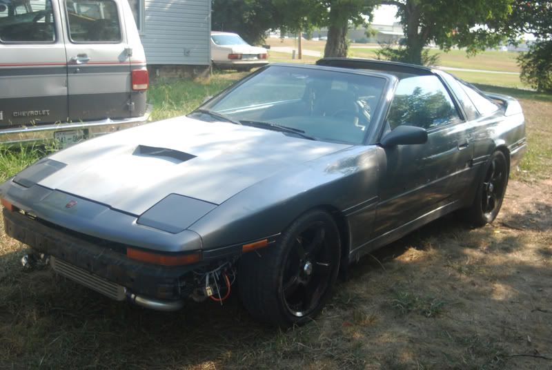

...I was kinda worried about it hitting my strut tower bar (or the motor, even) since the hole was so big, so we threw it on the car for a test fit...
...the bump on the lower part of it is from one of the original braces in the underside of the hood contacting the cam cover (it's THAT close). A quick trim will fix that right up. I have a brand new (old stock) bomex bumper that should go nicely with it.
I'll try to get some more updates later.

lol, actually, I started the hood over a year ago, so by the time I got around to actually finishing it my options were rather limited...
...and arizzle: the car actually IS lowered. I think it's just how it was sitting. I actually had to take the inner fenders out and cut the tabs off the outer fenders because they kept rubbing and it got annoying.
And the original reason why I didn't make it face the other direction is because I've seen that 23094823049823059823 times and just wanted something a bit different. It kinda reminds me of a mix between an ss camaro scoop and a celica.

...well, the weatherstripping behind the cowl is gone, so I was kinda hoping that would help the wind resistance a bit...
...plus, given the location on the hood, I was kinda banking on most of the air flowing over the hood, instead of in it.
I'm considering making some ducting to direct fresh(er) air towards the intake on the turbo, but I'm still debating that. Your thoughts?
That's about the only way you can make that ram air hood functional, since you don't have a carb or a top mount intercooler. You're forcing more air into the high pressure zone and that will most likely slow down airflow through the radiator.
