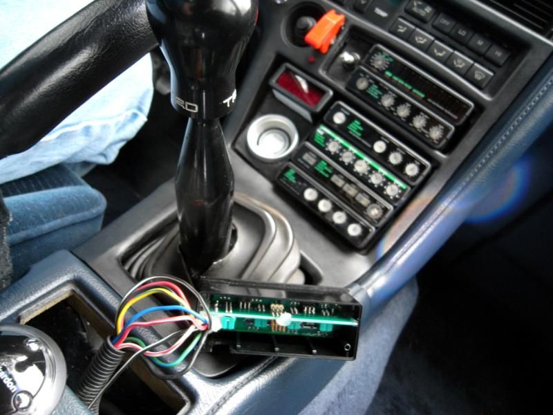

Hey Crisp - While I have you here - There's prob no one else in this world with the exception of HKS themselves that would know more about Supra HKS devices SO here's a question for ya!
The HKS EAC I got from Dan appears to be for 88- cars because the plug has two more cables than the chassis plug so it doesn't fit. Is there a way around this or I'd have to find one that's 89+?

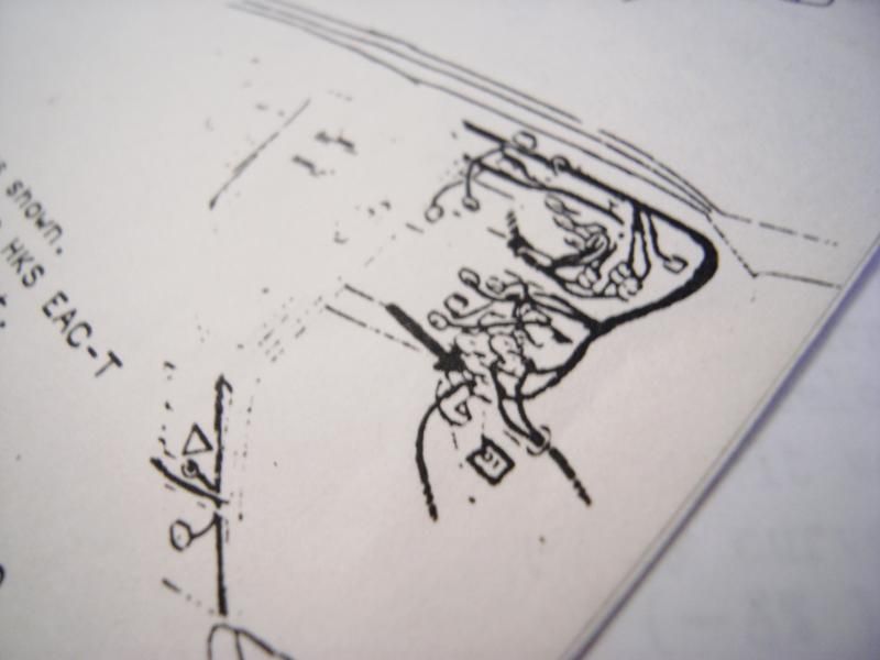

Hmmm... not sure if I can answer your questions, but here are a few shots of the EAC-T Suspension System manual ('86~'88) and my car is an '89 with this installed.
Does that help at all?:confused:

Wow I didn't realise there were two different HKS TEMS controllers. You should be able to just re-pin it into the correct connectors to make it work.
The only thing I knew about was that you had to provide power to a loose wire on the unit to make it work.
You should be able to sort this one out without sourcing another one, they are hard enough to find let alone a brand new one.
Probably what you need is to be able to take pics of the plugs on the 89+ version so you can compare
Are all the plugs different in the Pre-89 chassis?
BTW that pic looks great, I 'm really keen to see more, especially of your battery install

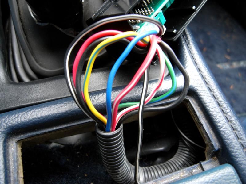

Here's a pic below:
The left plug is from the HKS EAC-T and as you can see, it has 2 extra wires (blue & green) as shown with a red rectangle. I could cut the plug to make it fit, but I don't know if those 2 wires affect anything. Also shown by the red small arrows, the body receiving plug has three missing pins, but yet the HKS EAC-T has them.
I'm thinking that I might have to find an 89+ one, which would be quite a task!
Thoughts?

There will be a way to make it work. I notice some empty pins on the body connector, how many actual pins are there in total on the TEMS connectors and the body connectors?
The other option is to hardwire it. The TEMS controller harness you will notice is mostly just bridging the wires between the kick panel and the body plug, there are only a handful of wires that actually run to the control unit which would have to be connected to the body if you hardwired, you could probably do it with a deutsch connector

I have successfully installed the HKS EAC-T. I was looking at the wrong plug - Duh!.
