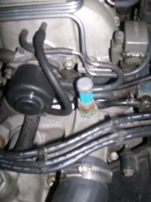

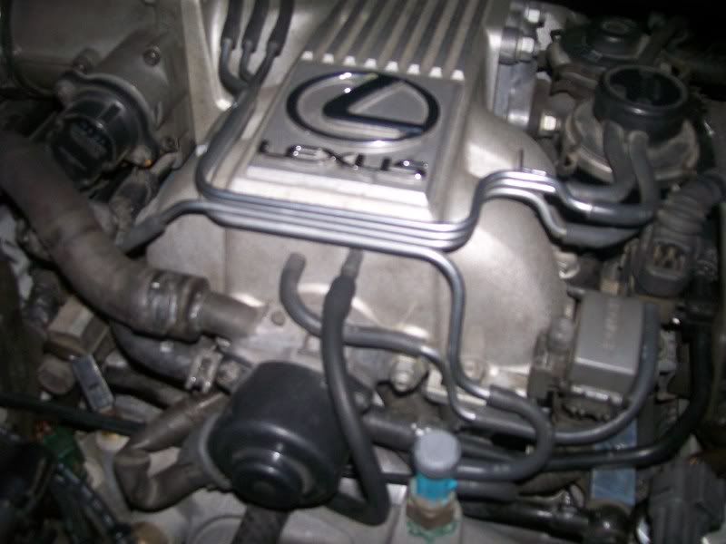

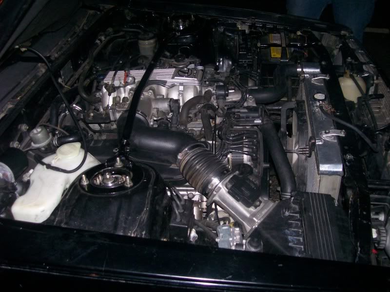

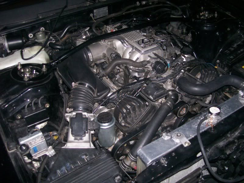

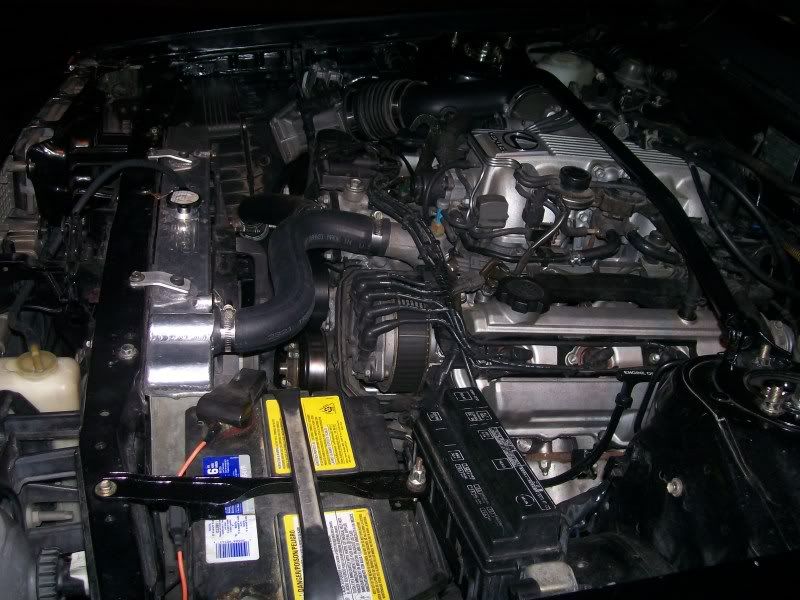

a friend of mine just finished his 1uzfe swapped cressida and I though you guys might like to see

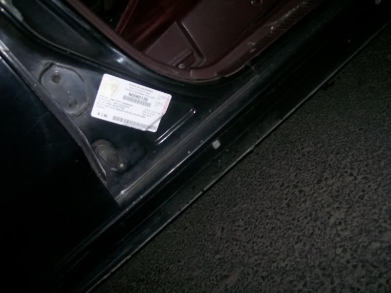

and here's hat makes it all legal here in california!!!! a smog referee tag!!!

That is a very clean engine bay, for certain. 1UZ is not my favorite engine though, it really doesn't make enough HP stock (The LS400 is sufficiently brick-ish to need the torque though).
Perhaps a supercharger would gain some more interest?

RazoE;1517001 said:
how'd he get that legalized if 1UZ's never came in any Cressida, newer or not..?
Doesn't have to have come in the same car, just has to be newer than the chassis it's going into, last time I checked.
Of course, a 2JZ could drop in without notice, eliminating the annoyance of dealing with smog referees. A 1UZ is not quite as stealthy.

i seen this cressida today its also very clean so is the motor it sounds like a best im thinking about buying a cressida soon and going 1uz...1st things 1st need to get my supra done ha

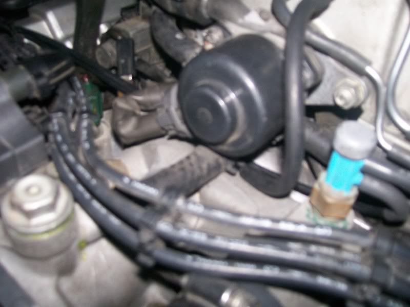

i love these motors. its not uncommon for them to go 400k+ miles, the valves never seem to need adjustment. the only common failure i see, is that EGR tube behind the right head cranks, causing a very hard to get to exhaust leak. anyone else seen this on their swapped motors?
