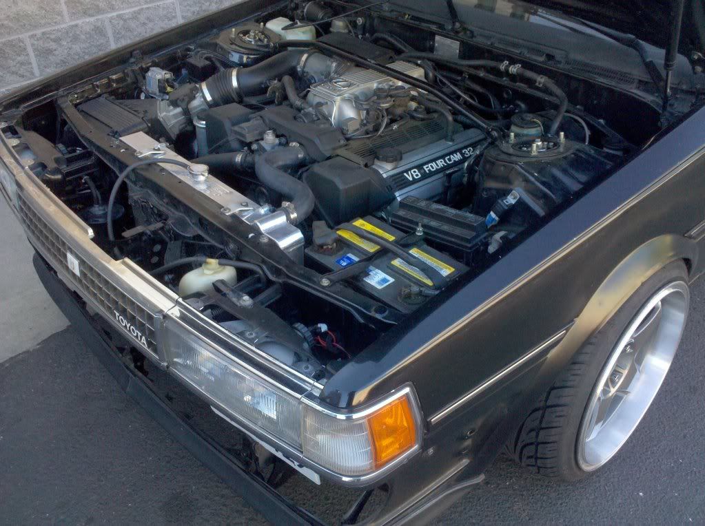

The cressida (mx73) I have is a third jen 85-88, mine is 88.... 1988 is the last year, and the IRS is the same as a mkII.. so you can use the LSD from a MKII... The Transmission I used the LS400 A341e whitch came with the 1uz-fe.. When chosing a engine for your cressida, i would use LS400 engine an engine harness because, the harness matches (not plug in play) but more to the cressida chasis harness then the SC400... oh but the ALT harness does pulg right in too the 1uz-fe ALT, and its on the same side;]

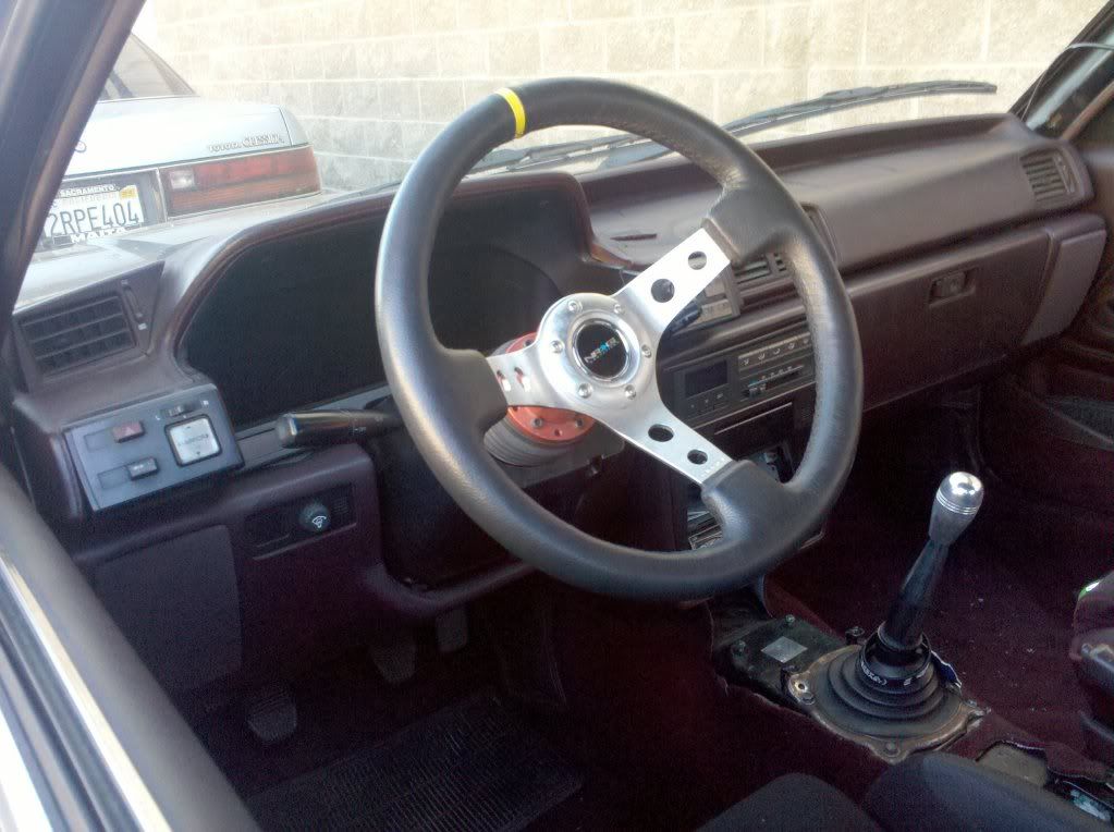

Jame's car sounds sexy. Now that i got my 97 LS400 donor car, I can join the sexy box club.
Gotta love the Lexus Gauge cluster.
