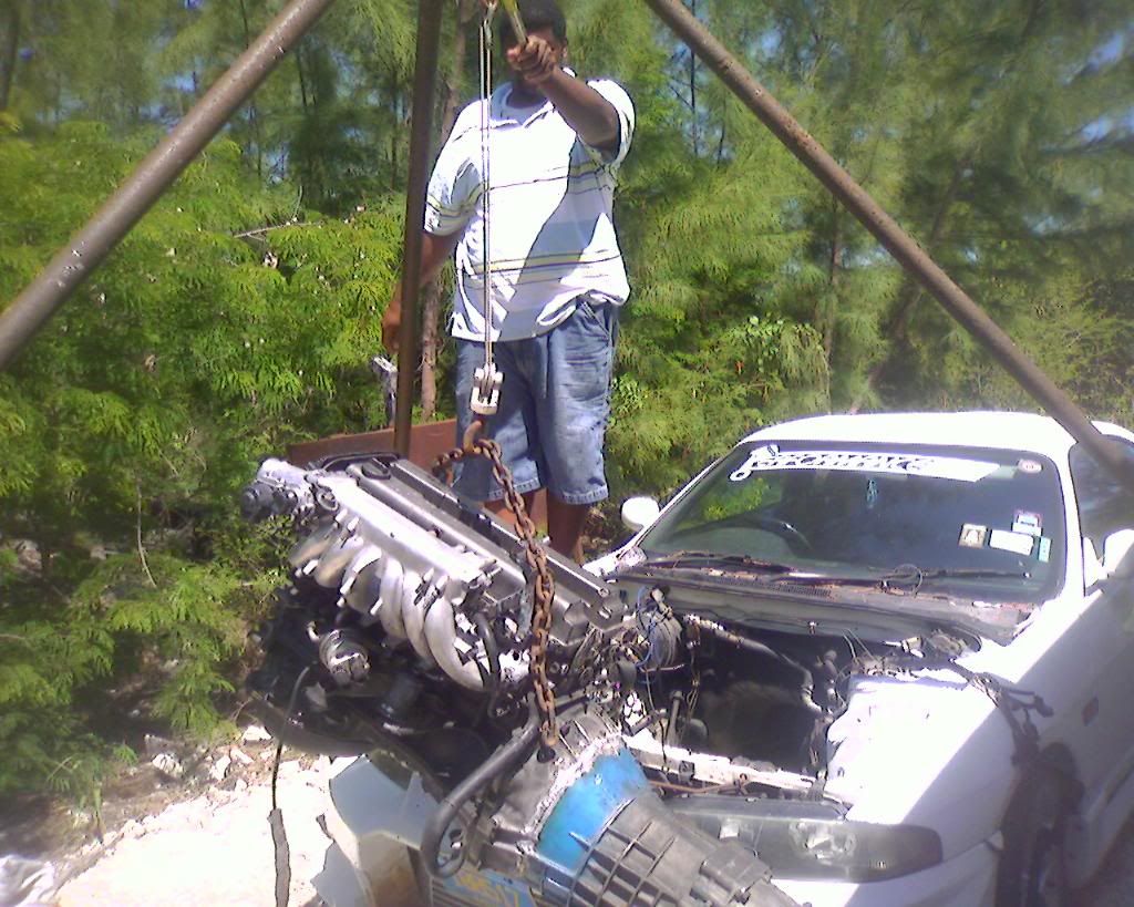

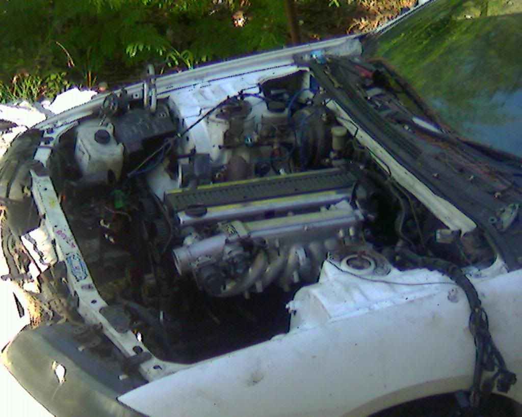

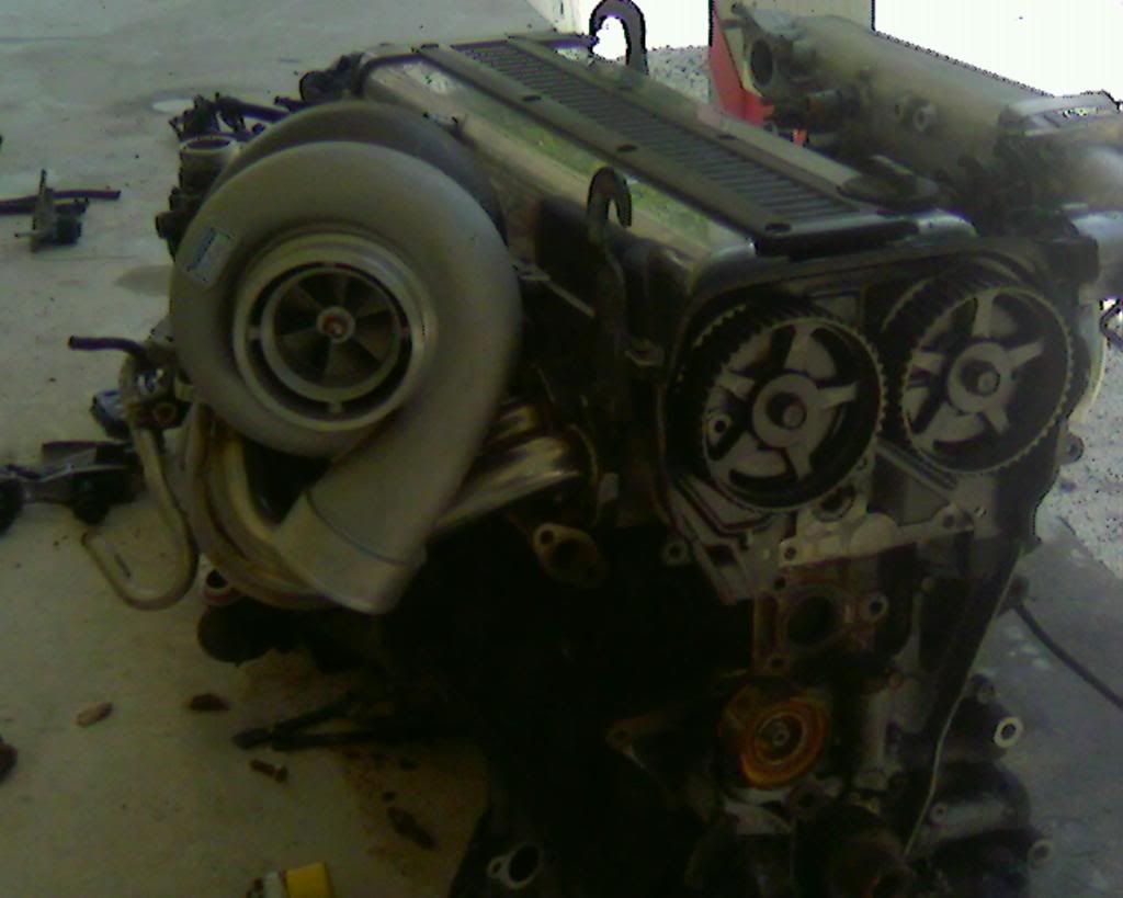

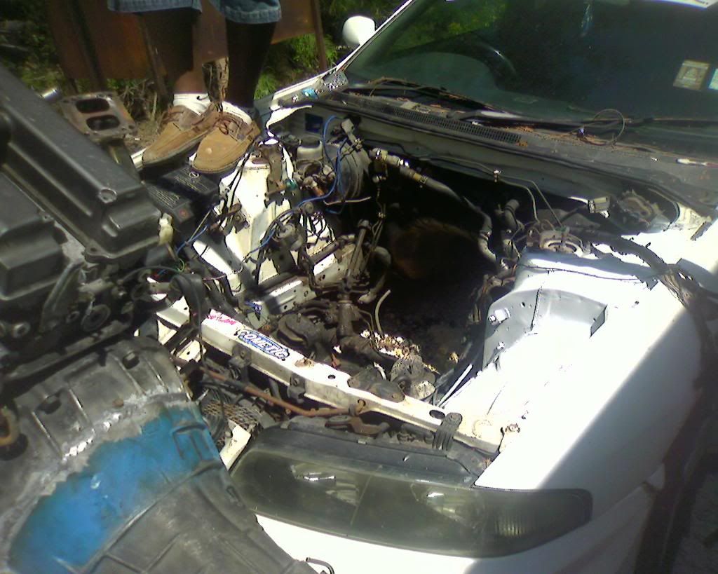

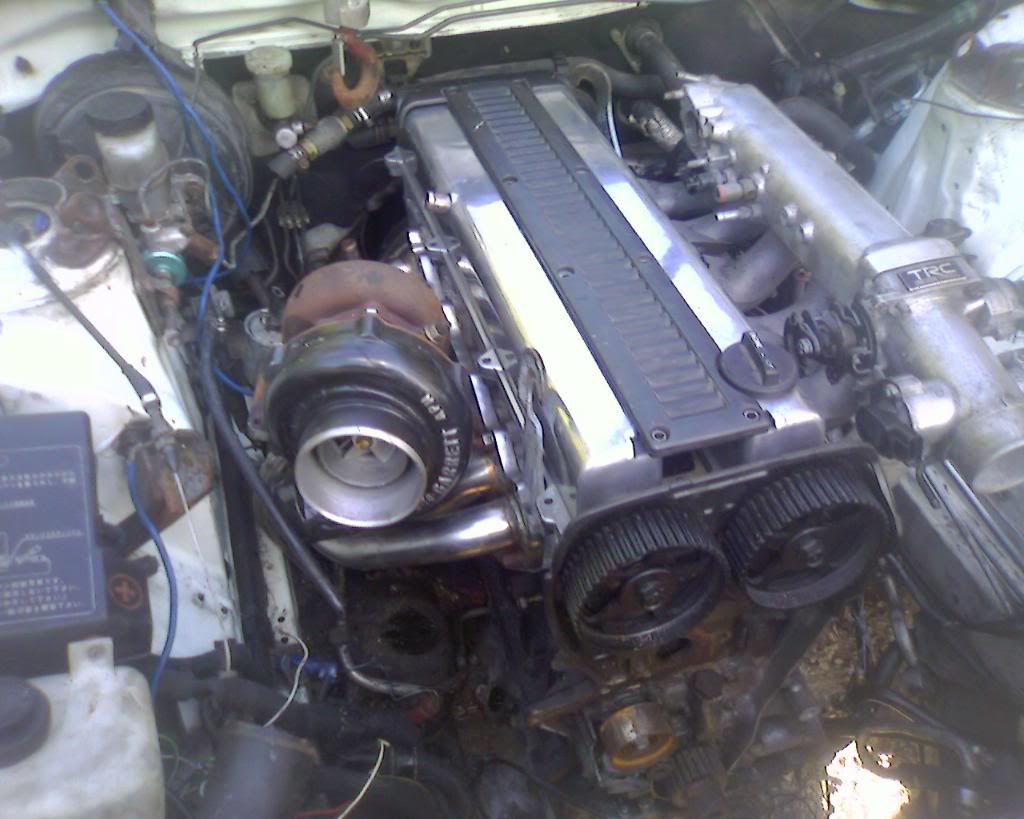

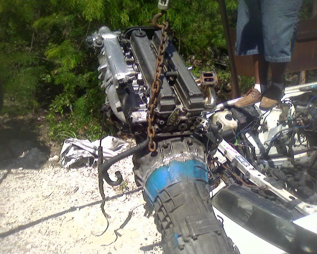

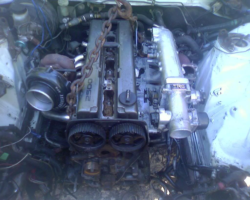

I've have a couple of pics, but i have no clue how to post them.
think i sorted it out,
