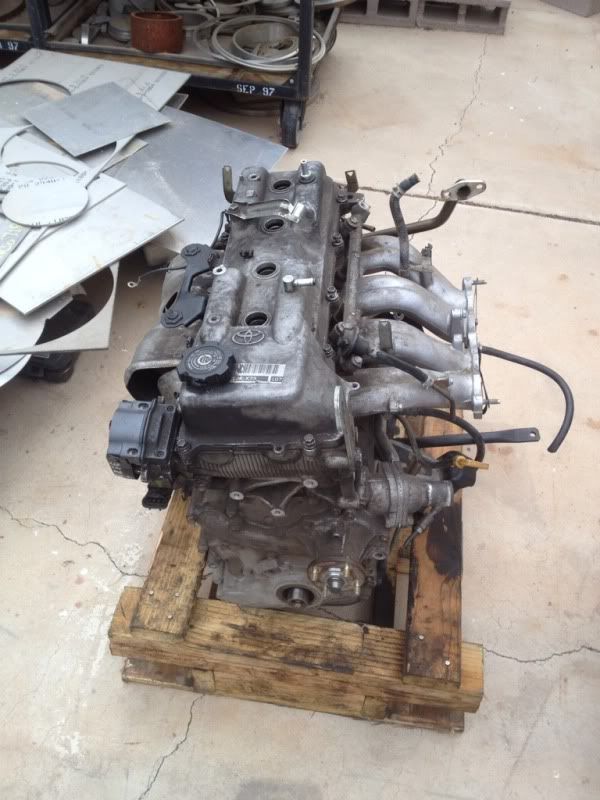

So decided to get a 3sgte, to rebuild. (spun rid bearing) and go Megasquirt II right off the bat to to a dizzy delete, since it's on the back of the head, and will go through the firewall.
There are plenty of write ups with 3s on MS2. Never done MS2 so it's new which is cool to mess with. Trigger wheel and sensor will be needed to do a dizzy delete and I'll prob go with 1zz coils.
My major obstacle for this project is what I'm going to do about te front sump oil pan.
Any one have any ideas? I have a couple but wanted to see what you guys think first.

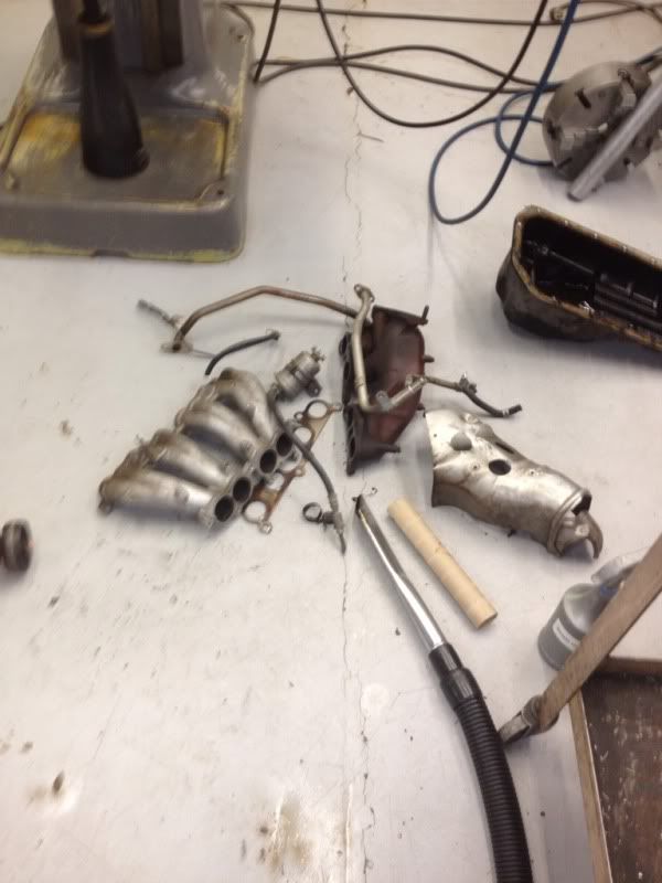

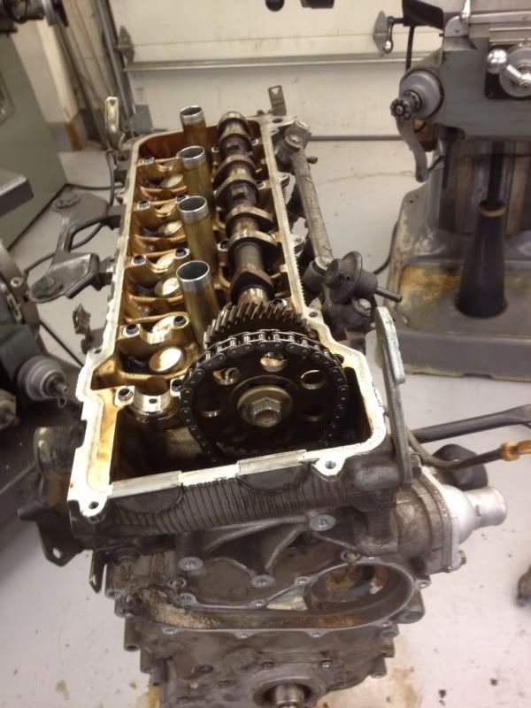

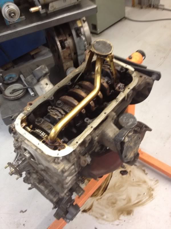

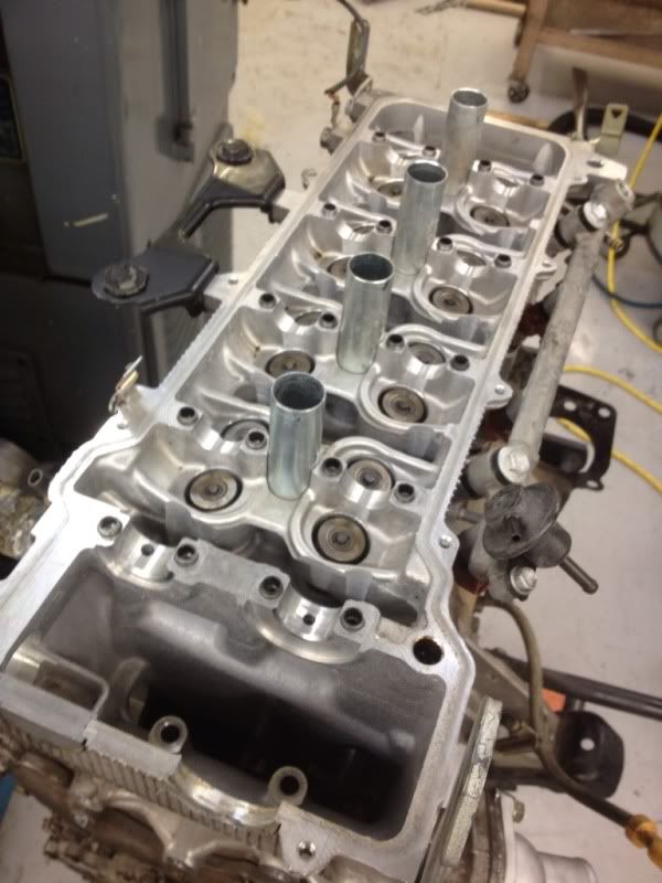

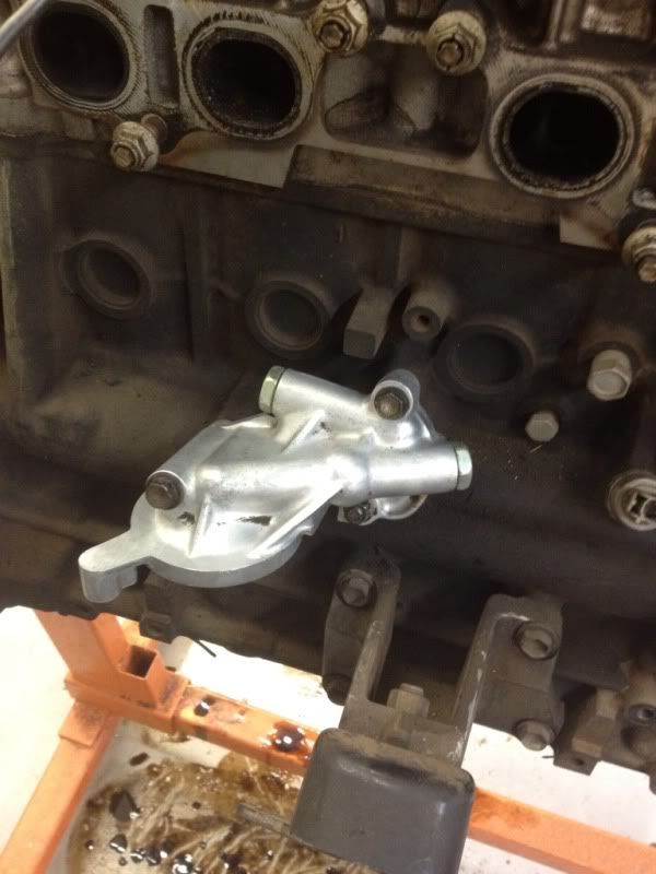

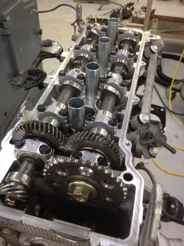

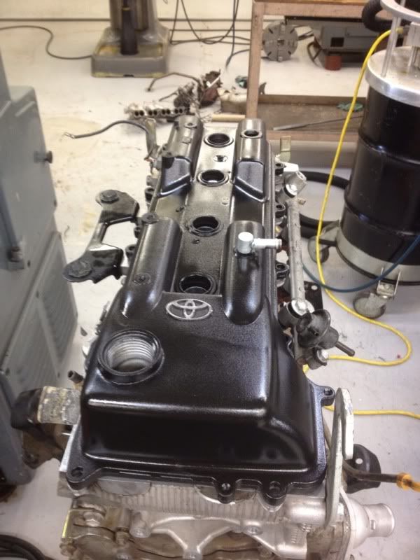

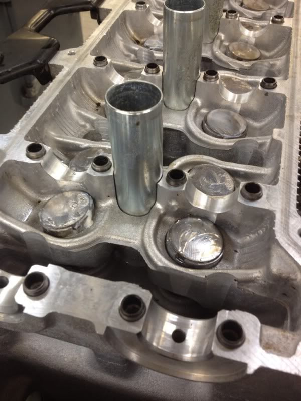

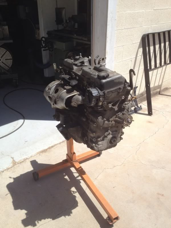

Took the motor apart this; looked ugly as hell.
Nasty sludge in bottom:
Took small pieces off the block and scrubbed them in solvent tube:
How gross the head looked:

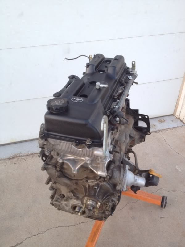

After cleaning and re lube:

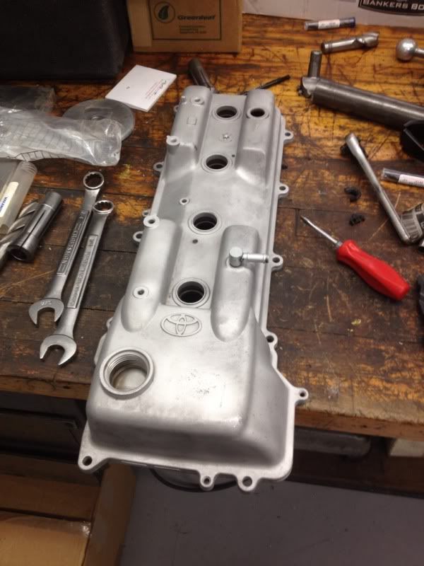

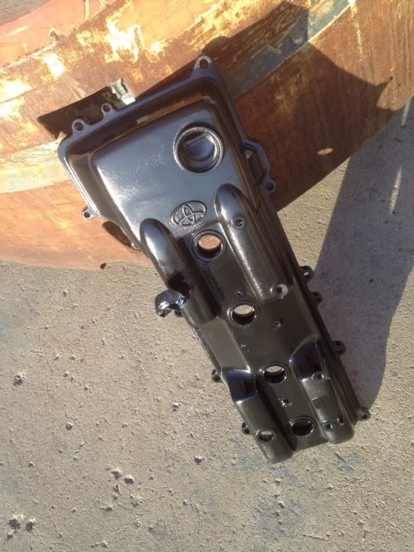

Valve cover clean:
