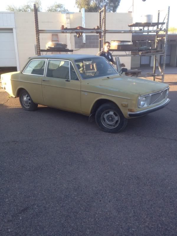

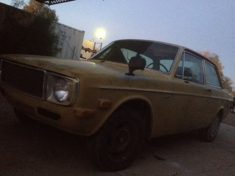

Here is the donor:
Here is what I want it to look like:
Prob will keep it stock, with possibly a 57trim ct26 that I will make. Only looking for 300rwhp, 400rwhp max.

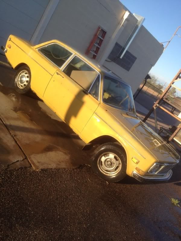

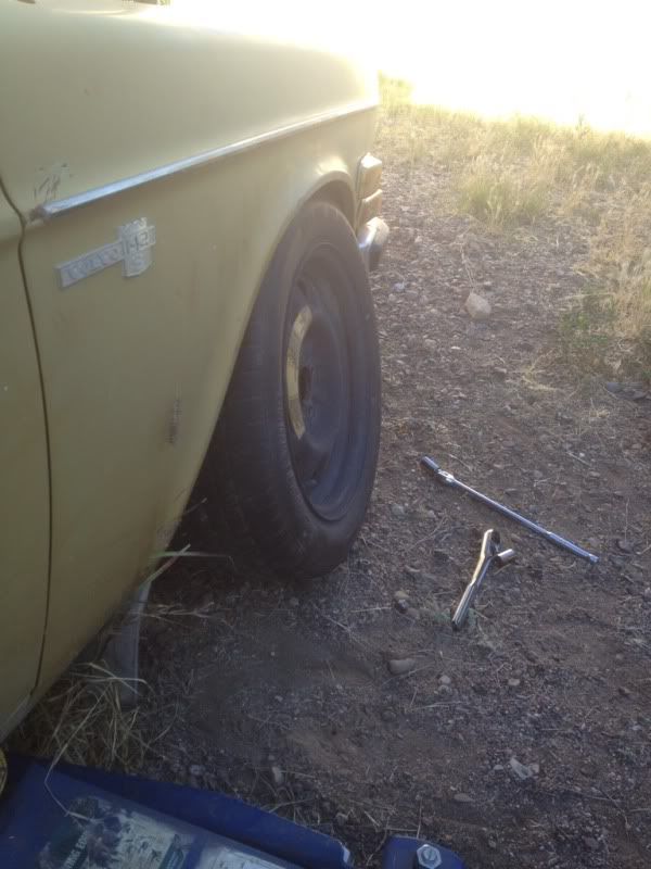

found some better tires for the car off the other 240 Volvo I have.
Got the car wheeled out and washed down:

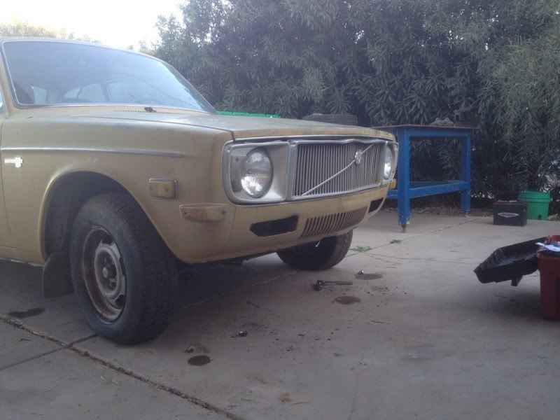

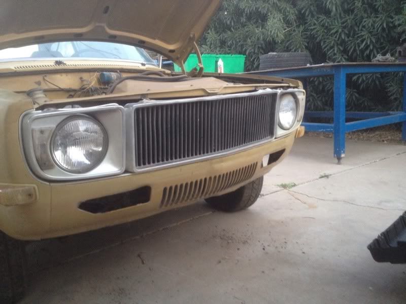

Did a front bumper delete:

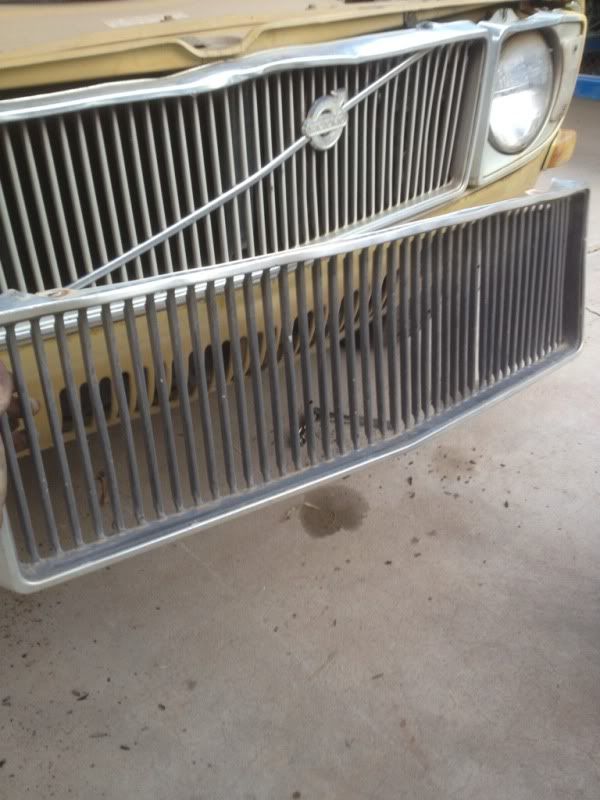

Grill conversion:

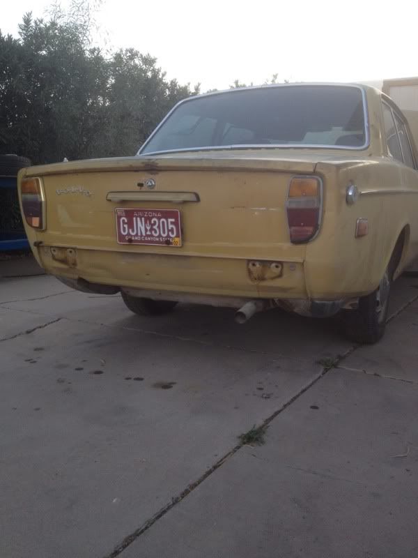

Did a rear bumper delete: not sure if I like it

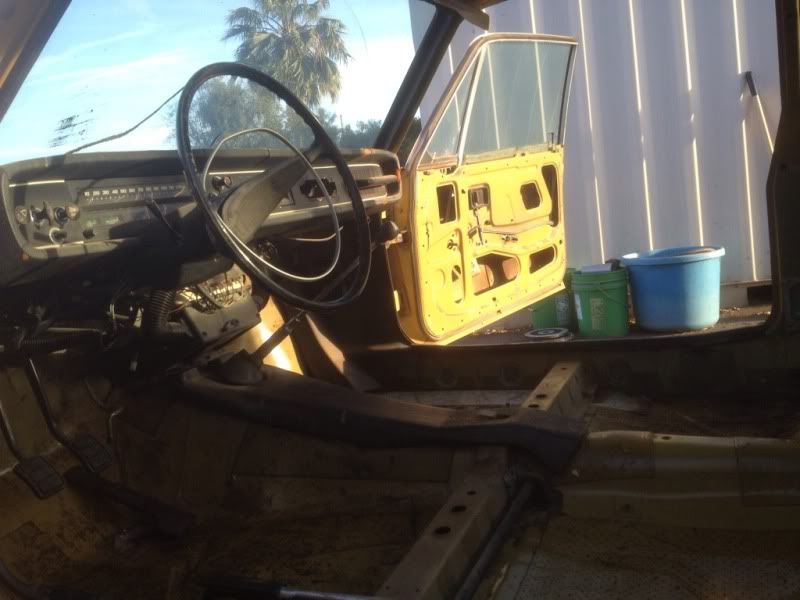

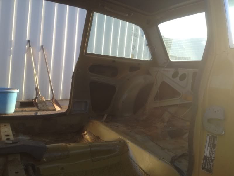

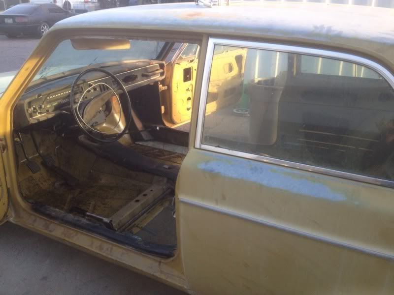

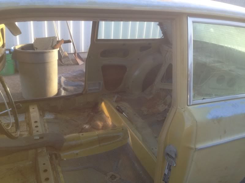

Did some more stripping:

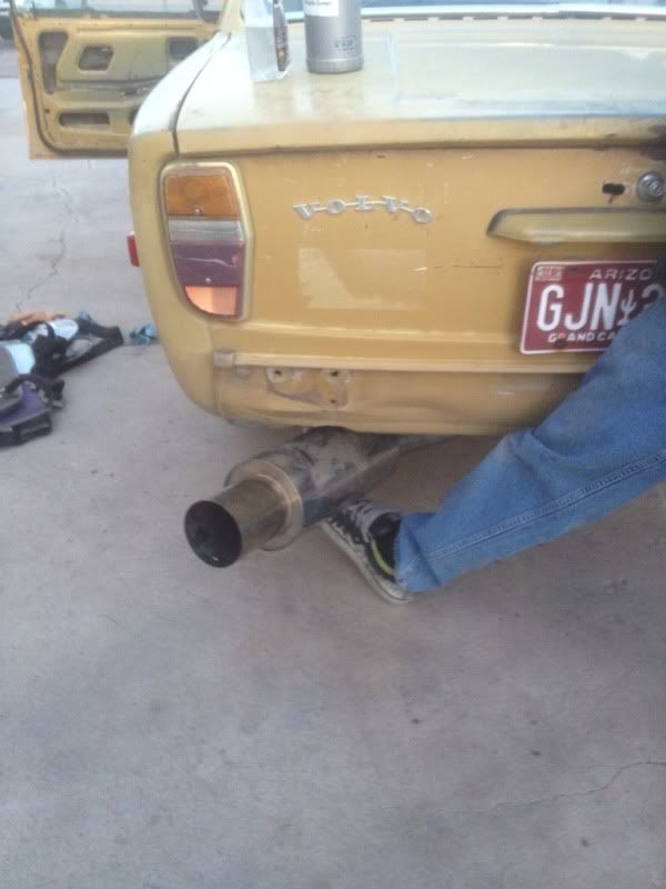

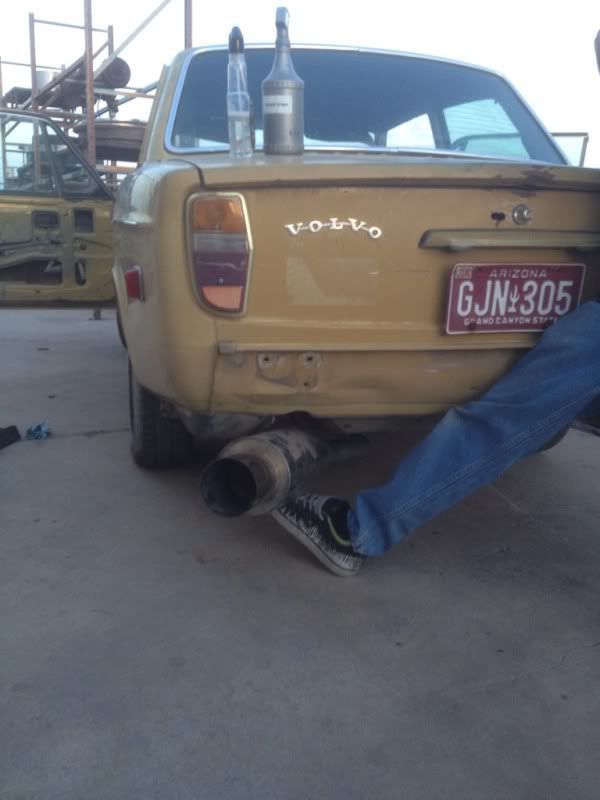

Mocking up exhaust lol:

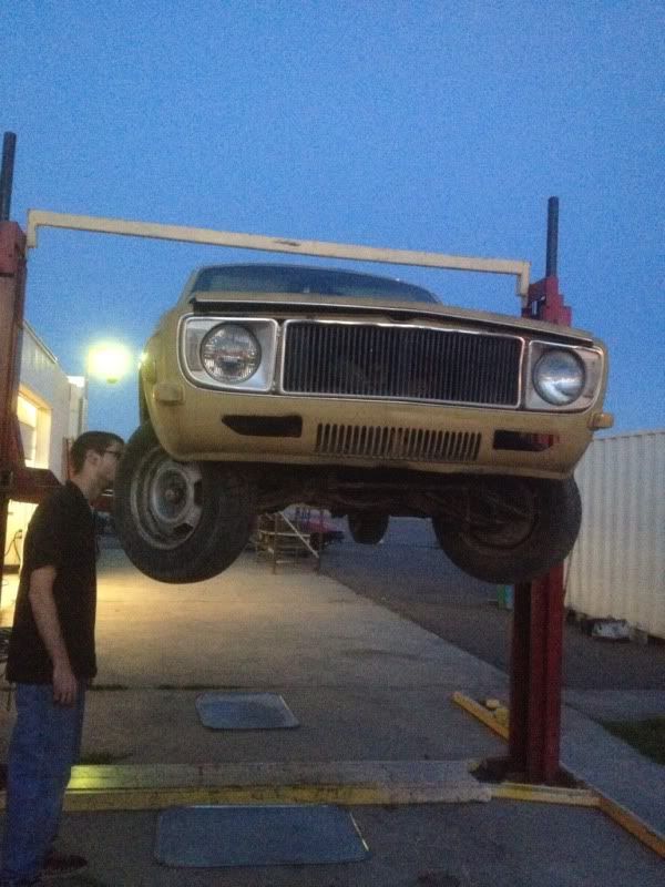

Finally got it on the lift:
