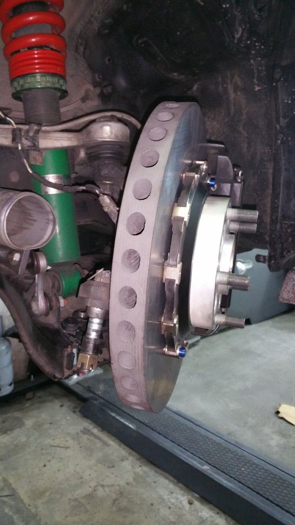

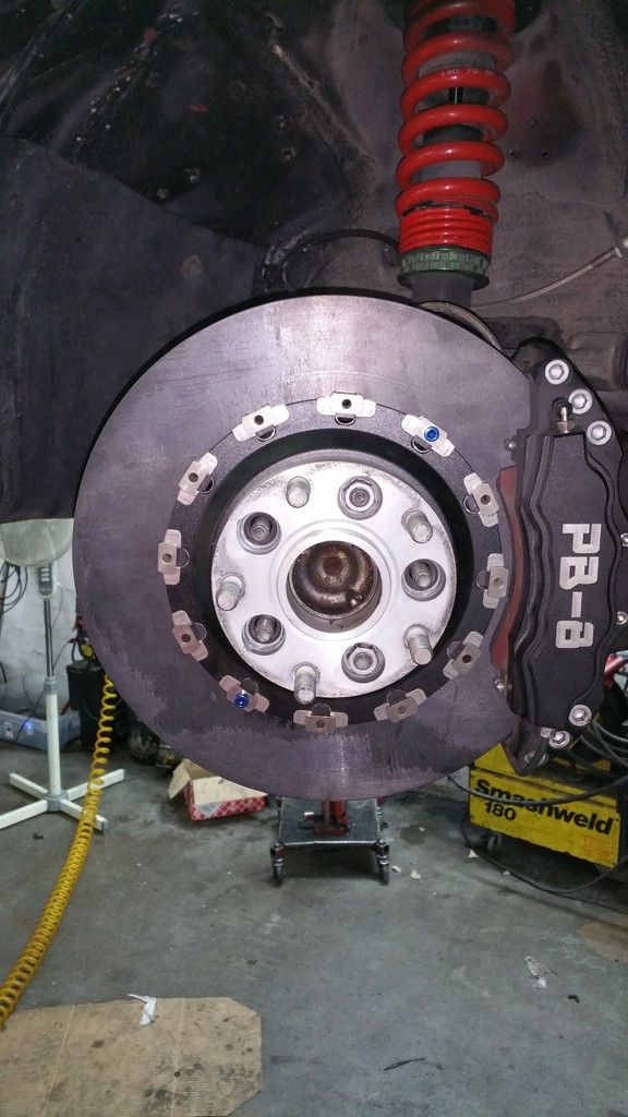

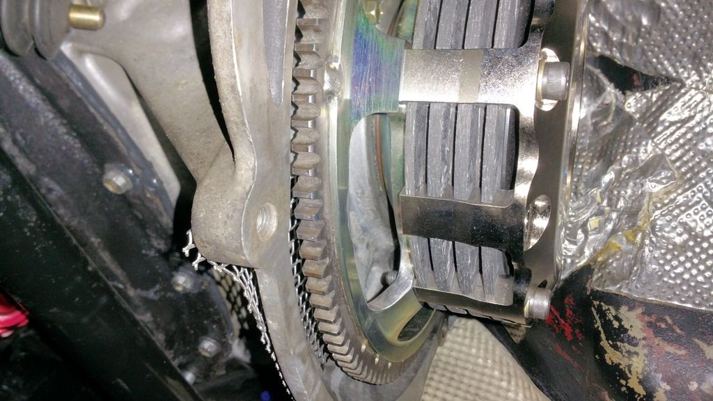

josbeat;2055738 said:
27 kg lower with some new bits
new manifold 5 kg lightter
new ceramic brakes 15 kg less
new Tilton Clutch 7 kg less
also more CASTER at the front moving the lower balljoint
some more weight saving coming
josbeat
Jul 31, 2010
483
spain
the brand of the rotors are wilwood but the rest is a PB-brakes kit I have before , the callipers and floating hats.
the hats are not exactly exactly the right ones but I think they will work, the hats I bought from wilwood arent correct so I will try with the ones I have .
I am waiting to see if wilwood want to make a custom Hats for the Supra but ofcourse it will be posible if some more people want to buy it, some companys can do it like Portelfield brakes.
the price is high , i bought the rotors from Summitracing at better price but still at 2000 USD each.
they are the sheapest ceramic rotors I found .
the pads I bought is the Pagid rsc1 compound , another 300 EUR the front set for a AP-Racing callipers.
also I will use a Ti heat shield plates I am using now.
that is the ultimate brake kit for racing and street with out dusting at all, with out cold or hot braking problems and with out brake noise, AMEN of the weight reduction and life wear but not cheap.
the callipers have a radial mount with a very strong well made adapter, the parts can be buy from PB-Brakes separately
we can see like the hat is not perfect but like is floating it can be used.
