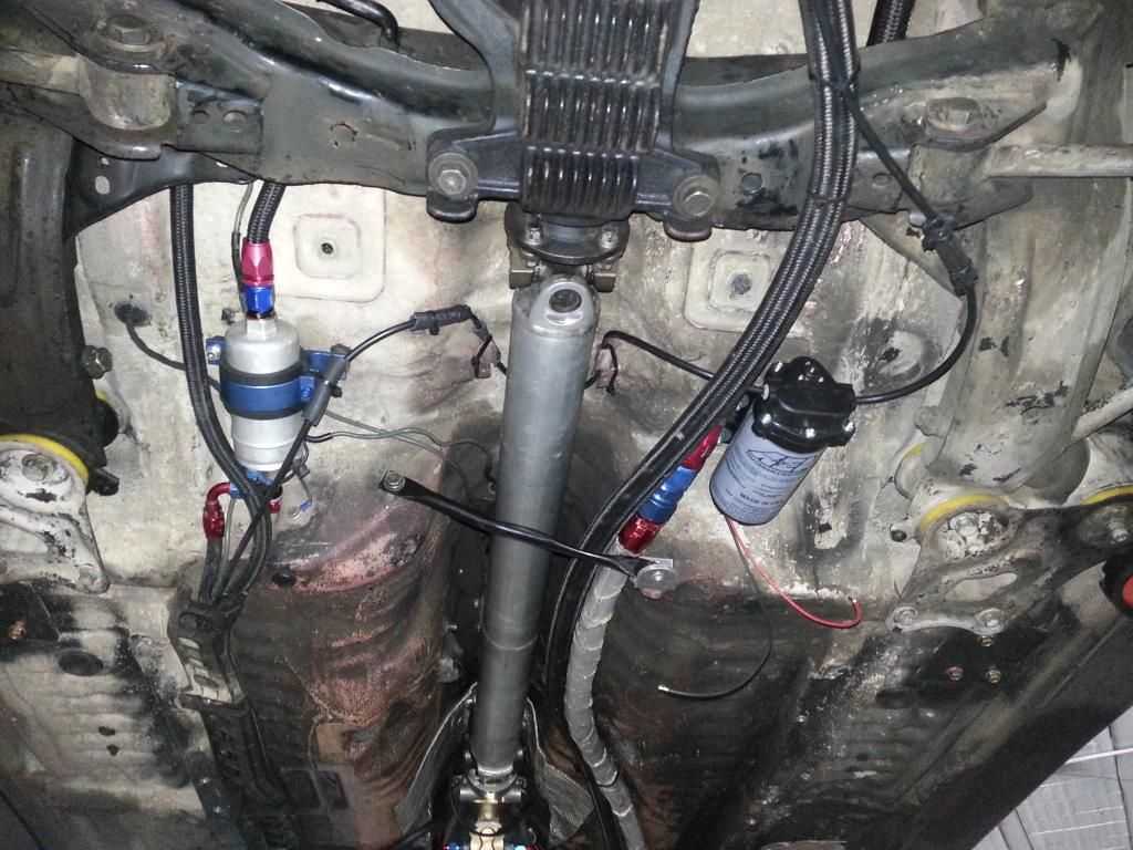

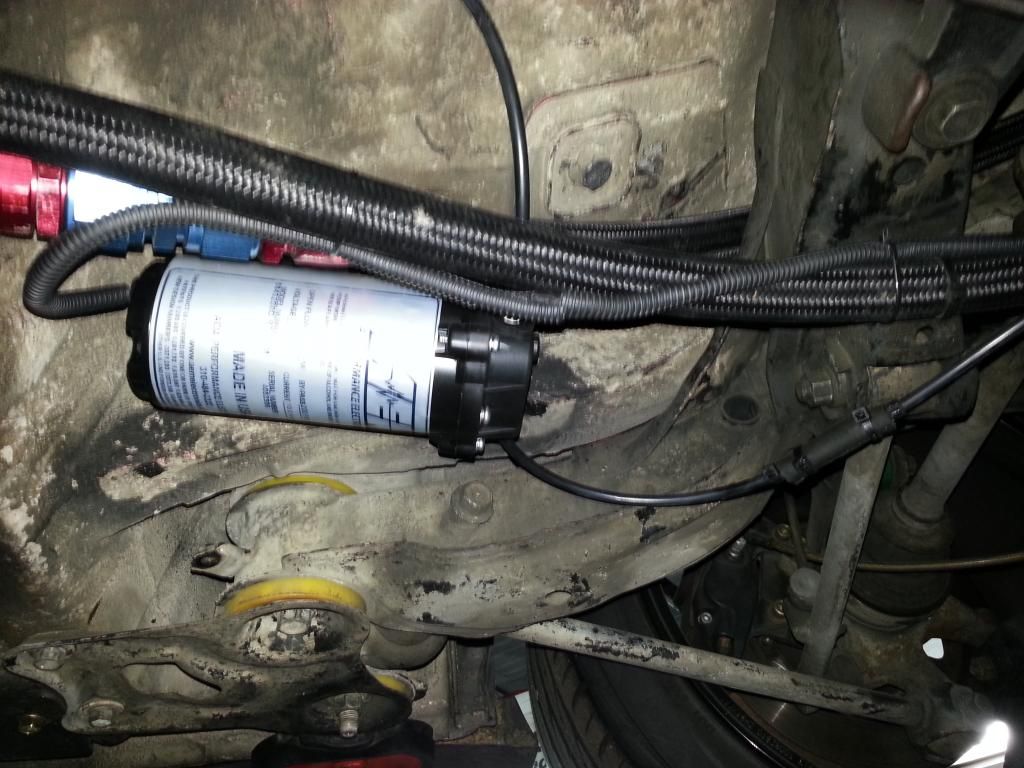

yes is the meth system, it is outside of the car and i can fill it removing the 3 screws holding the fuel tank register plate, the sytem is protected by the flat floor plates.

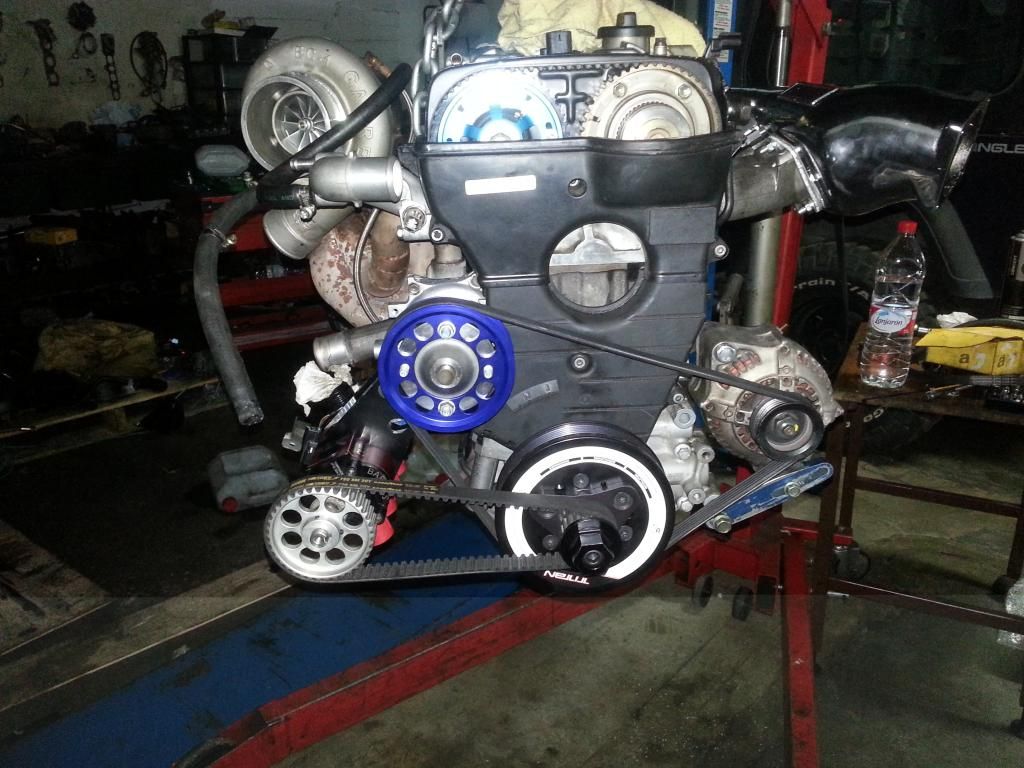

I been busy so I havent had time to finish the car last year but now yes also because I have the oportunity to bring it to Spá Francorchamp and Nurburgring so here is the result.
someheat shields still on the desing table

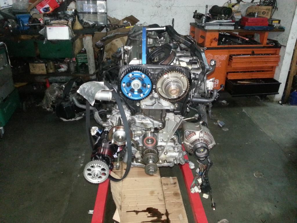

I need to say what was the cause of my 7M broke
It was a piece of paper blocking one of the oil escavenge line
that was the cause way the oil pressure going lower on a high revs beacuse all oil went into the engine flouding it and leaving the oil tank empty.
now the same system on the 2jz is working really well.
I really love the last 7M build I did but those things happens when a frinends non mecanics want to help.
