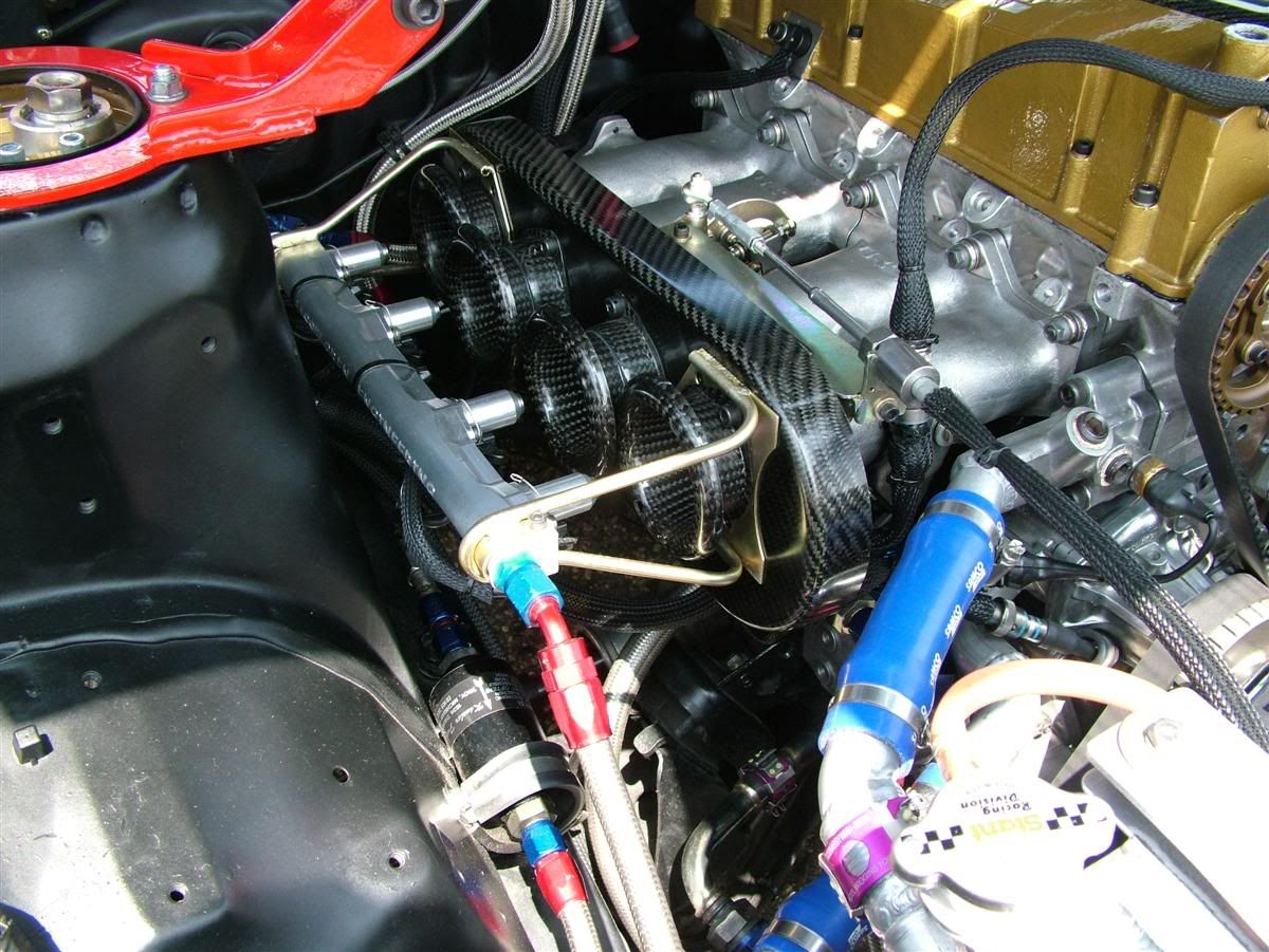

This thing is going to need more air than previously thought. So here I go into ITB land. Looking at some 4AG stuff right now, any thoughts?
if ur still lookin for ITB's, i saw some at a local car show that were amazing billet pieces made by momar injection.. the guy will make whatever u need. www.momarefi.com ask for dusty
Hey thanks for the link:bigthumb:
