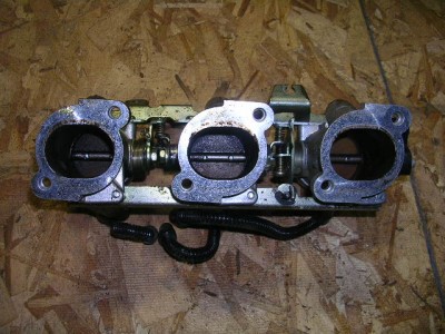

Kai
That Limey Bastard
The reason for suggesting them is...well...look at the port shape:
Handy eh? ;)

Looks to be around 45mm or so just guessing by the picture. Like the shape like you mentioned Kai. Would like to see them next to a 7M manifold or head. Curious as to the distance between the TB's.
