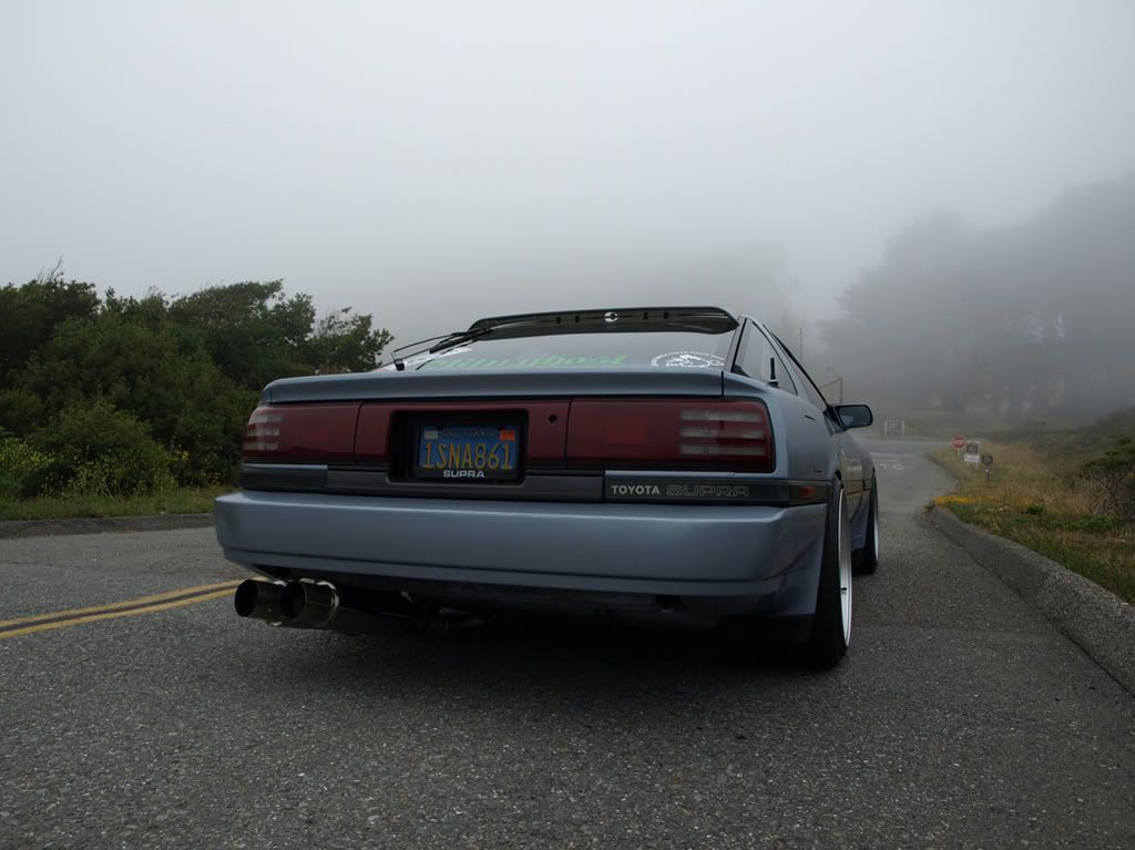

I had a 18x10.5 +15 with 245/40. It cleared after a good roll and some trimming in the rear.
