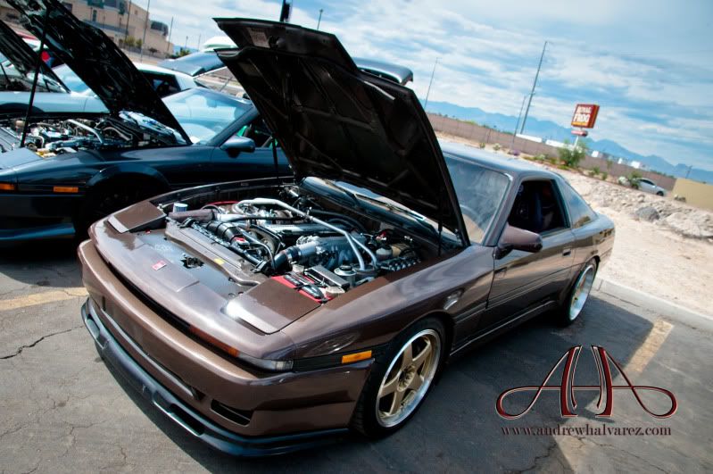

UPDATE TIME!!
Been a While since I updated this post and since Savy updates hourly, I have to try and keep up.
My stock 1jz twin finally started smoking after 2 years of good service. When I removed them there was about 1/8&#8221; of play on each one and broken blades. In a tight budget and trying to get to Supras In Vegas on time (I organize the event, it would be a shame if I went without a Supra), my only option was to go single.
Pictures will come soon, lol have to get them off the laptop with the busted screen.
Luckily my homie had a rebuilt T60-1 (by XS Engineering) with 0.76 AR trim exhaust side and T4 flange he was not using and handed it down to me. The intake side was a bit small, but its all I had in a pinch, he also kicked me down a HKS standard wastegate with a 7psi spring in kit. This all matched up to the Manifold I got from Reaper a wheel back.
Had a Aeromotive Stealth 340 fuel pump to put in (love it), and then the shopping list with Aaron at Driftmotion started:
- Driftmotion/Aeromotive 1jz AFPR kit
- Single turbo line kit
- V-band flanges
- 1JZ down pipe
- Universal Intake pipe and K&N filter
- Random Hardware..
Thank Aaron and Mary they rock and got me all this in super fast turn around.
Luckily had left over piping from the original build to do minor adjustments on the hot side of the intercooler pipes. Picked up a oil catch can from Ebay, very nice unit (internal chambered) and the spent some $$ at Orme Brothers (fitting supply place in Northridge) for all the AN stuff I needed for the catch can.
Things to remember when going to a single Turbo.
- Prime your new fuel pump before installation. Or you will become an expert at dropping your MKIII fuel tank (lol I was tired, car is 20 from my house and coaching football 5 days a week, planning SIV 2012 and worrying about the car can take a tole lol)
- In most cases you will need shorter lower exhaust manifold studs, Do It Center works great for this.
- Your arms will get sore from making -10 AN lines, your wife (if you have a cool one) will learn how to do this as well lol
- The 340 Stealth Aeromotive Fuel Pump will not work with the OEM FPR, 1jz FPR goes bye bye &#8211; Call Driftmotion and get the AFPR kit.
Below is a picture of the Dyno run I did and of the car at Supra&#8217;s in Vegas 2012. After 1.5 hours of tuning in 107 degree Palm Springs weather in July, the car heat soaked to hell, final run was 457 whp at just under 15 psi. Not bad for a donated turbo that I thought was to small. With FSR and Driftmotion as witness, (along with Craig and others) the car is a new animal. With my crappy start I was still able to lay down a 13.5 (114mph) at the drag strip in vegas. First time I have drag raced since line 2000, with no helmet I was not allowed to run again.
I will have more pics up soon.
