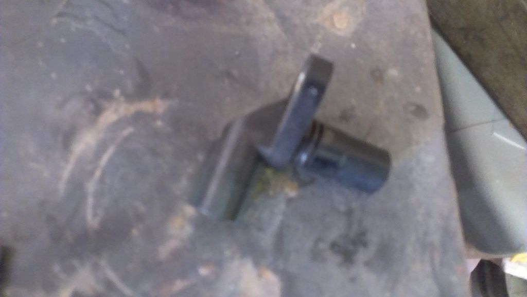

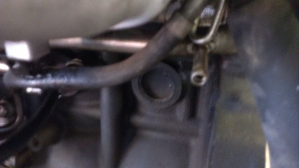

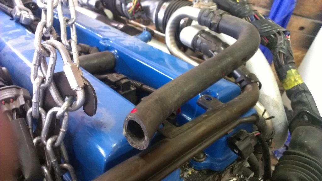

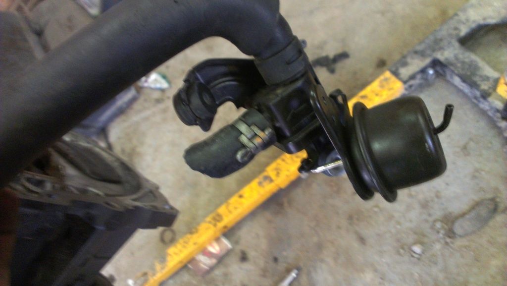

Hi guys I have a few questions about my swap and I'm hoping you guys can help me out
1) I'm following the thread on wiring a soarer 1jz and I am confused about the black and yellow wire on B1. it says "Black/Yellow – Black/Yellow from plug on engine harness loom (VSV Water)" can someone tell me where that plug would be and what it would look like.
2) What connects to this barb? it is on the intake side close to the back of the engine
3) Where does this line go?
4)What is this, and what line(s) go into it
5) What is this and where does it go?
If someone could help me out with these I'd greatly appreciate it.
Thanks
IBoughtASupra
Mar 10, 2009
4,455
Queens, NY
1)Not sure about the Soarer but is the heater valve electrical like our cars that use a VSV? If so, it should be closest to the engine harness ECU plugs.
2) Coolant Line. Nipple on the front of the head that it goes to if you want to bypass all the ISCV and throttle body coolant lines
3) Heater Core Lines
4) Better picture? It looks like the heater valve though but maybe it's different for the Japan cars?
5) It is a sensor but there is nothing like that for the engine. Cam sensors are two bolts and crank sensor has a harness coming from it and this has neither of those.
paulb1320
Apr 21, 2012
31
Calgary, Alberta, Canada
Thank you, I'll get a better picture of #4, and #5 was given to me with the engine I couldn't find anything for it on the engine I think the seller just threw it in with the engine thinking that it belonged.
