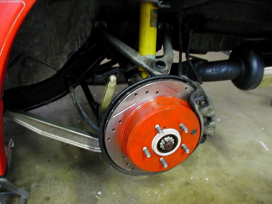

with my front i went 235 with 38mm offset on rear i used 265 but my offset on those wheels were 45mm and any further i worry about hitting the rear traction arm

I don't know how close it was but people run 275's on Mk4 wheels (9.5 wide with +50 offset) and don't rub. I think you had more room than you think.

cant even put my finger between the wheel and the traction arm (i do have the Lipp traction arms too they are a bit taller than the stock design) never had a prob though, thought about getting a spacer...
only pic i have and the wheel is off heh and the pic is blurry, but the wheel is pretty close to it
