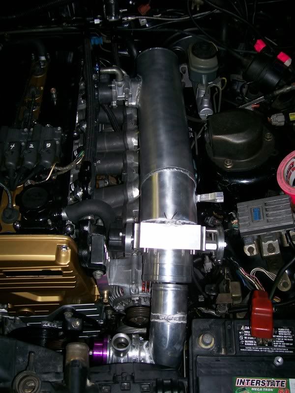

Bt as for the TPS mounting, I simply removed the spacers that come with the kit put in 3 little washers, mig'd the stock TPS butterfly to the end of the shaft, and taped two 10-24 holes in the plate to mount the TPS aimed where I wanted and it was done. Honestly took me 30mins or less!

NONE of them are bolt on. Look at your manifold and you will see that the hole where the stock flange is, is only 2.75" or what ever the stock TB is. So you go bigger then that and all the sudden the big TB is useless! If you want to really take add vantage of a large TB go FFIM and get the whole system upgraded. I talked with Sean awhile back about boring a 90mm hole in the stock 7M plenum and welding the flange to it which would work. But there are no bolt on TB's!
