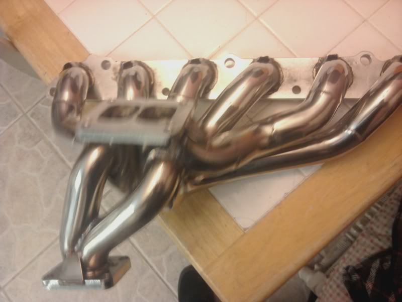

i have a 3 inch down pipe with three itch straight pipe.....and intake im still looking for for one that fits into the 57 trim because mine sure ass hell wont fit in it
[/IMG]
---------- Post added at 11:19 PM ---------- Previous post was at 11:12 PM ----------
yea i checked and my turbo isnt even close to sitting on it rite.... and idk what the 2 pipes coming down r for? thanx for all ur guys help-

Thats a t4 flange manifold. You wont find one with a ct flanged manifold. You either have to get a t4 turbo or an adapter from t4 to ct.
The 2 pipes coming down are for a external wastegate. The ct use's a internal wastegate so you would need to block that off also.
Might as well just wait and get a t4 turbo or sell and just use the stock manifold.

That looks like one of the T4 manifolds which are a clone of the JDM spec T4 manifold. The difference being that it doesn't compensate for your A/C and you'll notice it's a bit "tight" if you put an actual T4'd turbo on it. ex. I squeezed a 60-1 on mine with a 3.5in downpipe, but had to do some banging around.

The input and output diameters? stock. How large is the impellor? 57mm.
The ONLY difference between a 57 trim and stock is that they bored out the interior of the comp. housing and used a larger impellor.
Sell the stainless manifold. You don't need it. Bolt the 57 on, and bolt the downpipe to it, and the accordian hose.
