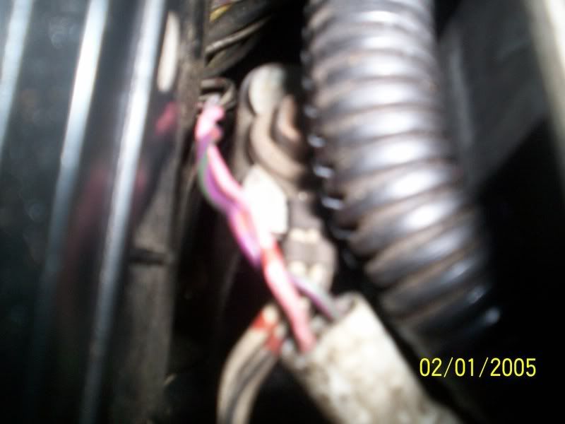

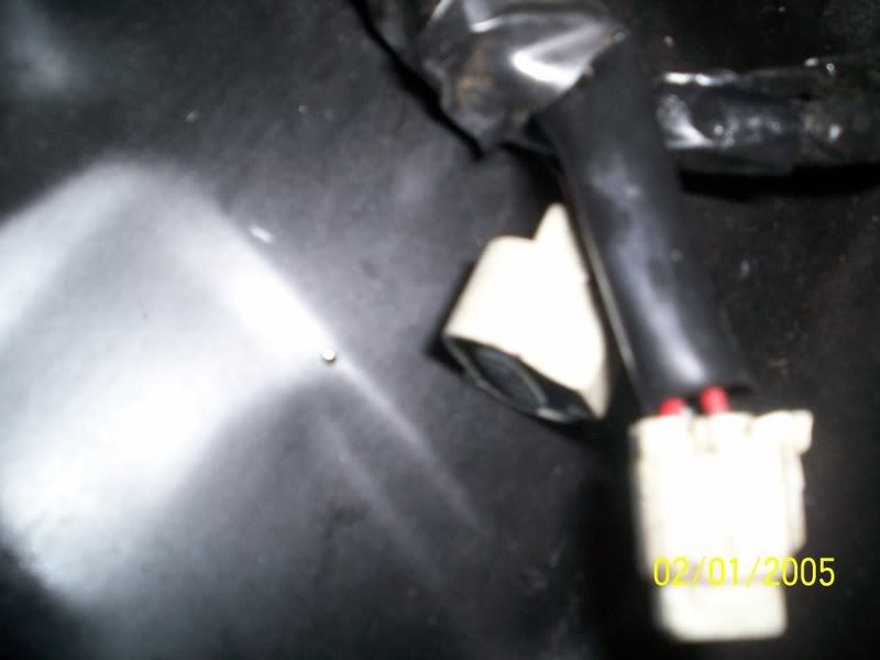

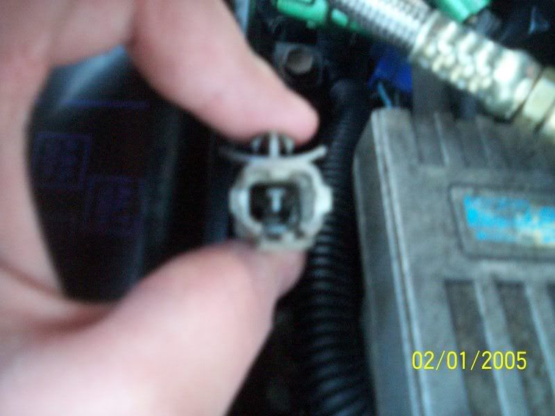

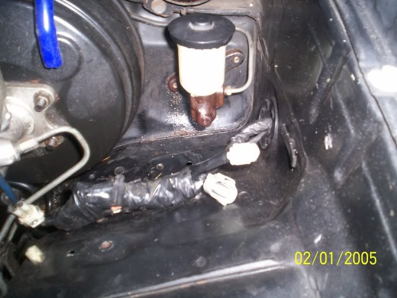

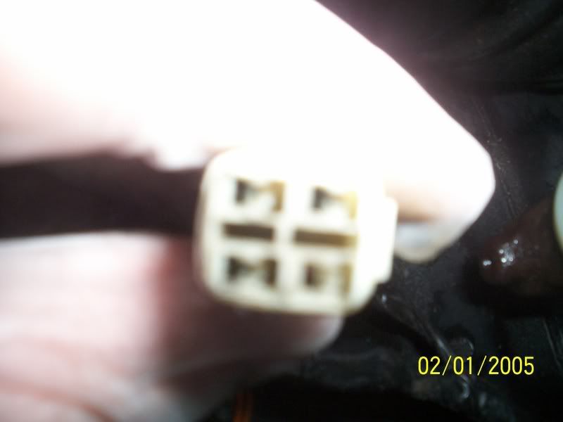

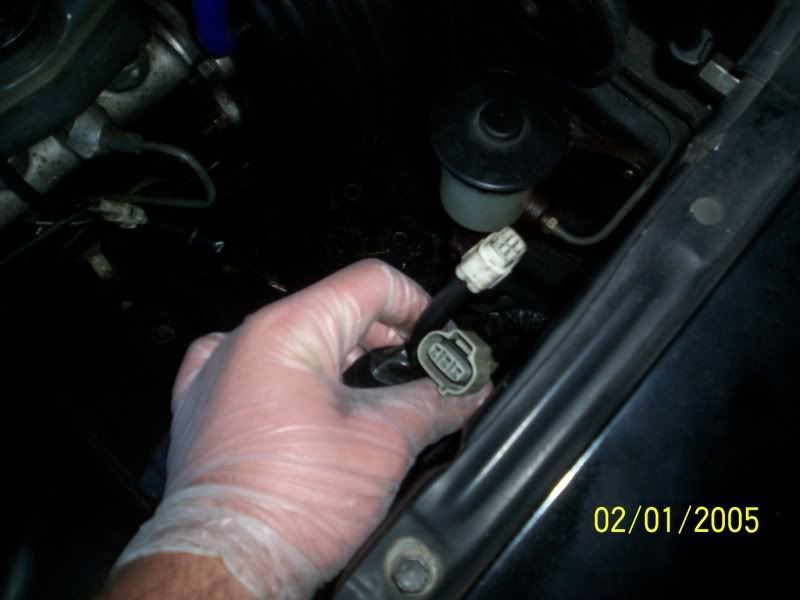

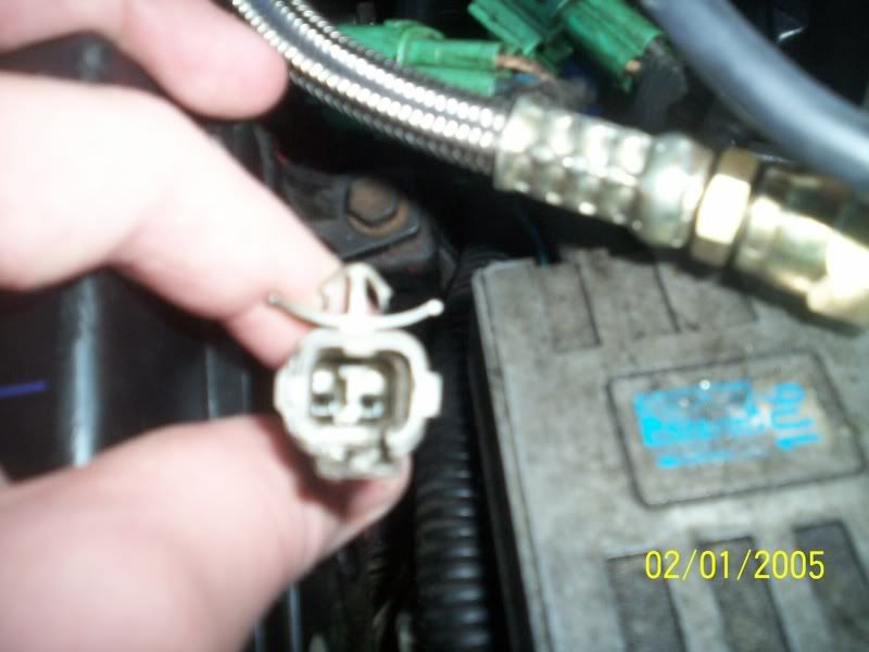

Wonder what the hell they are then. I don't have any of this system or ABS so it's somewhat of a guessing game (haven't spent a WHOLE lot of time looking in the TEWD yet but if no one has an answer I will). Here are some (crappy but it's the best quality I can do (camera sucks)) pics of the previously mentioned plug. Also included are two other plugs all taped up, NFI where those go either. Wires are green-purple and pink as far as I can tell.
CC?

GOOD CALL! Don't have that either, forgot all about it. Still doesn't explain the two identical ones though, two down two to go.

I can not see the pictures unfortunatly.
On the left hand side
Circular connectors are
ABS Main power.
Windhshield Washer pump
and
MAIN Electrical + circuit route.
The wiper motor is black connector 4 sockets.
ABS has four connectors total (going from Memory).
Then you have two going to the High pressure /low pressure switch for the A/C (both white connector). TEMS is white connector. The rear and headlight washer are white connectors.
and that should do it for the right hand passenger side.
RazoE;1093755 said:
I have a disconnected one on the left, too...
I think it's for ABS, but mine doesn't have it wonder if all cars were pre-wired..
yes. That way one harness (keeps cost down). and just unwrap what was installed.
