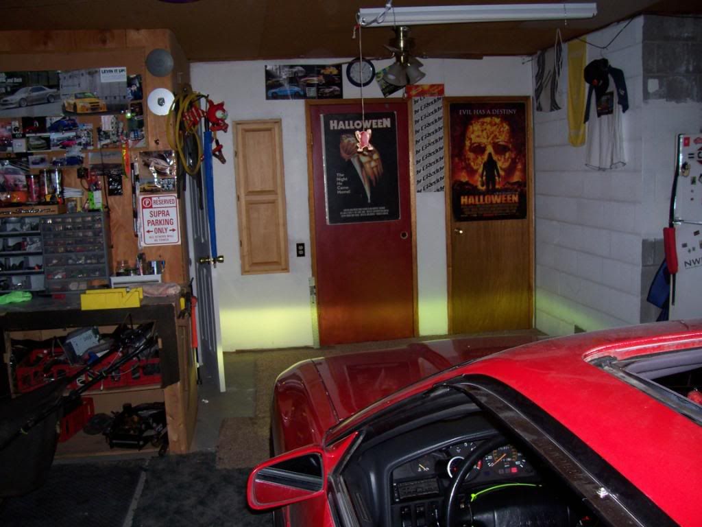

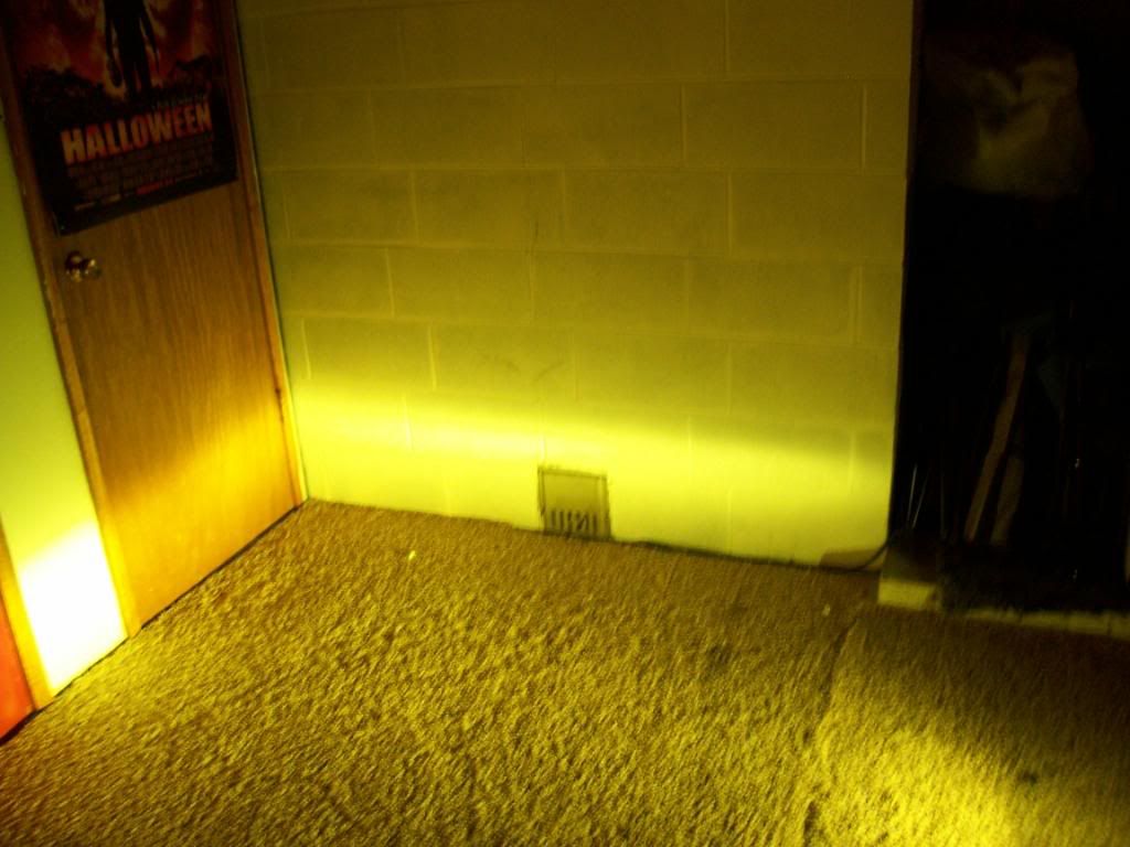

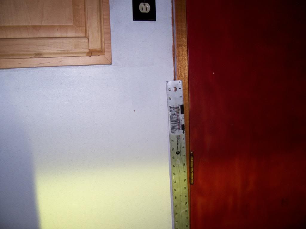

My HID fogs. Fog lights from a Toyota windom/ Lexus es300. I currently have 6000k lights I am switching to 3000k for closer to yellow . The cutoff is 14 inches above ground . Bright enough to drive without headlights. Not blinding to on coming traffic. I actually tested on dark back road with buddy being on coming traffic

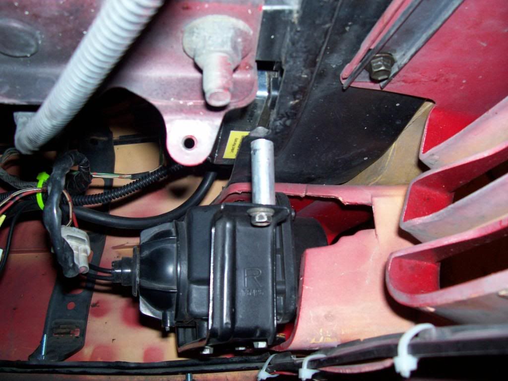

No, I think I might be the first one? There are a few better pictures in the foglight color thread.
http://www.supramania.com/forums/showthread.php?t=106018&highlight=foglight+color
It was fairly easy actually.
1. disassemble brackets and swap sides. ( if you notice in my pic the right had bracket is holding the left hand light)
2 take fog light assembley and rotate 180 degrees and redrill the three mounting holes
3 Get a piece of thin walled pipe ( I used aluminum form Home Depot). them make a spacer to mount the fog light housing to the stock location on the inboard side and to the farthest hole on the outside edge of the bumper support ( faily evident when actually looking at support)
4 trim off the tab that may interfer with your fog light openings.
5 you may have to cut a slot in the outboard mounting hole to allow for in and out adjustment
6 mount it up for a test fit and adjust as needed.
If enough people want/need a better write up with pics I will go a head and tear it all down and document.

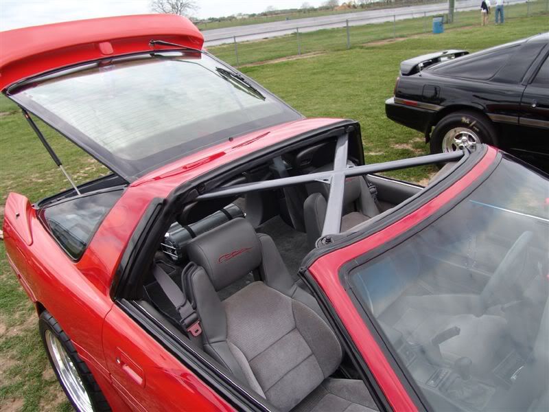

Full time Targa Bar:

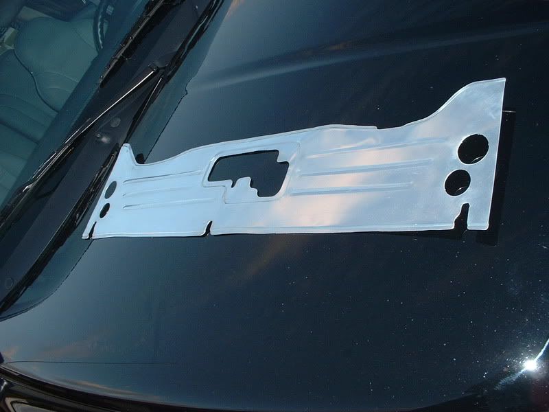

Custom made Intercooler Plate:
