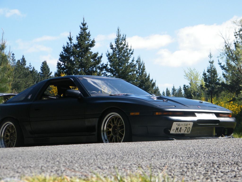

Mytmk3 did the complete widebody from shine.

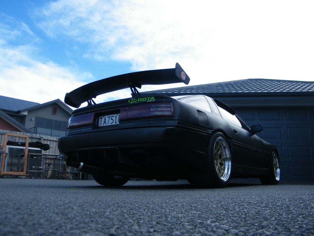

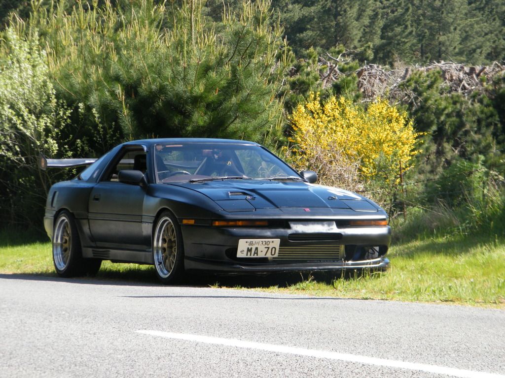

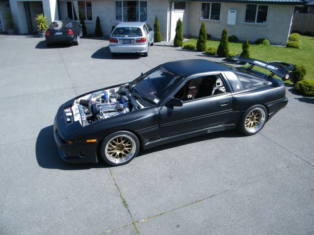

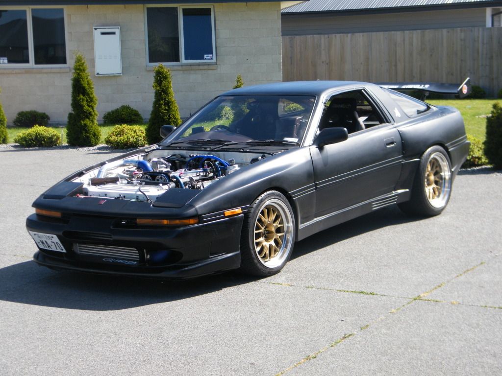

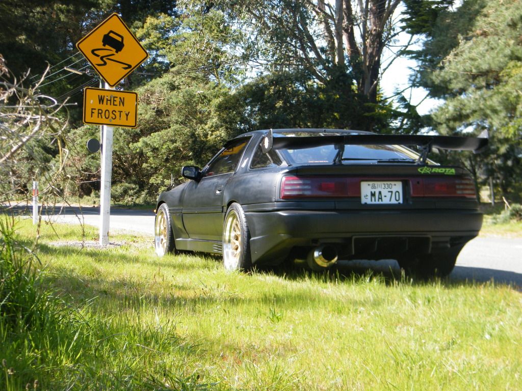

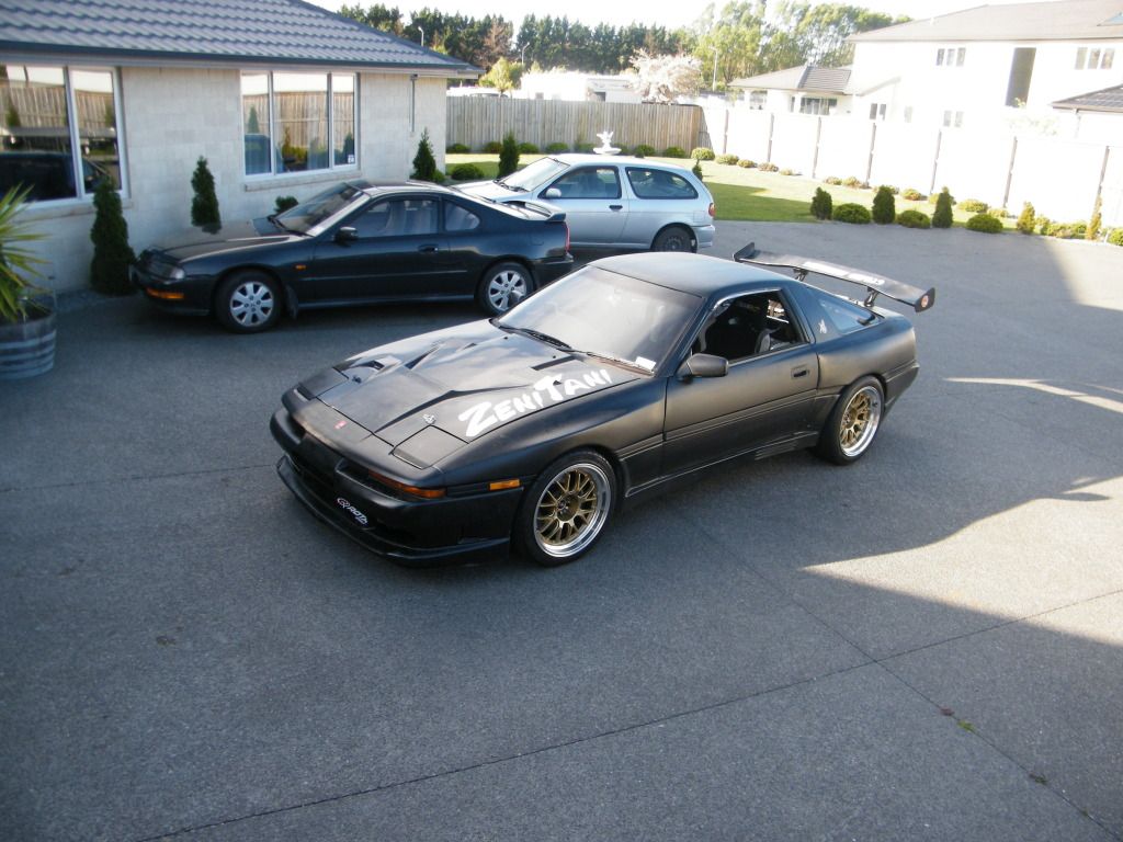

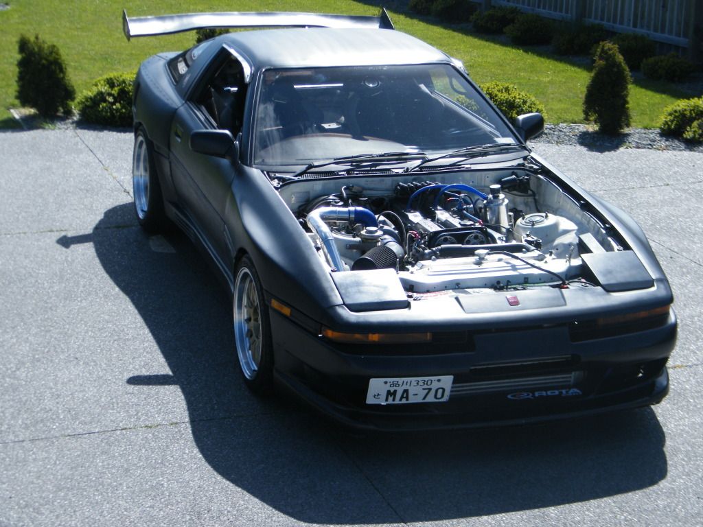

mytmk3;1883117 said:
Cheers :) Yea It certainly gets attention most people really like it wheels are 18x10 +12 265/35/18 front 18x11 +8 295/35/18 rears
Thank you for sharing the specs. What's the name of the wheels?
mytmk3
Oct 16, 2007
643
christchurch
wheels are ROTA MXR still cant afford 3 piece :) should add thats the actual wheels specs I don't run any spacers and they have Heaps of brake clearance.
If I wanted to I could probably fit 285 up front (will rub on the inner body may need a mini tub or use my clearance mallet) and 315's on the rear I have about -2 degrees camber on the rear at the moment which Ill try pull back to -1 or -1.5 if I can probly need to raise it a little though as I needed the camber on my previous wheels
Thanks again, for providing the name. The wheels look good. Arent these your second set of rota's since you went widebody? You're one more set of rotas away from being able to afford multi piece wheels. =)
