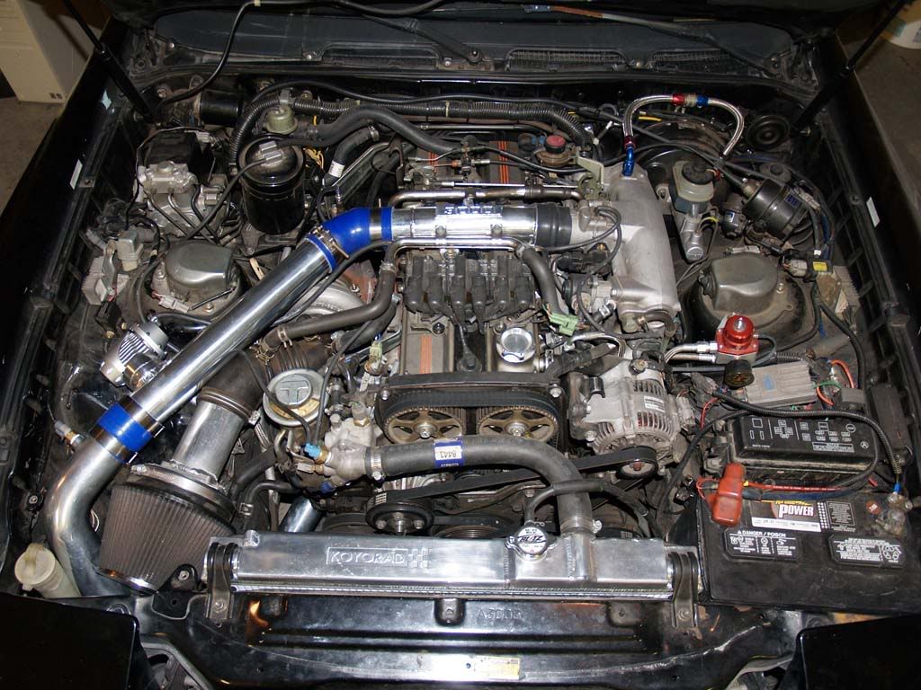

I'm running the Maft Pro in Speed Density Mode. All connections have been checked so many times that I know them by heart!
My IC setup is pretty standard. 2.5" Aluminum Pipe with a Driftmotion Spearco Replica. I am running electric fans and have them set to trigger just above the thermostat temp.
20G Turbo.
As you can see in the graph below, the MAT's just about double in this 3rd gear pull from 2k on up. This is basically how it looks in every pull.
It was approximately 48* at the time of this pull.

A bigger intercooler is a thought. I was hoping to avoid that. What I don’t understand is how the temps can be so high with the location of my AIT. I purposely put it there to avoid heat soak. How can the air charge be that hot coming right out of the intercooler?!
Maybe I should start selling roasted chickens on the corner! :biglaugh:
Once the tune is stable I’m going to inject water/meth; but, I don’t want to bandaid a problem/issue with that. My next thought is that the AIT Sensor may be bad. The problem is that there isn’t anyone in my area that has one I can borrow. :(

I've seen other people's logs where the temp increase was ~17-20 degrees as opposed to my ~45 degree increase. They were running VERY similar setups.

~45* ambient temperature. ~33* windchill temp. Underhood temp at AIT Sensor ~58*. How in the world do I end up at ~99* at the AIT Sensor on a single 3rd Gear pull?
I don't know. I just don't see it.
Maybe some other Maft Pro guys will chime in because it just doesn't add up for me.

Driving in Vegas I was seeing 150-160 intake temps just cruising around, so this isn't bad. Admittedly, ambient temps were a whole lot higher!
Is this on the street, or on a dyno? Looks like your setup is probably sucking in a whole lot of air that's been through the IC / Radiator.
