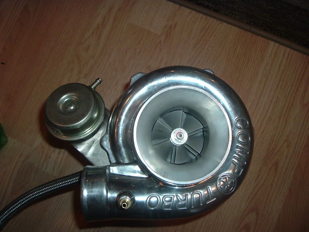

and pray for no ::bhg::
(Boss SR. stage 5, gts61, triple ceramic ball bearing, polished. IIRC )
