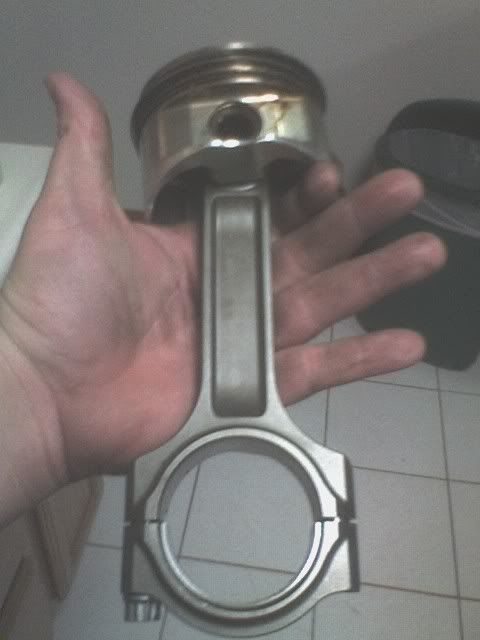

soon i will post pics up of stock, eagle, pauter and crower rods. i get the pauters in a week:icon_bigg
just a pic of the crower rods for now

gotta love those x-beams....
