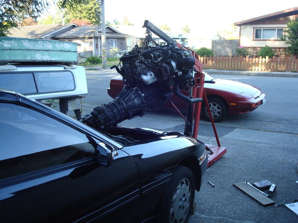

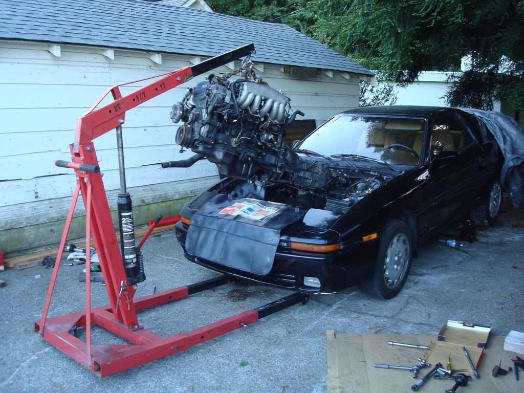

well...............if you lift the front of the car that means you have to get the engine even higher in the air. compared to if you left it level or jacked up the back. when using a cherry picker you have to keep in mind it only goes SO HIGH. that is why i jack up the back of the car. it lowers the front.
here you can see when i last drop my motor in my new sup. all i had to was slightly lower the motor until it was just above the core support. then go forward. lower little. go foward. lower little. jacking up the back brings the tranny tunnel to a bett angle to get the motor in compared to being level. that is how i was taught.
but doing it with a chain hosit thing isn't exactly the most ideal tool. so things aren't going to work the same
