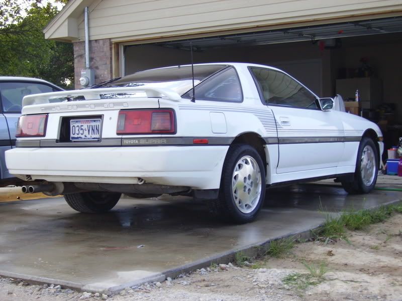

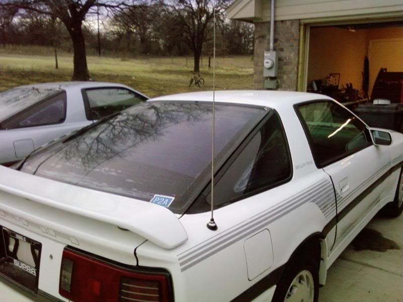

Well I accomplished what I sat out to do today plus one. I got the inner fender well and mudflap back on. I started to mess with starter but just didn't feel like getting underneath the car this evening. I absolutely hate doing that. So I decided to install this new antenna I got for the car. It's not electric but looks so much better than that short black rubber thing that was on there.
Before with old crappy antenna
Today with new not so crappy antenna, and it's retractable too.

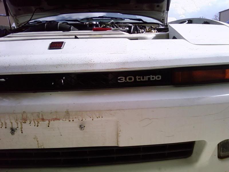

Oh I did this today also. Also you can see the pitiful condition of my bumper and header panel. Let me get it running good and then bodywork will begin.
