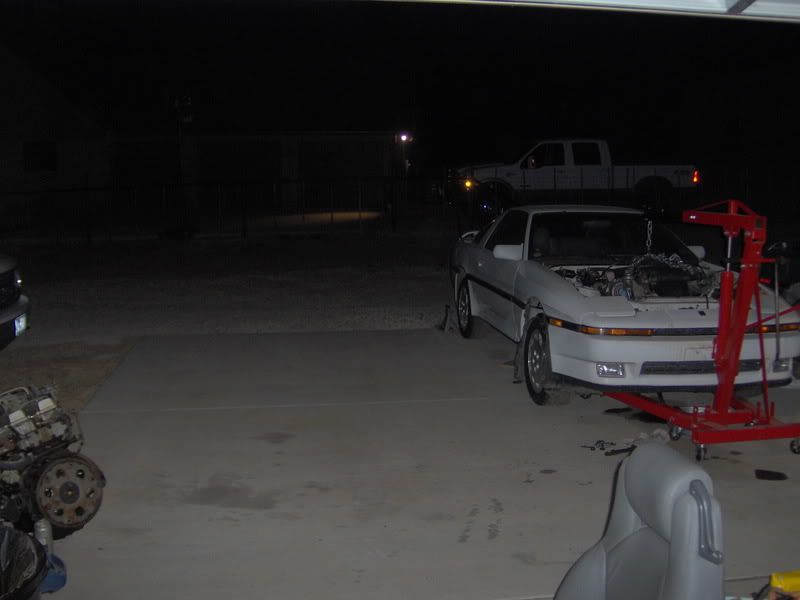

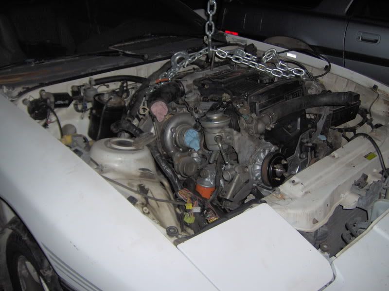

GTE engine hanging from chain inside engine bay. Can't get those mo fo mounts to line up.
Notice GE egine sitting on driveway. I'm so white trash. :biglaugh:

Ken, You might want to try raising the motor back up and attaching the motor mounts to the motor, and try to sit it back down like that. Also, support it with a jack from underneath, and adjust your chain to tilt the motor how you need it. Sometimes getting it where it goes by yourself is a pain in the ass.
Zumtizzle
Can't Wait to Be King.
Oct 21, 2006
2,825
Sac-Town, NorCal
Jack up the back of the car, get it on jack stands in the rear, and blocks on the front wheels. Use a jack to jack the trans up to the mount and bolt her down. mounts will be lined up at that point. Good luck!

Already did most of what you said. I will do that with the mounts tomorrow.
Did it!:icon_bigg Didn't work. You know one of the problems I'm having also is the chain where it hooks on that hook at the back of the head. It keeps butting up against the firewall. I'll get it figured out somehow. I really hate leaving the motor hanging from the chain for this long (I'm a work). Worries me.
5
you really need a load leveler to pull the engine easily...
ah, somebody already said it, but PULL THE MOUNTS. The mounts should stay attached to the engine, not the chassis as in the chassis they are slots and allow easy drop in...
To pull em, get under the car and there is a hole behind the lower control arm to get access to em with a ratchet and extension. I know this means pulling the engine back out, but it will make life easier...
That is my plan for tomorrow, although I don't think I'll have to pull the motor back out. I'll just jack it up some more. I was also going to stop and look at getting a load leveler too. The motor came right out no problems, it's just being a bitch now.

Well, let's see. I've had an eventful day. I took Scott's advice about the motor mounts and it worked. I got that beeeotch in there. And may I add, All BY MYSELF. Zero help. I had to manhandle it a little but it's in there.
I accomplished this today.
Put transmission mount back on.
Plugged speedometer cable back in.
Tightened down the motor mounts.
Got the power steering pump on-I need to go redneck on my hoses to the reservoir though and do some cutting.
Hooked up the fuel lines.
Pushed the wiring harness back through the firewall and plugged in the ECU and HAC, gonna need some pictures of somebody's 'cause I can't figure out how the ecu and hac mount up.
Hooked up power brake booster.
Connected vacuum lines.
Replaced some big amp fuses in the fuse block and then swapped out the ignitor and resistor pack.
Reconnected manifolds to a/c compressor.
Put the belts on, but did not put tension on them. I need to switch fan clutches first.
I know it's dirty but I do plan on cleaning up nicely.
What I plan on doing tomorrow if I don't get called in to go fly.
Clean out the oil cooler and metal lines then install. Go find some hose for the oil cooler. That's gonna be fun putting that on.
Hook up power steering hoses to reservoir.
Figure out and install IC and piping.
Most important! Go buy some oil, powers steering and transmission fluid.
Try to figure out where all those extra bolts go.:dunno:
I do have some questions for yall. My cruise control, and accelerator cable seem too long while the transmission kickdown seems to short. Do I need to switch the cruise and throttle cable from my 87 turbo?
I've got a manual tranny throttle body on there that has been ghetto fabbed for a kickdown cable. I've also got a good auto throttle body that I got after the engine was put together and don't really want to have to swap them out unless it's absolutely necessary.
