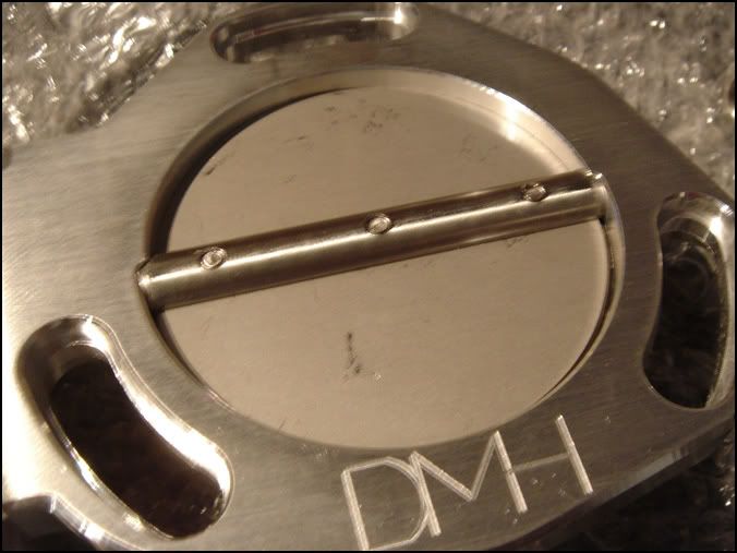

DMH 3" Electric Cutout
I bought from DMH because of their 4 year warranty.
I'm thinking its gonna go in the test pipe spot. Just gotta get some flanges on it.

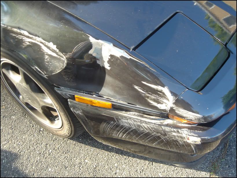

..and so then i got hit by truck
Yeah, was pretty pissed about that especially with the whole painting the car thing.
Insurance called it totalled..and gave me a bunch of money. That's sad really :(

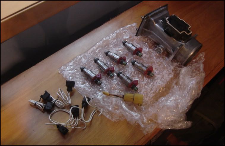

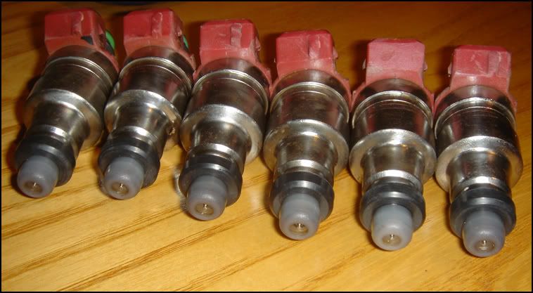

Lexus AFM, RX7 Turbo 550cc Injectors
Had them checked, flowed, and got new caps and rings. The guy said they overflowed his machine and was warning me of overfueling, but they were consistent ;) Ill take it. Many of you probably read about this already..

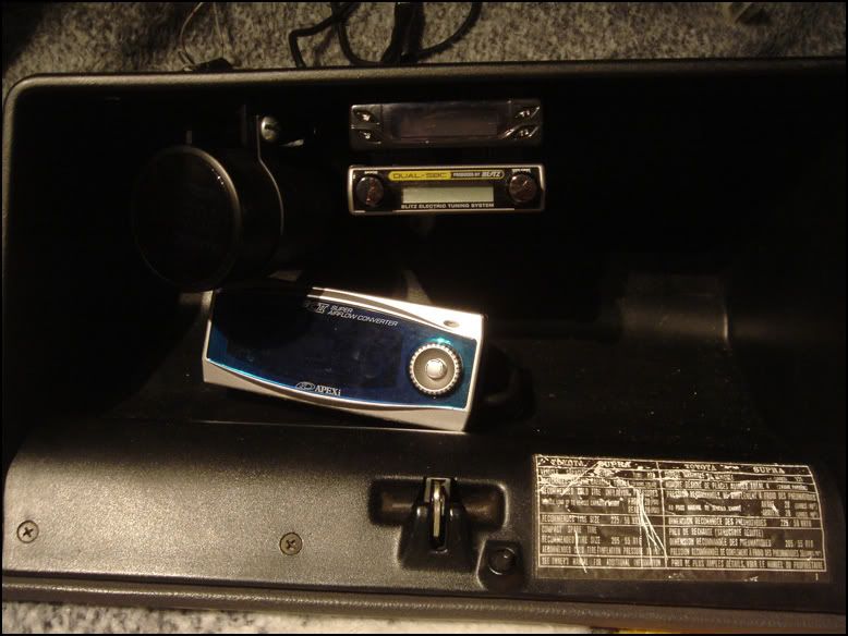

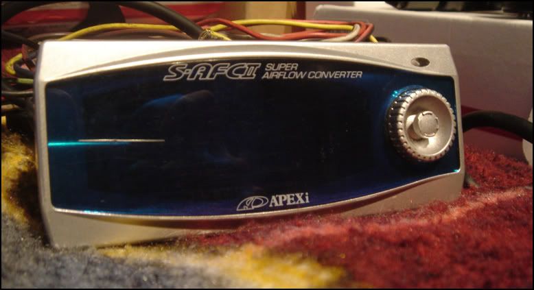

SAFC2

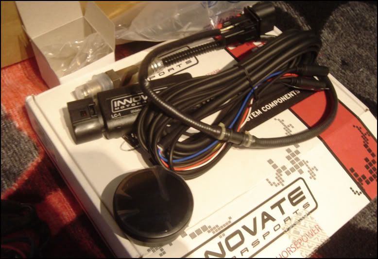

Innovate LC-1 Wideband

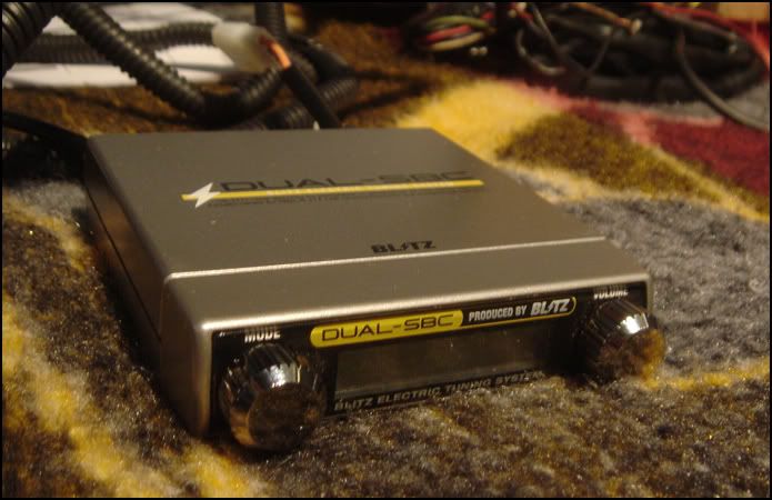

Blitz SBC
Concealed Installation!
Set it and forget it. That's what i'm about, that's why it's in the glovebox.

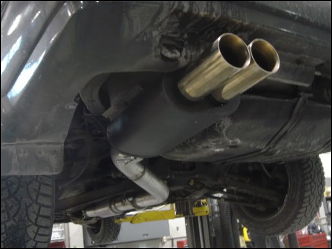

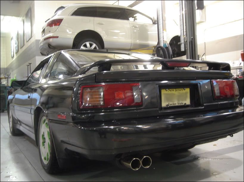

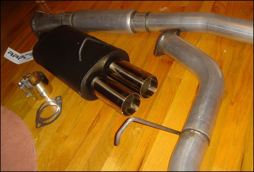

I got rid of the RSR. Got a Raptor Racing 3" catback.

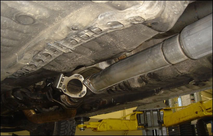

Exhaust Cutout

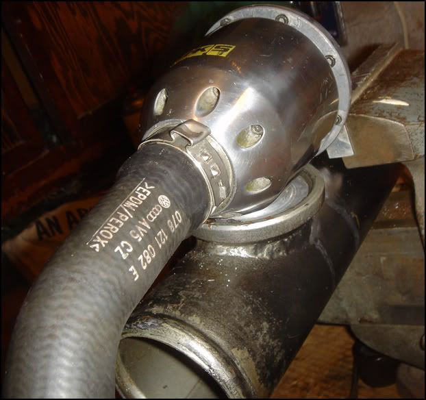

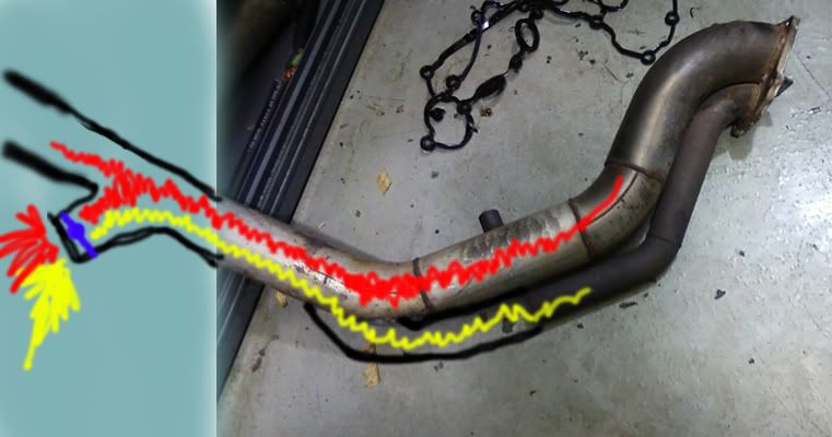

I have my HKS 3" downpipe on now. I'm going to recirculate my DDP before i install it back on the car.. as well as bore out the wastegate hole a couple MMs.
My interpretation from another thread..

Installed
Clean and almost-Stock Look. I dig it.

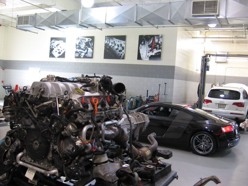

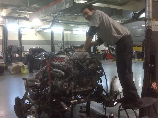

See that Q7 on my lift? Yeah, it was there for a while.
Here's me doing a shortblock. :nuts:
but that's a whole thread by itself..
i just think this is a cool picture :p

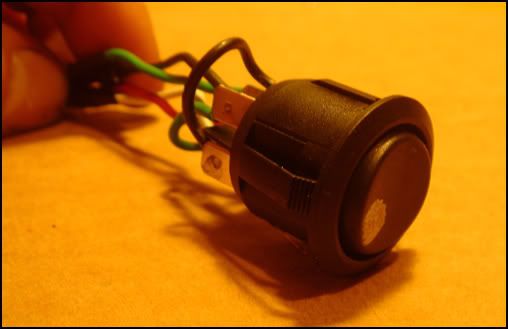

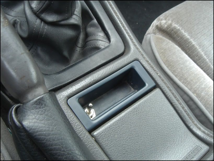

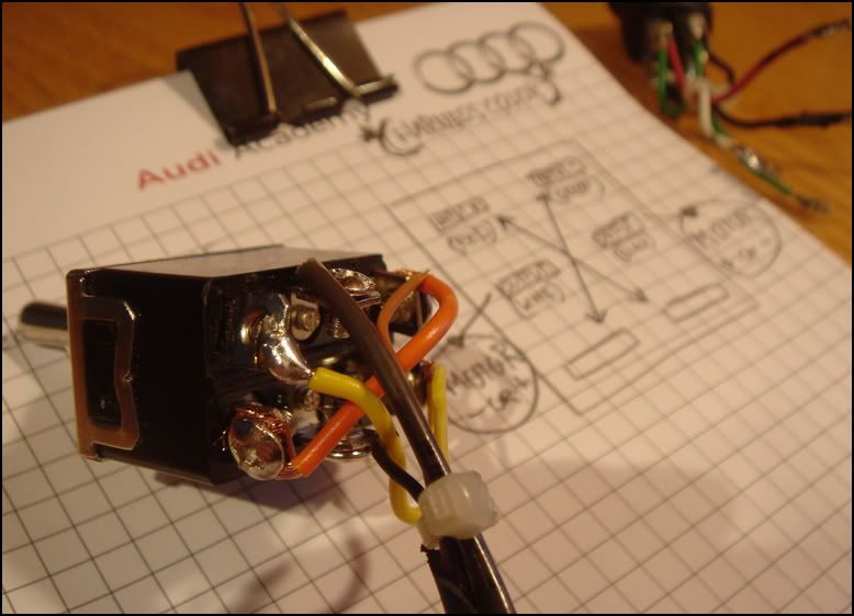

The cutout came with this switch. I didn't like this switch.
theKnifeArtist
Fire on High!
Apr 6, 2006
2,332
North Jersey
I wired up a better switch.
I was going to put the new style switch in the useless coin tray next to the fog light switch but found it to be much more comfortable elsewhere.

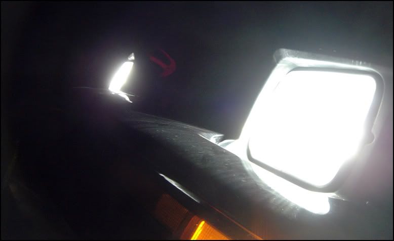

HIDs installed in Hella Housings.

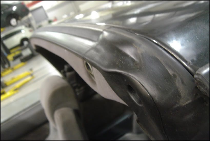

Brand New targa seals installed.

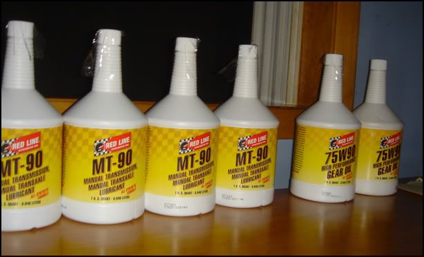

Redline for the Trans and the Rear

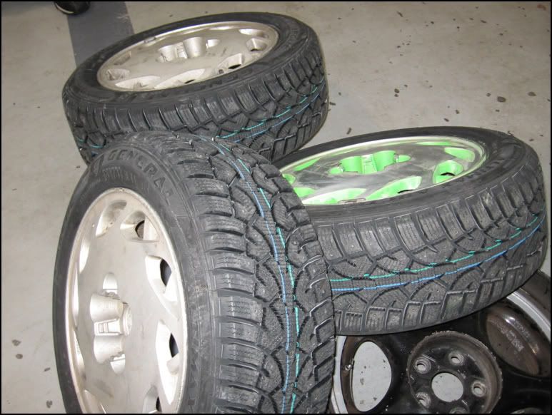

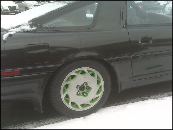

Studdable Snow Tires
simply amazing in the snow :icon_bigg
Snow Tires Installed
Why are they green? They were allll green, that's all i could get off before the storm hit..

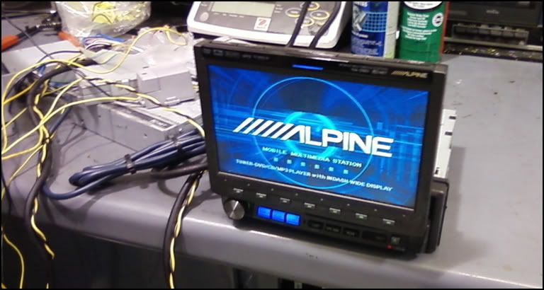

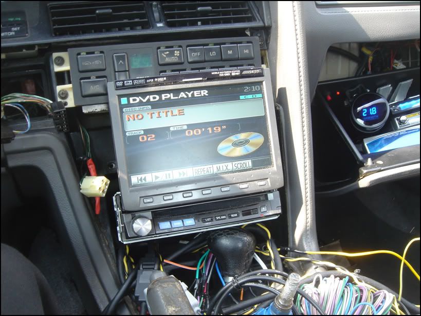

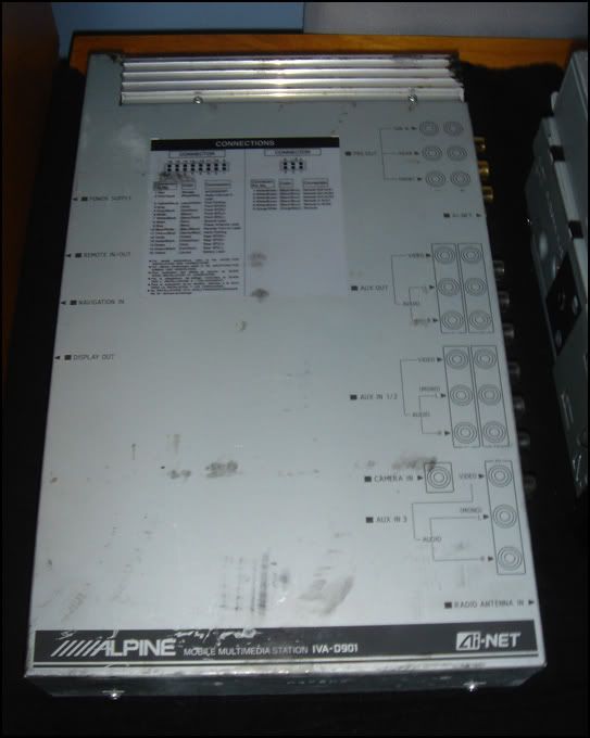

So i would probably never buy a fancy flip out radio/dvd player/amp/ipod interface shebang...but you can't beat scoring one for twenty bucks:naughty:
Amp

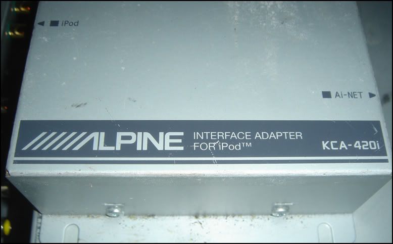

iPod interface?! SOLD.
Got a toyota radio harness for it and mocked it up for now..

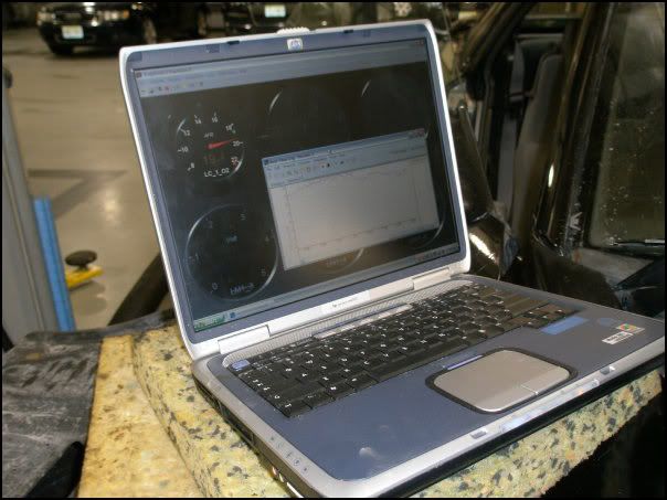

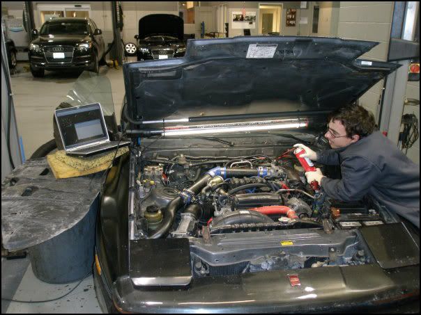

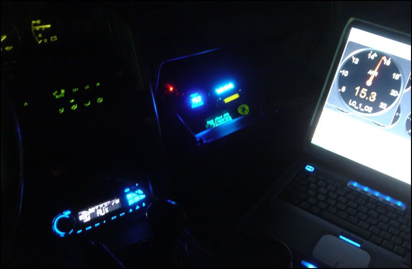

So my car ran like shit for a while and the AFRs were alll wrong.
In Diagnostic Mode
Spraying around with carb cleaner and reading the AFR..worked good.
but the smoke tester worked better..
Intake manifold gasket blown in several places.
Took care for the intake gasket another night at the shop. Runs great now :)

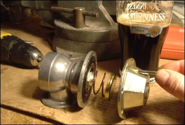

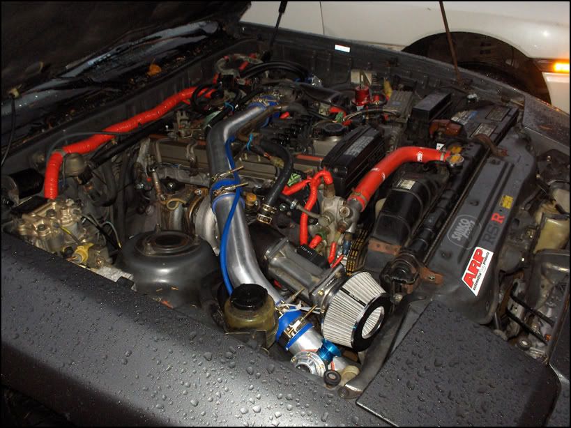

Took apart cleaned, and lubed my HKS SSQVizzle.
It works better after my service :cool:
Recirc!
Runs better, sounds different and quieter. I'd say its more intimidating now :biglaugh:

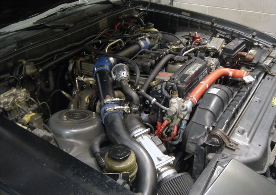

AFTER

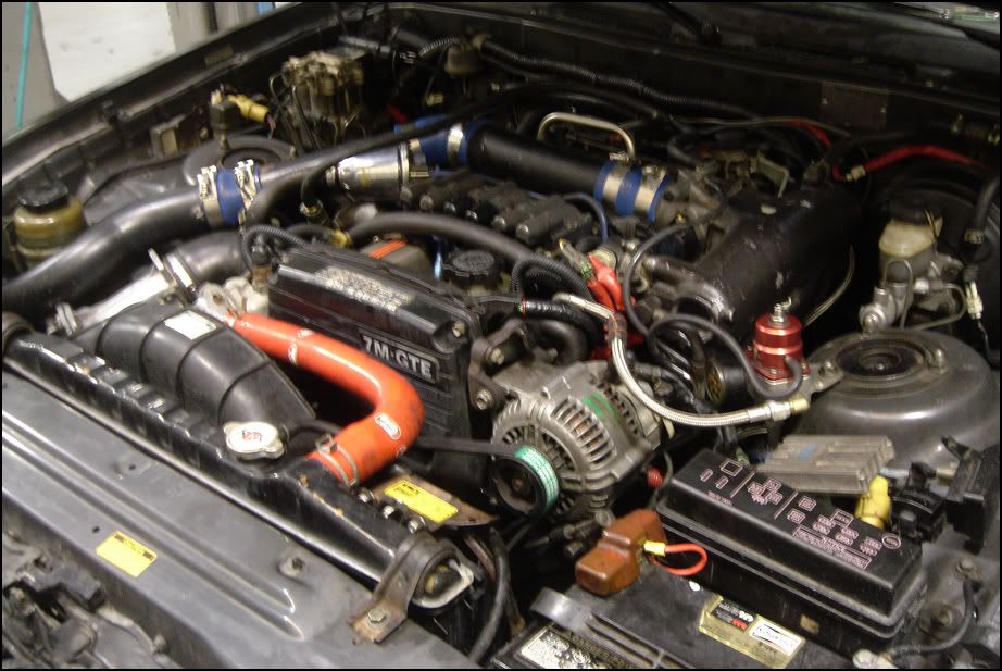

Got my bay looking more like..well..my bay.
Still a little bit of red wiring harness tape to cover up but it's come a long way.:icon_razz
All that i need to do now is get it dyno tuned.
Then i can focus on everything else..

how'd you recirculate it? I have a recirculating tip that fits a 1" ID hose, but it won't plug into the accordian pipe. Did you get an adapter? if so, from where..?
she's looking great though, no doubt about it..!
theKnifeArtist
Fire on High!
Apr 6, 2006
2,332
North Jersey
thanks guys!
RazoE- i have a recirculation adapter on the hks doodad.
That goes to my recirc hose which is a 1.8T coolant hose. hehe, perfect bend!. Inside diameter is just a little smaller.
That fits onto the metal cylinder in the accordian pipe port... I would rather use the one closer to the turbo, but i couldn't make the bend.
The hose is slightly larger than the port so i had to get it over the rubber and clamp it.
I would like to get a reducing adapter to make it a better fit..once i find one laying around..
Sawbladz
Mar 14, 2006
1,727
Oshawa, ON, CA
I'd look into rerouting that fuel line. Little too close to the alternator for my liking. Other than that its looking great.

theKnifeArtist;1536726 said:
thanks guys!
nice..! I need a 25mm to 20mm adapter (or 1"-7/8-ish for us) to fit into my accordian pipe. But the only ones I can find are plastic aquarium reducers in the UK...:(
