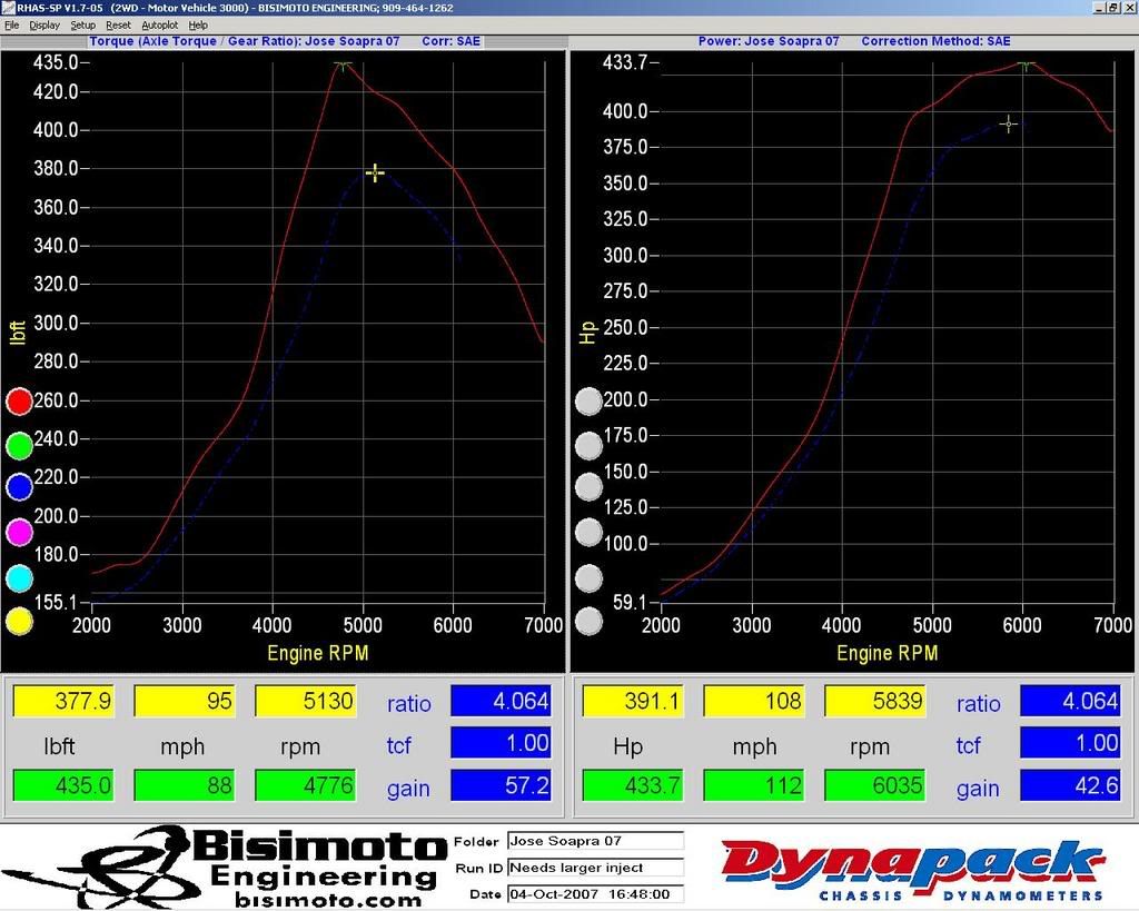

Doward said:
Loss of torque. Increase of revability, stock.
HP and torque on the yellow boxes are with low compression on two cylinders. HP and torque in the green are with a helthy engine. Same mods two different engines. The lower HP engine had detonated and took two cylinders with it. faulty fuel pump is to blame. No torque claims are stupid. I drive my car every day at 19 psi making that much power with magical torque. This is not bad for an otherwise internally stock engine with "high miles" I would like to see a 7M come from japan unopened and internally stock do that for over three years!
