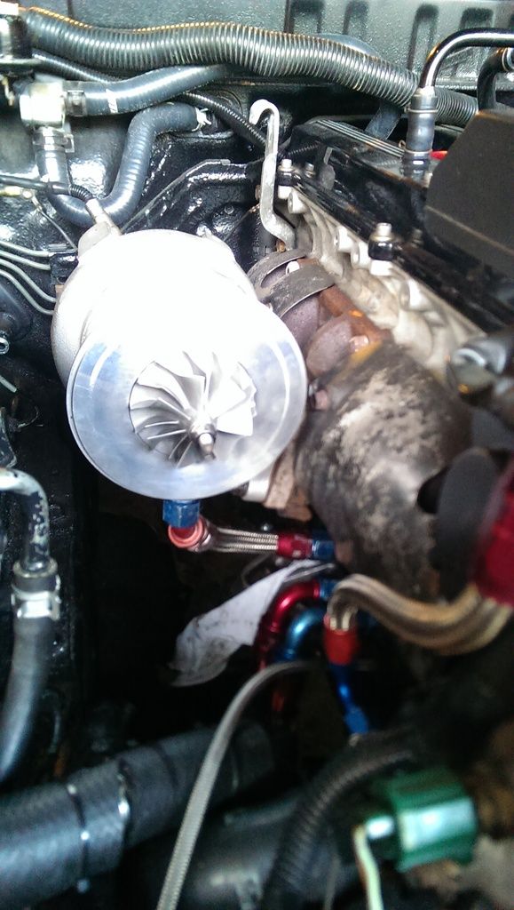

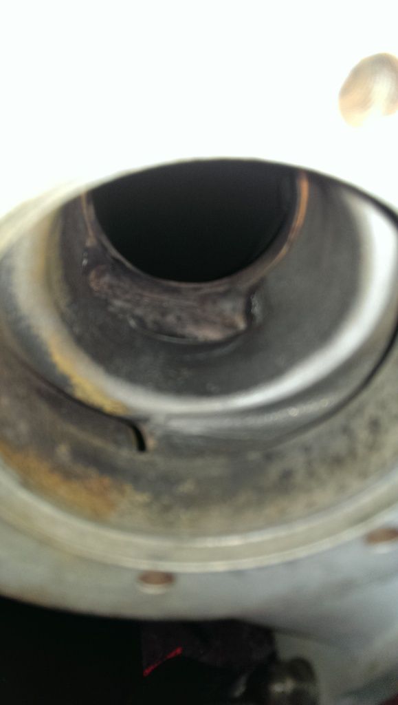

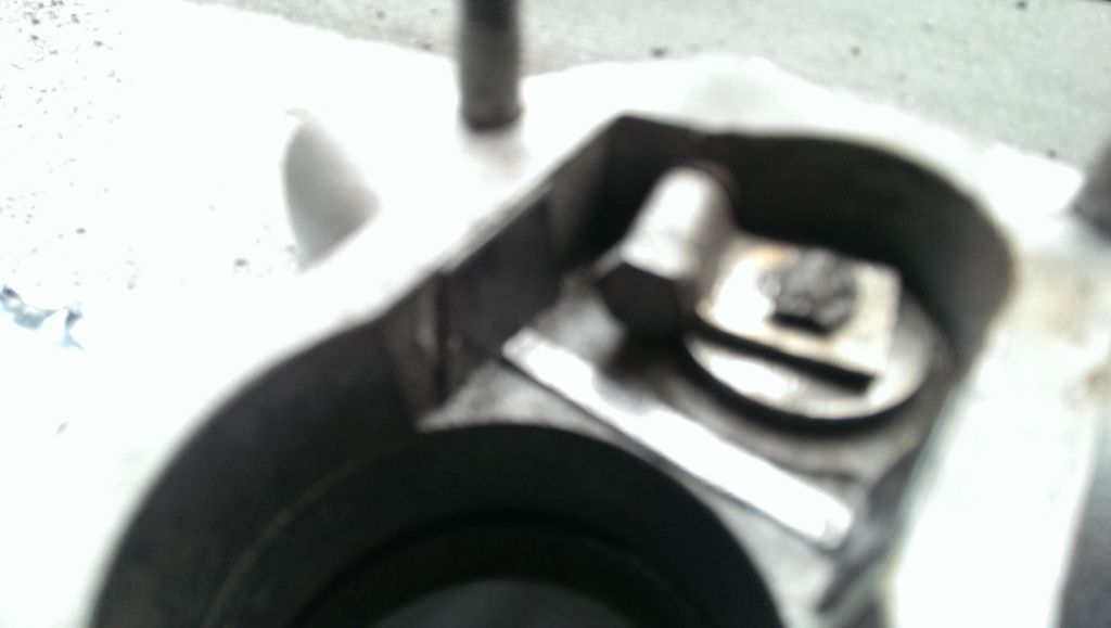

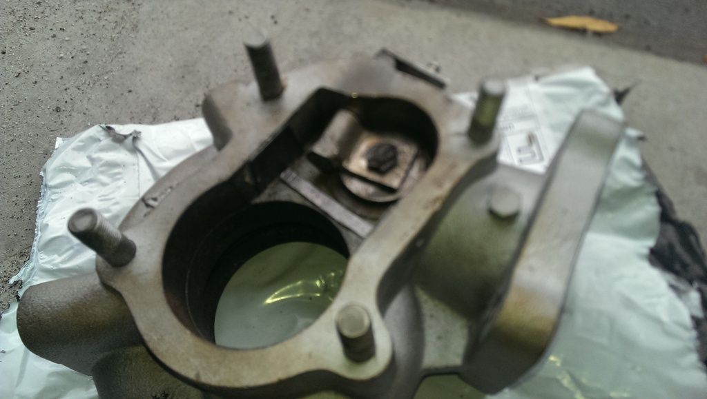

Finally started putting my rebuilt hifi turbo back on. Turbo Lab did a great job on the wastegate flapper mod. I can't wait to try it out.
I decided to try and fill the .5mm gap between the hot side and the ddp by gluing hi-temp gasket material to the mating points. I used 2000F exhaust putty as the glue and a cut up egr gasket off of a Jeep engine. As long as it doesn't burn away I think it'll be perfect. It completely sealed the gap when installed from what I can see.
Sorry for the blurry pics, but I dropped my camera phone an it royally screwed up the auto-focus sensor.
Also fabbed a new coolant bypass line since I switched from a wet to dry bearing housing. Then I redid the oil drain line to make sure there were absolutely no kinks in it at all.

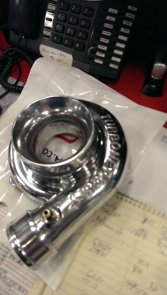

Now all that's left is to install this beautifully polished cover and the wastegate actuator and this baby is back in business! Beeeotch!!!
Hey is that the suprasport 60 trim from turbonetics? I have one and it looks just like that I was going to have albert rebuild it for me.
MarkIII4Me
Project OVERKILL!!!
Apr 10, 2005
1,250
Charleston, SC
This is the HPF Turbonetics 62-1 HiFi with Stage 5 Turbine and 4" inlet on cover. I previously had a SupraSport 60-1 Stage 3 with 3" inlet (what all SS turbo's had). SS had the Turbonetics hotside copied and cast down in Mexico. Had the same (if not worse) jamming waste-gate flapper issue. Turbonetics apparently originally stole the hotside design from the HKS' Sport Bolt-on, but offered more A/R and trim options.
