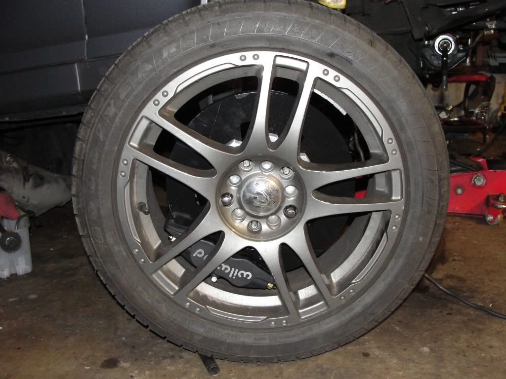

You will need a minimum of 17" rims to clear the ARZ kit (and even then not all rims will clear due to the calipers being HUGE!)

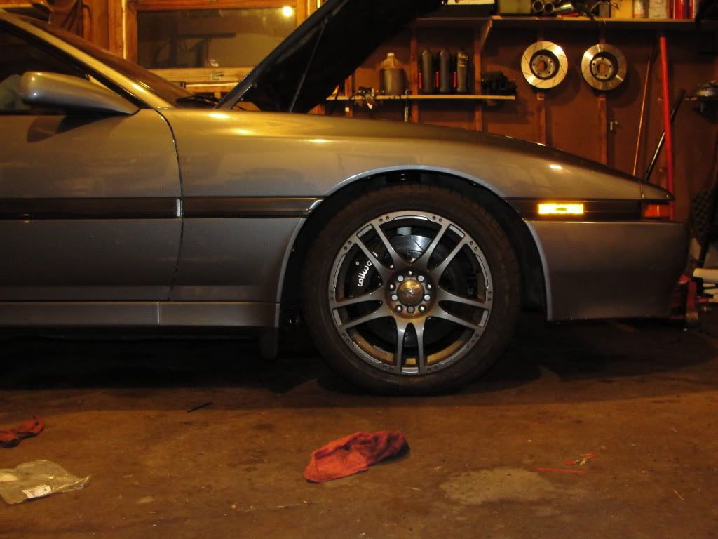

Here's a set of ICW 17x7 (offset +40) rims that cleared wth no problems
EDIT: oops, wrong pic x.x

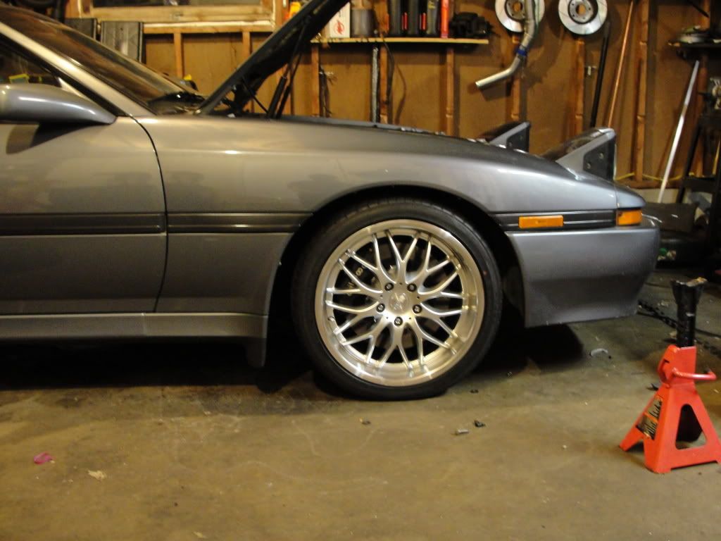

And my new rims which are 18x8 (offset +38) that did not clear until I got 10mm spacers
(not te greatst view of the brakes, I know
That said, I <3 my ARZ brakes!

^^^ Looking good !!!
I had to use the precision shims supplied with the kit to move my calipers slightly outboard in order to get them to center on the rotors properly.
as a consequence my work equips only just clear. Its a pretty good look.
