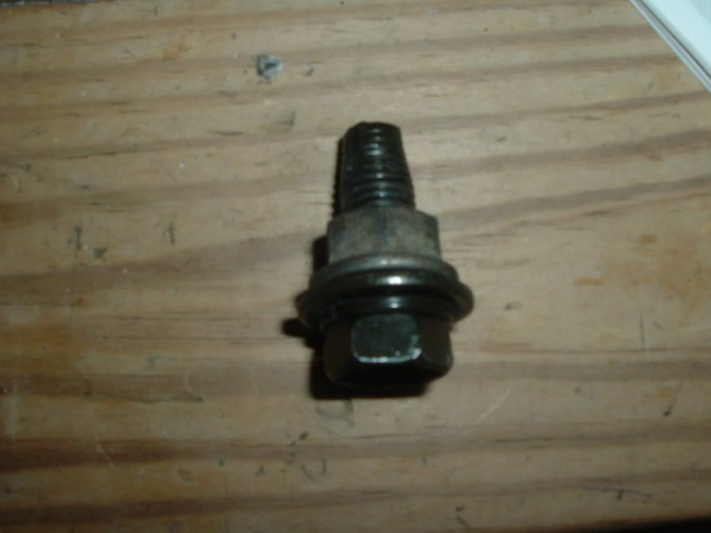

Also re seal your plugs (4 of them) in the 3rd cover area. The 14mm head hex head plugs in the spark plug area for your head. Remove them and re seal them up.

92nsx is right, reseal those plugs too, just get a 14mm allen socket and some FIPG.

airhead04;1421496 said:
Got the oil out. Most of it anyways, and attempted to get the 4 screws out. But I had no luck with that. Car no longer miss fires anymore.
You couldn't get them out, really! There only torqued down to like 20-30 ft/lbs if that.
Also this is a screw
And this is a plug

I got the screws off for the valve covers if thats what you mean.
But the for that I have to use an allen key for, that are in the center, I couldnt get loose. You sure they are at 22 lbs bc thats only like hand tight. And I was putting body weight into it and couldnt get them to budge.

Yep Im sure. There only in alum. ;) and yep it is a allen heard.
BTW this is what I used to get them out. Oldest trick in the book if you dont have a 14mm allen key.
Just grab a extra 14mm head bold and nut and tighten them together and presto, you can use you ratchet to get them in and out.
and 20-30 inch lbs is hand tight maybe a little more. Not ft. lbs

airhead04;1421584 said:
Lol, thats actually what I was using, the bolt trick. But they are in there WAY tighter than what they are suppose to be then. Which isnt good.
YES they are way TO tight.
Just looked it up on TSRM and they only need 13 ft/lbs :aigo:
http://www.cygnusx1.net/Supra/Library/TSRM/MK3/manual.aspx?S=EM&P=55
bottom of page.
Sorry dont know what to tell you then. Risk stripping them out or fix a source of oil leak. Mine leaked once I had mine rebuilt, but I just had to re-seal them.
