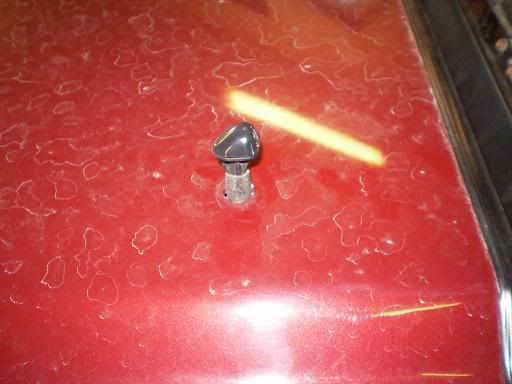

Does anyone have any good close up pics of the 88 and 89 nozzles? I'm not sure which my car has (I believe my hood was replaced at some point, and the 88 hood part number changes up to the 89 hood with the new nozzles.)

these are 89:

cre, don't feel like takin mine off tonight. maybe tomorrow.

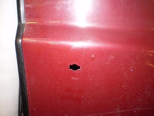

Not to threadjack, but is there info somewhere on how to remove the damn things in the first place? I've never really been able to get as good a look at 'em as I'd like and I want to have some clue what I'm doing before I try taking them off to clean/replace. I'd rather not end up breaking something. Anyway, all my searches turn up nothing so if there IS some kind of info out there.. a point in the right direction would be appreciated.
Probably too late now, but I found this thread looking for the same advice!
I used needle nose pliers to gently squeeze the tabs at the front and rear (think front and rear of hood) of the nozzles. It helps to go in from a bit of an angle so you don't damage the part of the nozzle that connects to the feed hoses.
Whilst squeezing those tabs try gently pushing up. If nothing happens then squeeze the tabs with a bit more pressure and try gently pushing up again.
Once you have enough pressure on the tabs the nozzle will come out of the top of the hood with no resistance. Release the pliers and celebrate!
Just a word of warning, depending on age the nozzles can be very brittle. A lot of plastic came off of one of mine just when I pulled the feed hose off. So cover the engine before removing these if you have anything open.
