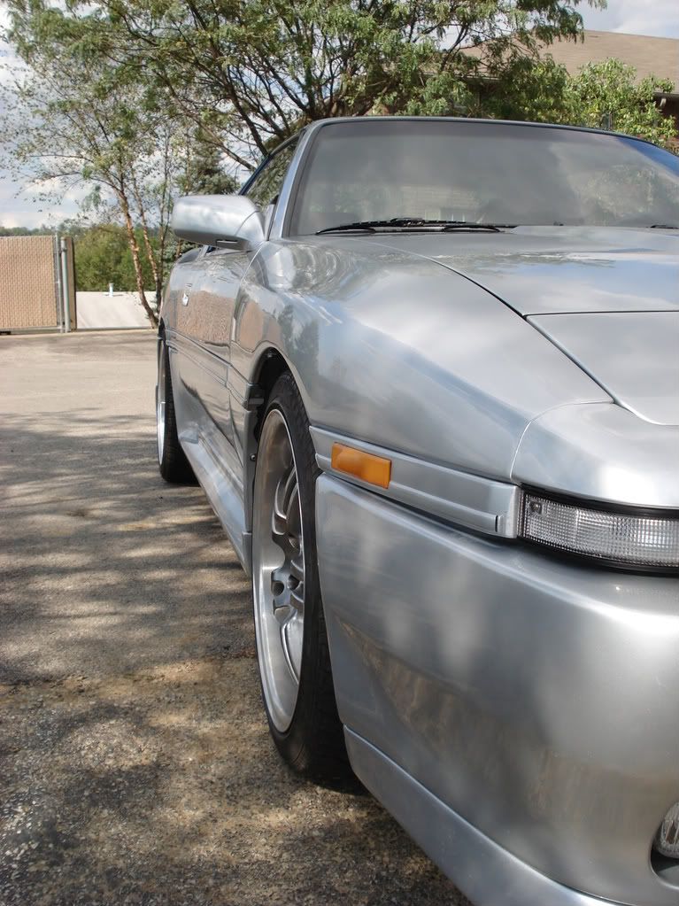

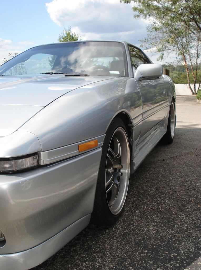

You could always go to a body/glass shop and have them install the newer style of window trim, and do away with the current style of trim completely. I'll be doing this when I repaint my car.
Here's some pics from this thread, to show you what it looks like.
