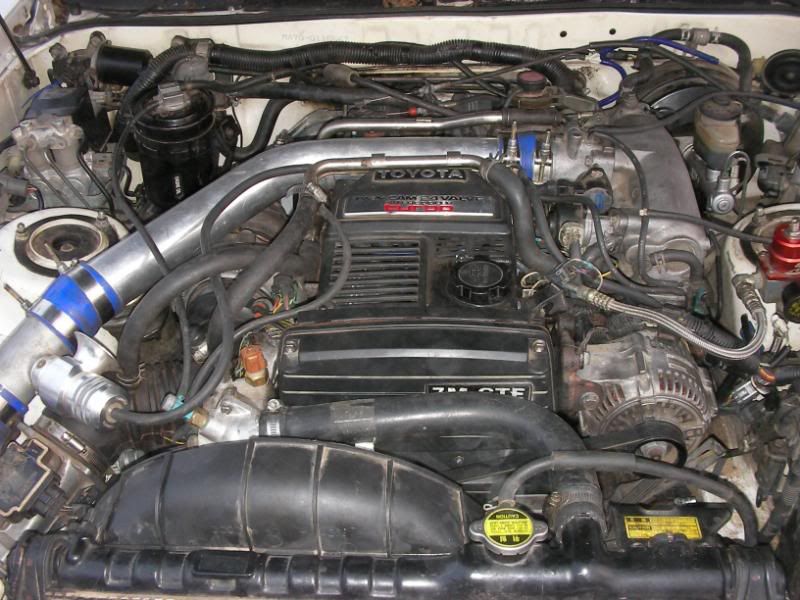

One picture of the motor in Vonda's car.
It's not a pretty motor, but we're hoping for more horsepower than what she had last time. I've still got to order her a downpipe, but I'm waiting to hear from Robert at 935motorsports first.
