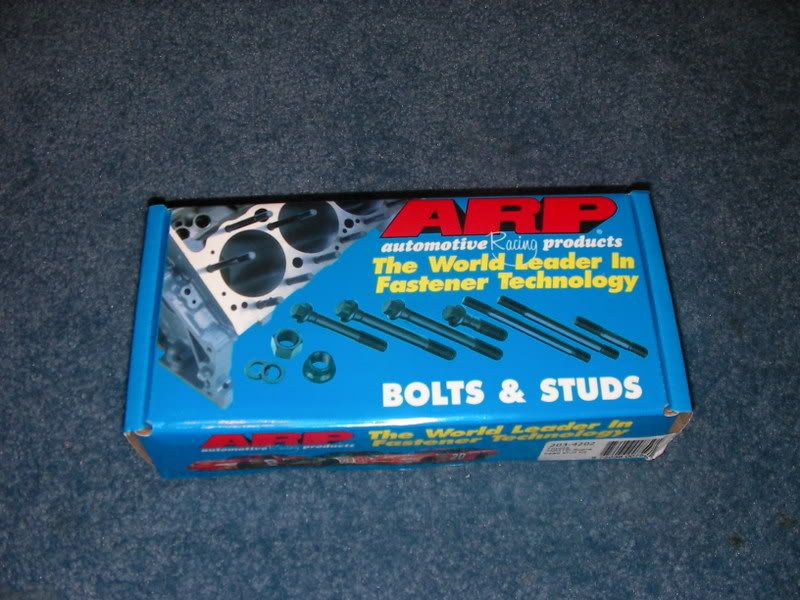

jugodegolf;906835 said:
gArreTT I likey. How bout them arp thingamagiggies that you tighten' down? Holds everything together?
George, I don't know that I have any thingamagiggies, but I do have a ARP stud kit.........................;)
