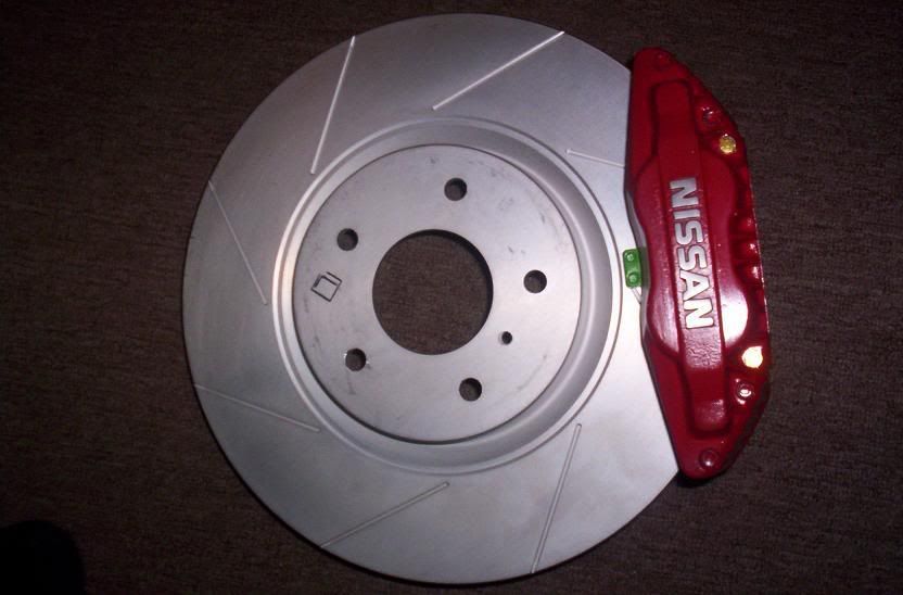

marc3
canadian blood
Jul 19, 2006
229
quebec,canada
they aren't installed yet, but very soon.in the meantime, here are the brackets installed(from silverlineracing)i, however, choose not to remove the nissan inscription. i know i will be:3d_frown:
the charcoal piece is the bracket!
wesbeech
Beech Performance Motorsports
Feb 26, 2006
1,022
Akron Ohio
What is the piston size?
