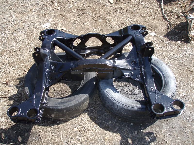

Update for today:
Fully painted, RK poly bushings installed. They're so easy to put in! On to the pics, click to enlarge:
Top Painted:
Underside still primed:
Finished painting:
Whatever these things are, LOL:
Old vs New bushings, for those who care:
New RK polys are in, and the subframe is ready to be put back together. Now if only the Toyota dealership would get my parts in! Haha.
Edit: I didn't put the steel sleeves in the new bushings, as I didn't want to lose them while I move it around. ;)

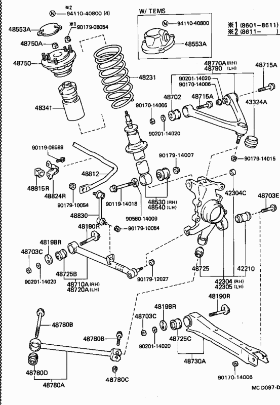

Today, not a whole lot, as I had other stuff to do, but I got some relatively difficult pieces out of my way:
Disassembled the rear hubs to press out the bushings in it. P/N's- 48725 and 42210 in This pic- as always, click to enalrge:
The pics of the aforementioned- one of them on each side was solid, the other (same on each side) was super-spongy. I can't believe I drove the car like that!
This is the super-spongy one. Both sides (can't remember which one it was) were like this. LOTS of play in them!
I fully disassembled the hubs to do this, as the dust shields got in the way on the press. It was much easier this way. I'm going to get new hub seals, and possibly new bearings, depending on their condition when I pull them out.
Here are the pics of some pretty new stuff- Brand new Toyota upper A-arms/ball joints, which you can only buy as a set. ;)
Tomorrow I'll likely order the new hub bearing seals, and pull the old ones and bearings. Then I get to clean and paint the hub, which should be fun.
Then, possibly Thursday, I'll be installing the 6/6 nylon bushings in the rear upper A-arms, as well as a few other bits and pieces, and some painting.
