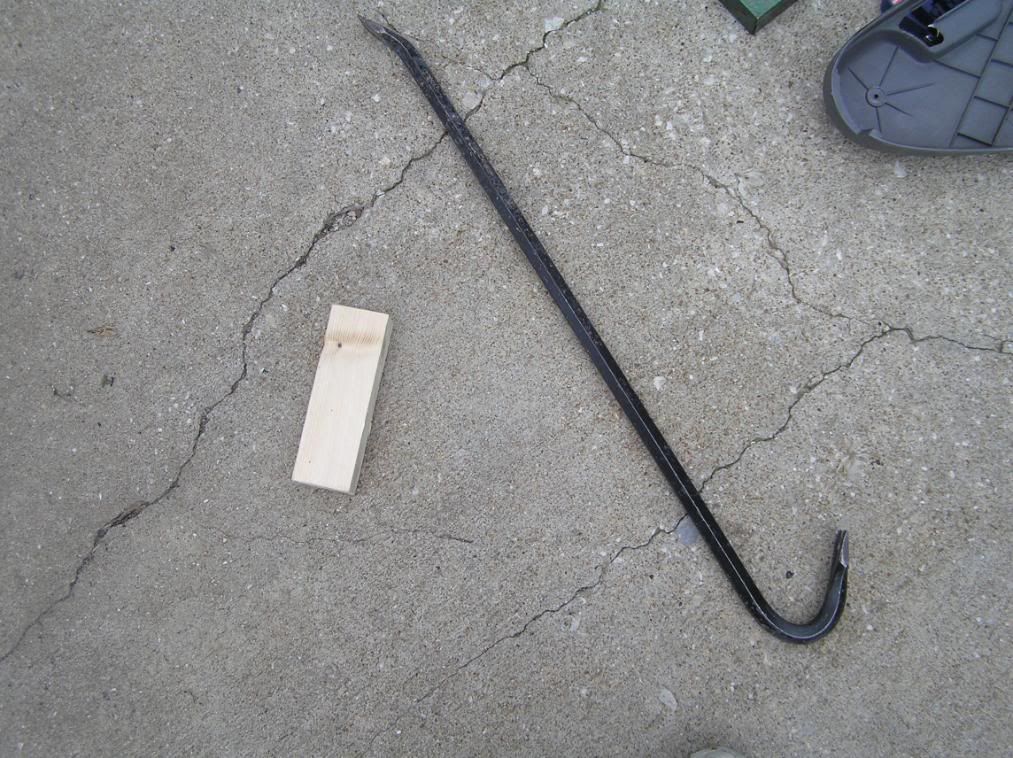

I've had to do this before. The motor had died and it was stuck in the way back position. The bolts are on there pretty damn tight and it was a hugh b.tch to get them off. A ratchet wrench didn't do the trick for me, it took a little more than that. Here is what I used...
Put the wrench on the bolt, then used the block of wood as a wedge to use the crow bar. Worked like a charm.

both methods don't strip/break the bolts?
