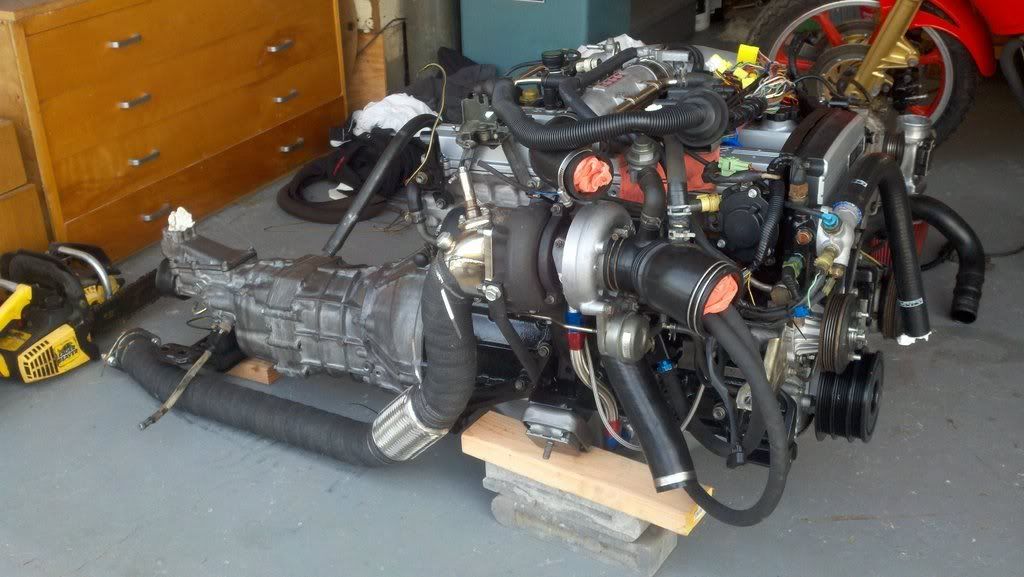

Just wondering if anybody has had success with draining their turbo into the stock oil cooler return location on the pan? Did some searching and some people thought it was too low in the pan, others said it was fine. I am using an NA block for my build, so I won't have the stock drain location available, and don't want to drill it. I on't have the stock cooler, so I the stock cooler return is available, but is it in an appropriate location or am I better off welding a bung in higher up on the pan? Also, this will be with a CT26.
