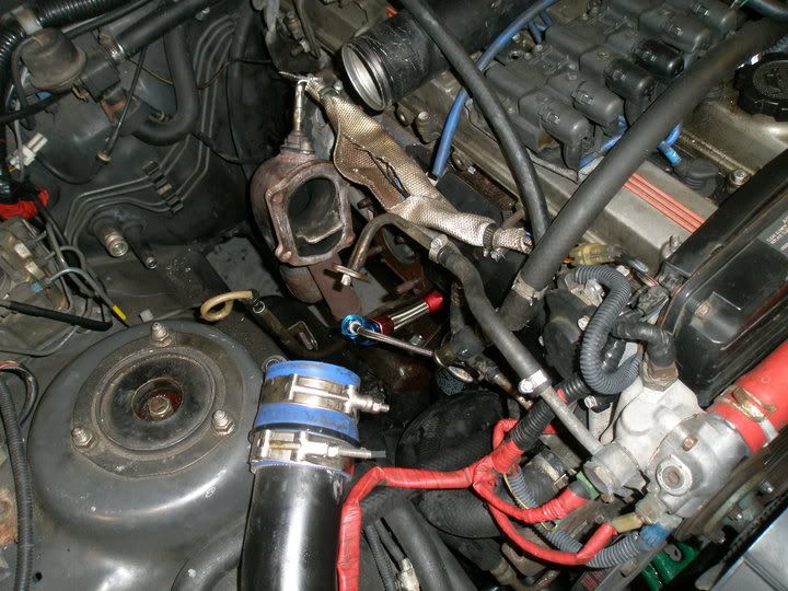

OK So,

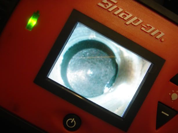

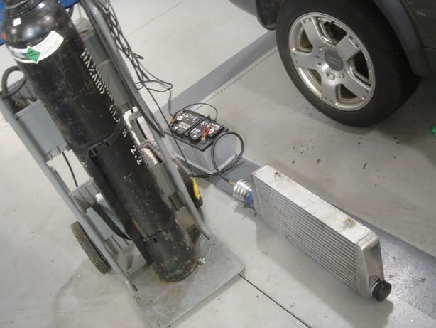

-Removed the old turbo. took it apart some, although i don't know if you can see anything there.
-Removed the charge pipes from the turbo to the intercooler. Found a little bit of turbo debris there.
-Removed the intercooler, tilted towards the hot side, spilled out a bunch of compressor wheel there.
-Shook it out as much as i could. Intercooler was flushed out with water a couple times, then smoke pressure tested afterwards, looks good.
-Looked into the cold side charge pipes, found one small bit down on the lowest point. Blew out with compressed air downstream.
-Checked 3000 pipe, clean.
-Removed Oil return and feed, lined, checked for obstructions, OK
-Looked into ports with boroscope, nothing helpful to see.
-Performed synthetic oil change.
-Checking Oil Pressure.
Removed EFI fuse, cranked about 6 seconds each time, had nothing coming out the oil FEED.,
Reinstalled EFI fuse, had it turn over for a second, as soon as the RPMs bump up, i have full flow(visually) at the oil Feed.
I thought i was supposed to have oil pressure at crank, Am I?
I got the replacement stock turbo, it will go on this week if everything is well.
N/A Bay
Gotta take it apart more?
Oil feed after 2 2second runs
Return port, nothing to see..

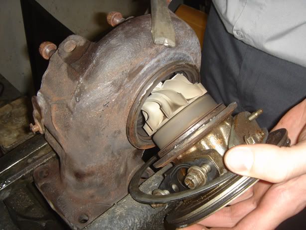

The guy that sold me the car had the turbo on it. It's got like 12K on it, but i don't think i can claim any warranty here.
Do I just take the center nut off? How would i do that with the compressor wheel broken off, hah
MDCmotorsports
SM Expert
4,194
Indy 500
www.MDCmotorsports.com
Take that snap ring off of the little aluminum plate on the front of the bearing housing. Remove the front seal plate. Remove guts. Push turbine shaft out the back of the bearing housing.

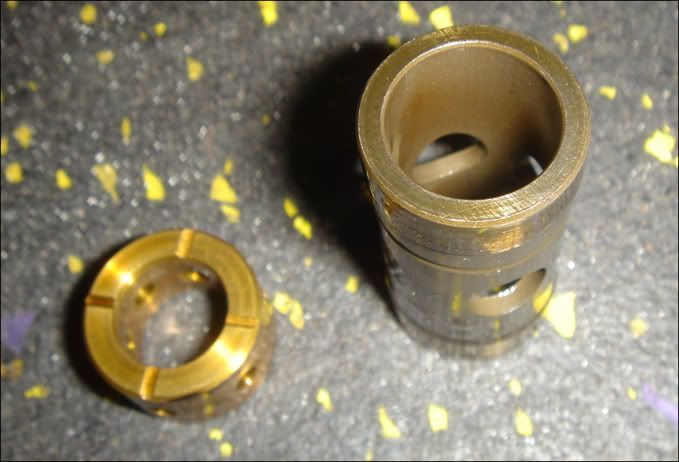

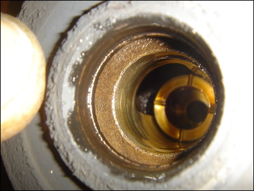

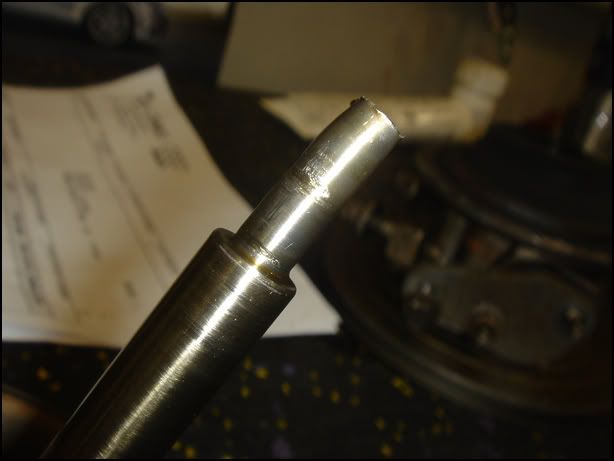

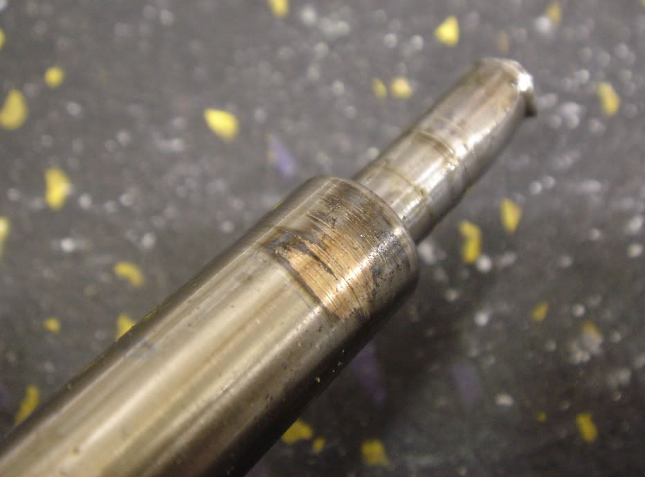

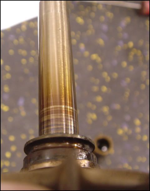

PICTURE UPDATE!
I took the turbo apart and took these pictures a while ago.. i haven't had time for anything lately, so i'm posting it now.
This is what caught my eye. It looks like long term wear. Hmm

theKnifeArtist;1576794 said:
What is FOD damage?
what is a thrust stack?
is it on the lower part of the shaft on picture one?
What do you think about that last picture?
It's a bit like an ATM Machine ;)
FOD= Foreign Object Damage ie: Sucked something into the Compressor or spat out part of the engine into the Turbine Wheel.
The Thrust is usually a Brass looking plate with a machined section in the middle that sets the end play of the Turbo Wheels/shaft.
MDCmotorsports
SM Expert
4,194
Indy 500
Here's what I think happened:
-FOD got sucked into the compressor wheel, or the compressor wheel started coming part
-This caused an out of balance condition, at a high rate of speed
-The speed of the turbine wheel, and the out of balance of the compressor wheel bent the shaft
-The shaft snapped
-Turbo went kaboom
That last picture that you posted? I think its the bearing melting to the out of balance turbine shaft @ 100,000 rpms. :)
The thrust stack should be thrust bearing and thrust collar, under the front seal plate & snap ring. (Would be on the nose of the turbine shaft and under the compressor wheel)
