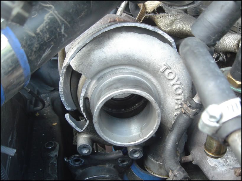

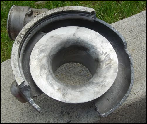

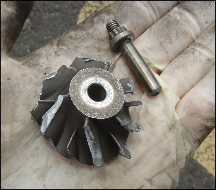

So i warmed up the car for five minutes before pulling onto the highway.
1st gear, moderate throttle, ok, shift.
2nd gear, giving little more than half throttle, probably around 9psi. i hear a faint whine as the turbo spools up.
BOOM.
(57 trim upgraded CT26)
After it blew up, i coasted the to side of the road with a little bit of a rough idle.
I shut it off once i opened the hood and found the problem.
It did start again after that, so im feeling good about the engine being okay.
Im gonna clean out the IC piping and i'll be putting on an extra stock turbo on there for now just to drive it.
So what happened ?
Imbalance?
Oil pressure loss?

WTF........ Thats a big boom for a ct lol.
Was the oil feed line clear?
At least you got nice wall ornament now lol.

That's Nasty!!! From what i can tell you snapped the shaft which put the hole in the casting, did you get bad compression surge / run a better BOV?
I'm running the above mentioned "bolt on" T61, needs new oil lines but everything bolts up nicely.
